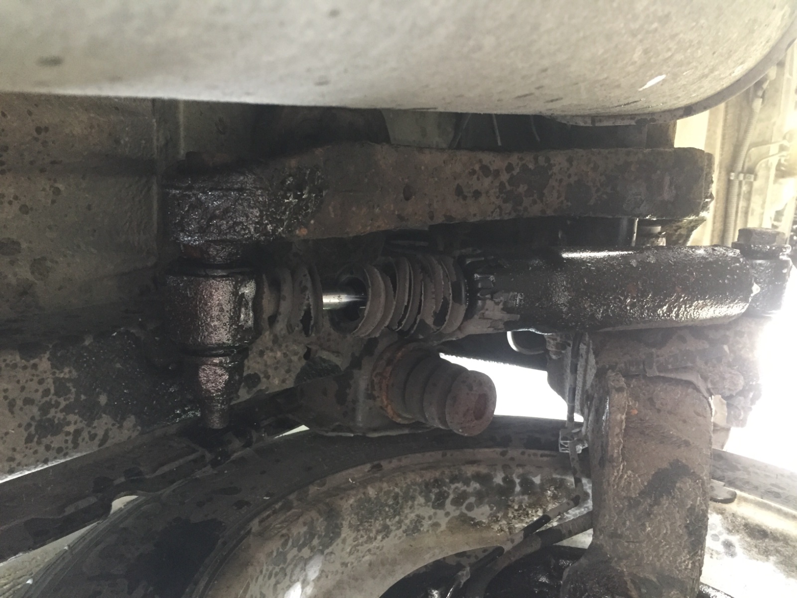

What’s tgis part called and is it easy to fix please

That's the damper / shock absorber. Shouldn't be too hard to change - if you can get the bolts undone. You should really change both to avoid wrecking the handling.

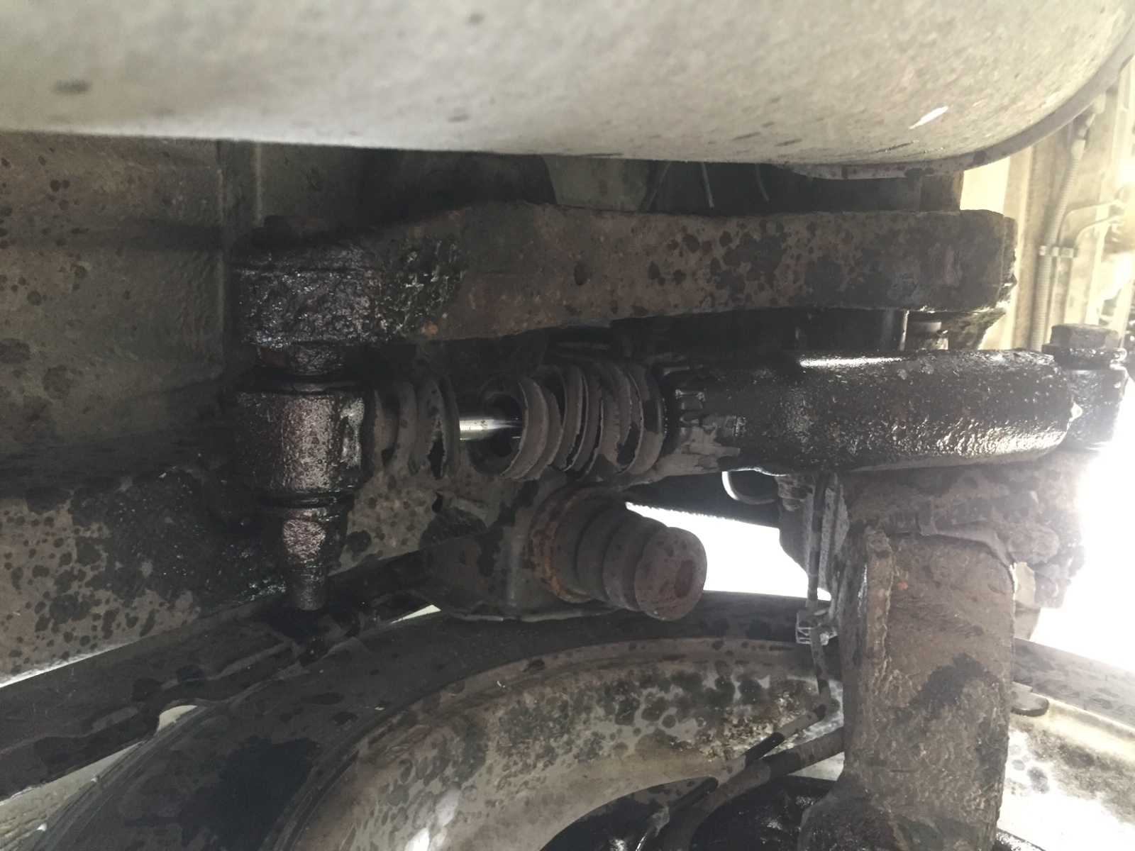

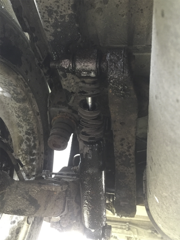

errr... that's your suspension strut and a very sorry one it's looking too! :-D
I've rotated it to make it clearer to see. Easy enough job for a garage to do - but you'll might need a shock absorber compression tool in order to get the damper on.

It's just the damper Marc - these use torsion bars for springs. No special tools, just put a jack under the trailing arm to take the weight when you take the bottom bolt out.

Even better then! :-D They do go on about using some compression tool and a dummy damper to set the height - but as you've obviously done a few of these, that's one less thing to worry about. :wink:
