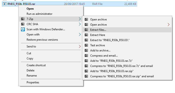

  3. Right Click on the firmware archive. There should be a 7-zip menu, next click '7-Zip' and another menu will drop out (see picture). Choose 'Extract Files'
    (Click to zoom image)
