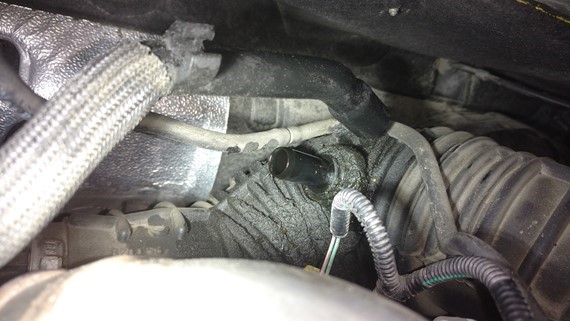

Investigation further up indicates your suggestion about the breather are correct considering the same kind of leak and contamination where the breather hose connects to the air inlet pipe..
Image[/URL
Any further suggestion on how to solve it?
Clean out the breather unit and intercooler and hope it won't happen again for some time.
I have read some suggestions about adding an oil collecting canister or a DIY solution with some hose and a plastic bottle..
Can the leak in the edge of the intercooler be sealed?
Epoxy around the joints?

Well... Breather removed and the only thing not in order I can find is the tube I managed to crack since I was to lasy (and certainly stupid enough) to unclip the turbo outlet air pipe to begin with!
Now glued back on with epoxy and stronger then ever before 😊
So that leaves the assumption this system is not very efficient and needs support. So I will probably get some 14-15mm internall diameter heat n oil resistant hose and look into making a DIY oil collector ..
