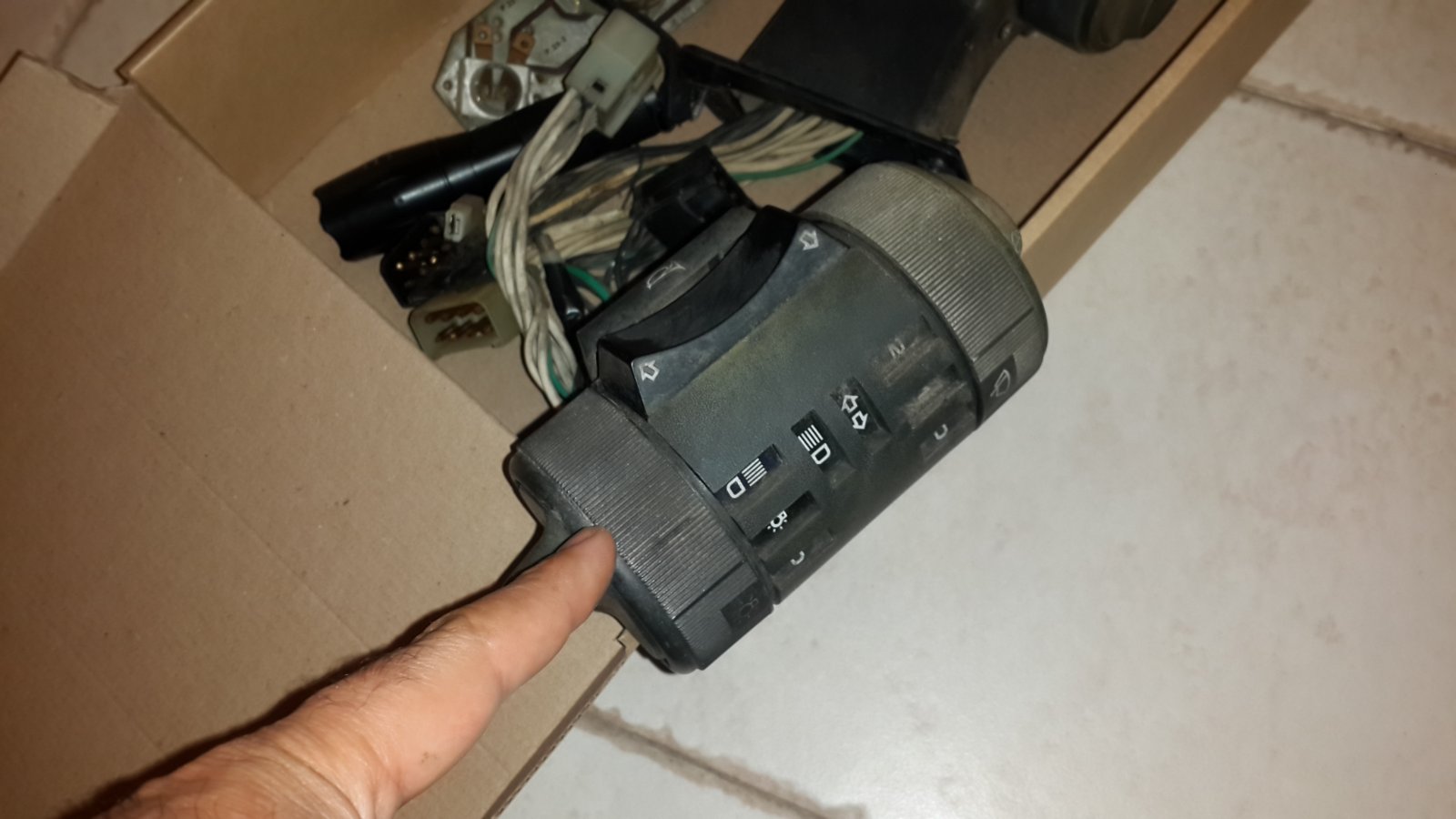

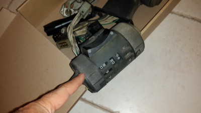

HI,
citroen GSA. left side satellite.
The rear lights are not working. I noticed that the contacts are failed while turning the lower satellite cap.
I tried to figure how to take the cap out but with no success.
Is it can be removed or wether I should replace the whole unit ?

You have to lever out the high/low beam switch. Use a plastic lever so you won't damage it. Then you will see sort of circular spring clip type thing holding the headlight switch barrel in place. be careful not to damage the clip else the fingers lose springiness and the barrel won't stay in its place when you reassemble it. Also, there are pins and springs between the hi/lo switch and the headlight barrel switch, so don't lose them. The windscreen wiper end has the similar setup.
The innards are a bit complicated, so good luck. I took one apart out of curiosity but haven't quite figured out which wires are for what.
