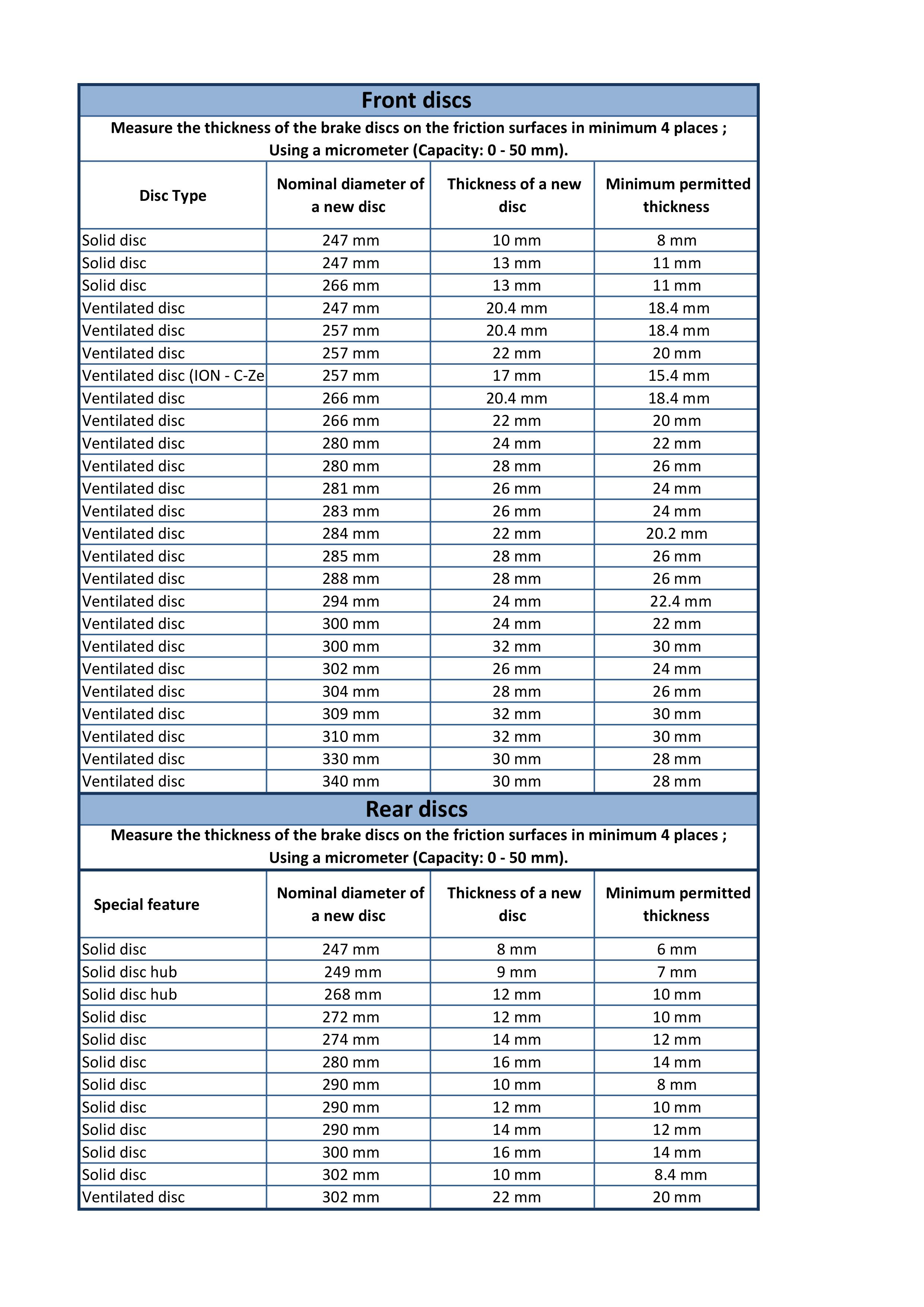

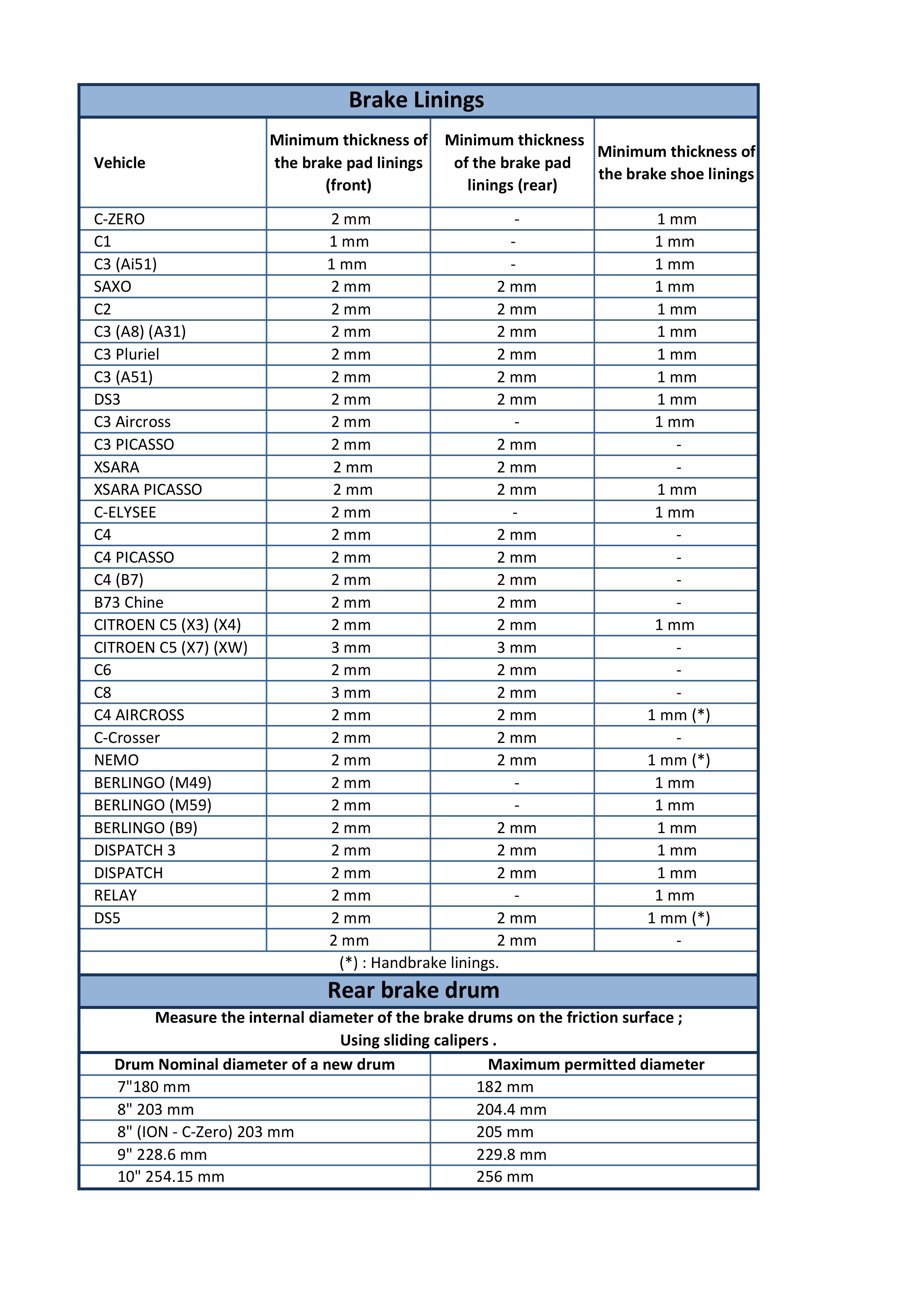

I think this may be of help to some one.
Permissible brake disc assembly run-out on the hub : Less than 0,05 mm.
Click on the attachment to view.
