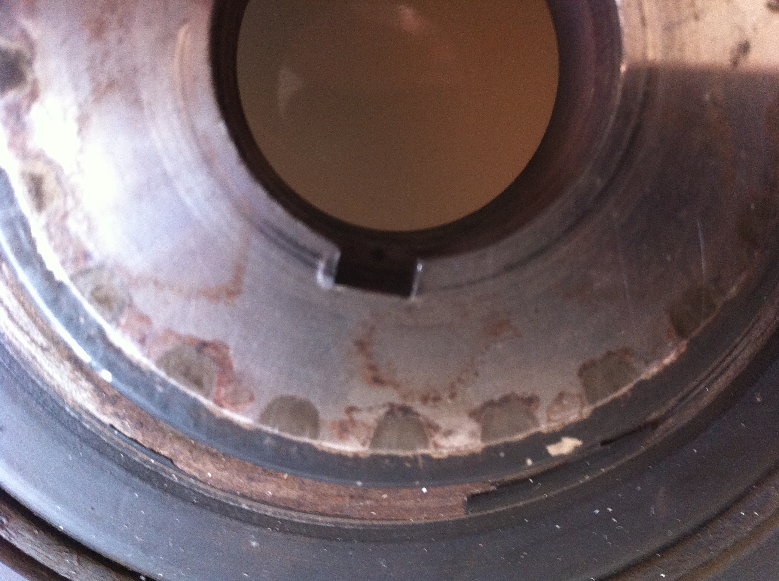

The 1999 2.0 HDi (90,000 miles) started making a knocking noise at tickover. Tried the stethoscope and it seemed to inidicate a vibrating alternator. Consulted a few people and got various suggestions ranging from "scrap it" to "replace the crank pulley". The latter sounded more acceptable, so now the Xantia's on stands in the garage and the crank pulley is here on the desk. But how to know if the pulley is shot? No visible signs of wear. No smell of burned rubber. If I stick it in the vice I can get a bit of movement by hand between the inner and outer parts. But is that enough to explain a loud knocking?

It appears to be sorted.Thanks for all of the replies and suggestions. The quandry was, having established that the noise disappeared when the serpentine belt was removed, which of six pulleys represented the problem? The answer came from considering the sizes of the pulleys. Only the crank pulley would explain an engine-speed knock. The other smaller pulleys would turn faster and be out of synch with the engine speed.
Close examination of the crank pulley showed damage to the key slot (see image).

So was the pulley cracked or was that the only damage? If so, it would suggest to me that the pulley wasn't properly torqued up (perhaps after a cam belt replacement?)
