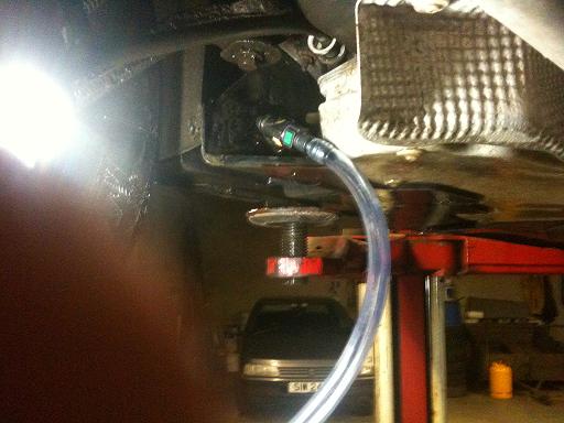

I got the confidence to put infineum DPF fluid in the car yesterday and getting a £300+ quote from main dealer.

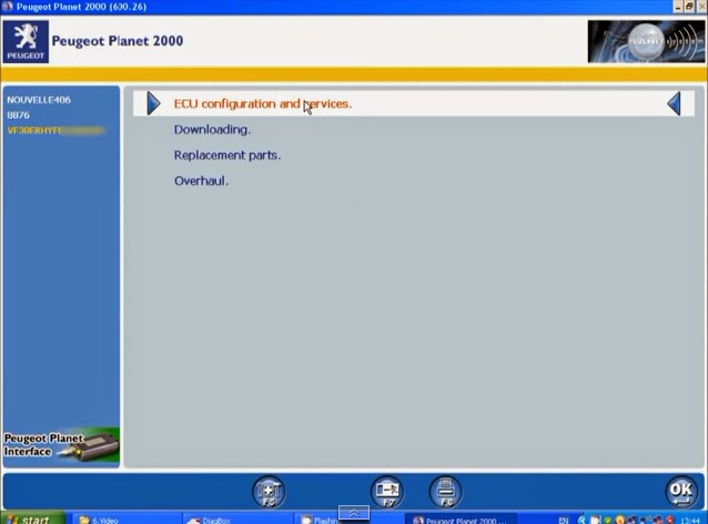

1. Well setup your Peugeot Planet 2000 software, connect lexia3 interface to your car.
2. Select “ECU Configuration and Services”.

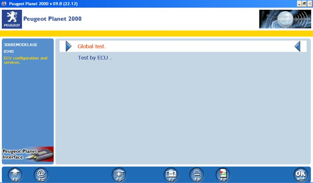

3. Choose “Global Test” and follow system prompts.
4. The diagnostics will take up to 5 minutes to run.

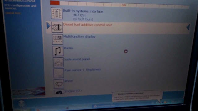

5. Select “Diesel Fuel Additive Control unit”.
6. Select “Configuration.”
