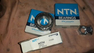

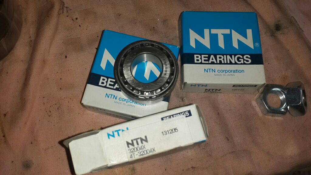

I replaced both sides with new tapper bearings.
The size is as recomended above 20×42×15 and not as appear in the manual.
It is a common size by all manufactures.
The original seal is can not be found any longer and probably produced for citroen only. it should be reuse.
The seal is placed on the outer diameter of the inner ring bearing (if i am not wrong 31mm exactly) and it is different by any manufacturer.
after examine a lot, there is only one that exactly the same with all diameters and the seal can be fitted without any need for unneccery modification.
And the winner is NTN.
Well known Japanies manufacture.
Hope it will assist some of the readers...even one will make me happy
