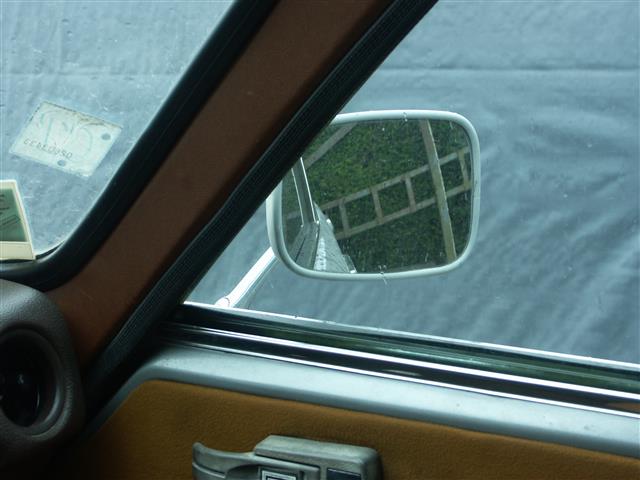

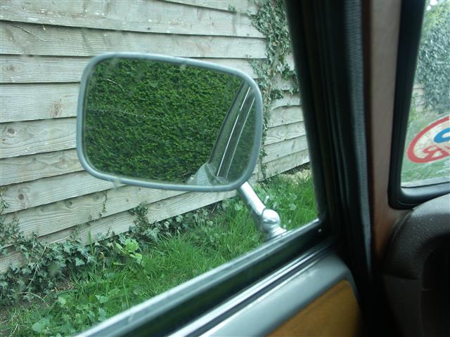

Longer arm? No. Can't find one.
Both mirrors are same length arm. The problem is seen here:
Drivers door (LHD) flat glass:
Passenger door convex glass:
A longer arm would allow the mirror to be in full view without the A pillar intruding. As it is, the mirror just clears the glass.
