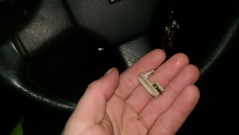

However, it doesn't fit properly, but is doing the job for now. My main concern however is the white clip that goes onto the pedal. On the new cable, one of the retaining tangs is broken, and I don't want it to pop off again. However, I cannot find the clip on it's own...
My plan is, I have heard (on some other citroen type forum, and here I think) that bike gear cable comes in long lengths, perfick for chopping down to size, but I want a new, non broken white clip. My google-fu has let me down so far, does anyone know the official name, part number or a link to get one from? Or does anyone have a stash of them they would be willing to sell to me?

Meanwhile in desperate times, metal meccanno can be your friend to construct links, as long as you think carefully about lock nuts and the like. I have a box of bits from 50+ years ago, but you can buy little starter sets for not lot of money. Its not ideal but if the proper part cannot be found its worth a go.
( I wonder if the original length problem is a LHD/RHD cable difference and someone fitted the wrong thing)

That's a great idea! Didn't think of that. Could the feed the inner through the meccano, construct some L shape bracket to change the angle then bolt that through the pedal top!
May look into that! Thanks

Often these fancy moulded clips are there just to make it fast to assemble in the factory, so as you are not trying to make 1000 a day a substitute is fine.
You will probably find that if you pass the wire through a small washer, something like the sort you use with 1/8 pop rivets, it will hold fine behind a british standard mecanno hole. Maybe 5 holes worth of strip bent into a U with the cable through the middle hole will give you something you can bolt to the pedal. A lot depends on the size of your nipples.
