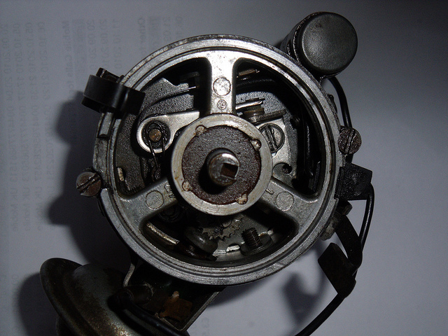

- Posts: 170
- Joined: 08 Jun 2011, 18:09
- x 2
Re: GS 1300 Lumpy idle and running any ideas please.
I think the problem with the Ducellier ignition kits is that unlike Renault stuff with an open area under the cap:
2014-10-03_22-43-28_306 by macplaxton, on Flickr
The one on the GS has a top bearing plate to get in the way of things such as tall hall sensors and beam choppers:
Distributor internals 3 by macplaxton, on Flickr
If you want the "best of both", upgrade a Marchal to electronics and keep the Duc with points in the boot for a quick swapover.
