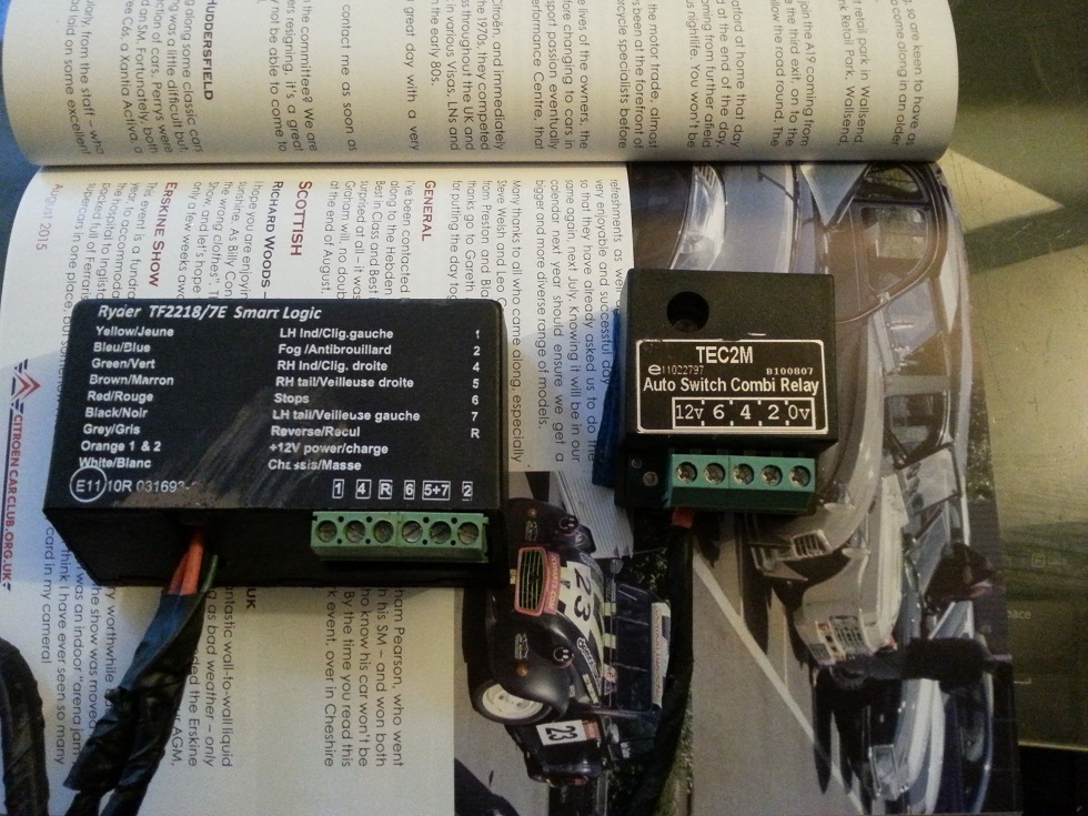

OK....now the wires...
?? Do I need another device to switch off the reversing sensors ?
http://www.rydertowing.co.uk/downloads/ ... ctions.pdf
Is there any point in this relay (NOT a caravanner ? why on a trailer ?)
http://www.towingelectrics.com/relays_caravan.php

I only put the smart box on the Vel. Like you, it was a basic trailer I was towing.
That was CAN BUS too.

What about your parking sensors ?

They were impeded by the towbar and the signals went silly! :lol:
I think it depends on the shape of towbar. My towbar was one where the bumper had to be cut. ie a very basic cheap one.
Some towbars are more forgiving of course, like OE ones probably.

Oh, the horror ... oh, the agony ... :D ... don't worry, hopefully I'll be doing the same to my car next year ... :D ... as for the parking sensors and the tow bar, the "genuine" kit, and some aftermarket ones as well, get linked to the BSI (of course, telecoding is involved) in a way that when the trailer gets connected (not only mechanically, but the socket must be plugged in as well), the car automatically uses the tow-bar mode (BSR I believe, or something like that) ... the reverse sensors get deactivated, and the ABS/ESP behave differently, since the car is now a 2-piece object ... that's why the "genuine" kits are usually pricier (I believe around 250 € for the Citroen part) ... what the actual difference is (why the cheaper ones don't talk with the BSI like the more expensive ones) I never managed to figure out ...
yep, seen that now and b0ll0cks to it as well :)....that is nearly 1/2 a 2nd hand Xantia for some wires and a board/relay.
I will not often tow so when not, I will remove the swan neck/flange if it is picked up by the sensors.

1, The OEM system turns the reversing sensors of by a small optical switch which is triggered when the plug is pushed into the socket, very crude, but effective.
2, I looked at other systems and very few turn off the reversing sensors and tell the car that a trailer is attached, thus changing the ESP and ABS accordingly.
3, I chose the OEM setup so the car knows that my cycle rack is on the back, because if you watch a towbar mounted rack on the back of a car it sways allover the place.
4, lastly - how did you unclip the rear bumper? As I was not brave enough so I fitted my bracket by only removing the lower valance, fiddly but doable.

As I will tow rarely ( I have an estate car after all) I do not see that the sensors being an auto off feature will be to much of a problem so am OK without that feature. All "other" times I will remove the swan-neck from the main bracket as a tow bar will get in the way of loading heavy radiators.
Again, I understand the added benefit of the system linked to the ESP/ALB, but again the "once or twice" a year "risk" (touch wood) is OK by me. IF I decide to use it more by using a trailer for deliveries then I can update the interface.
The bumper ( I found out from removing the front) just needs a flat plastic blade pushed (I used a filler mixer) in, from via the wheel arch to release it, then tug :)
