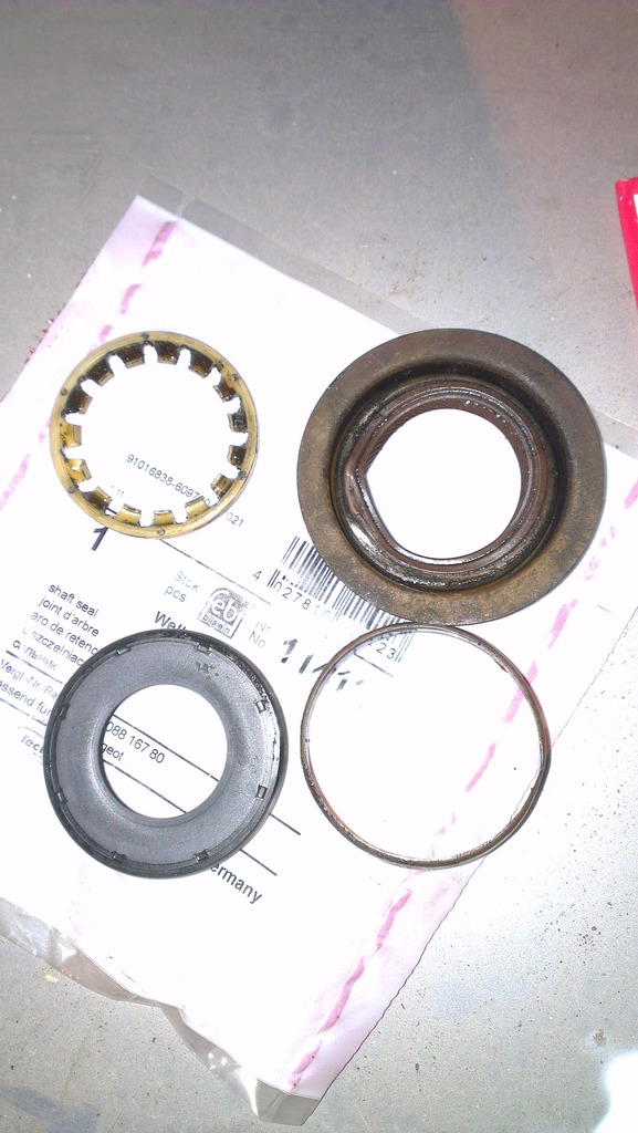

The seal looked different on the outside, because it had an outer captive plastic ring that rotates. I prized this out and then saw what looked like an ordinary oil seal behind, so set about prising that out. Cue satisfying 'pop' :rock:
Oh, hang on... What the hell is this?
Been sent the wrong new seal? #-o
Definitely doesn't fit - too loose in the bore;

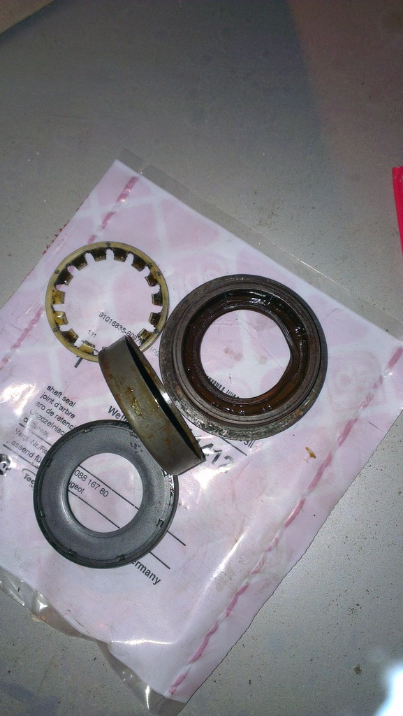

But no, on closer inspection, what had popped out of the end of the box is a small metal insert, which has the seal inside it.
This is it with the plastic ring removed (the white bit)
Looks like there's a normal type oil seal then inside the metal outer insert and it looks like the diameter of that matches the new seal so all should be well and I set about knocking that out.
What then happened was that another metal sleeve (that had been hiding inside the outer metal sleeve) knocked out;
This sleeve is what the plastic ring had been retained in and rotated inside, against the back of the oil seal.
Try as I might (I have knocked the crap out of it with a suitably sized socket, both directions) I can't get the old oil seal to shift in the metal insert AT ALL - you can see in the pics all I've succeeded in doing is bending the inside of the oil seal!
I'm on the verge of pointing a blow torch at the insert to try and expand that and/or burn away the plastic on the old seal.
Before I do that though, I just can't get my head round this design.
Anyone else come across this? Is it 'right'? :?

You have the wrong seal, there are two types. Sorry I can't remember the part number but I think it's the same as the Relay one but don't take my word for it.

Yes it comes as you say all in one piece, I think the Citroen parts list only gives the one you already have, iirc I had to take the old one to the local factors to get a match. My 2001 C5 HDI had the same seal as the one you have but my 2004 C5 has the bigger one
There's a supplier here who seems to have the correct part but I suggest you double check.
The difference seems to be the gearbox, the early one had the reverse position to the right and back, the later one has the reverse to the left and forward. http://www.eurocarcare.net/gearbox/ecc3 ... right.html

Looks like only the BE4R box fitted to 90 BHP HDi engines has the 'older' push in type. All the ML boxes have the one behind the cover plate and the other one with the metal insert. The LH one is the same for both boxes, the RH one for the ML boxes appears to be this one

Some of the seals have the plastic gizmo some dont. Its main function seems to be to centralise the shaft on the way back in. Get a caliper. Measure the diameter in the box. Measure the shaft diameter at the appropriate point. Go to your local bearing supplier and get the seal.
