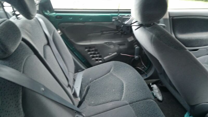

However... this is how it came to us...
Yes, door handle removed, and door catch missing... so it was all tie wrapped shut..
Outer door handle, and door card was all in the car only the actual catch was missing.

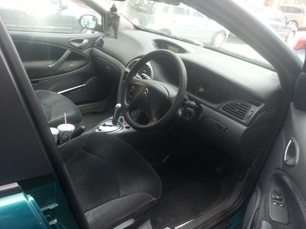

Other things also the Air Con was not working, and the buttons for the auto box sport and snow switch;s were missing.
However, just as a stroke of luck our friend R9JKE (Luke) in ireland was breaking a C5, so a quick message for a door catch, switch buttons and of course a Cruise Control stalk was made and they duely arrived!
Sorted the door, put it all back together that was sorted. Fitted the switch buttons but then found the rubber membrane behind the switchs is missing... and of course fitted the cruise stalk, and switched it on in the ECU.
