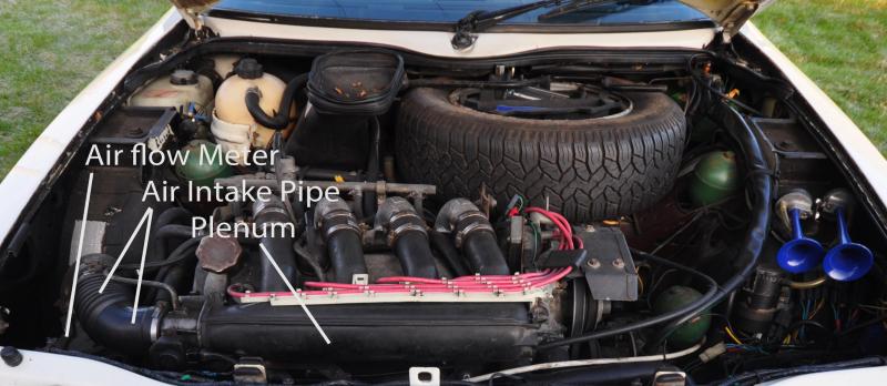

Here's a picture of that 1985 CX 25 Pallas IE under the bonnet - not an ideal shot but that's what I've found at the moment...
As you can see the main intake pipe has indeed got the concertina pipe which can sometimes split.
The larger plastic item to the right (plenum) can sometimes collapse and cause idling issues.
Does yours look "full" like the one above? Sometimes they can completely collapse in.
If you can post pictures then we can see if there's anything immediately obvious that could be causing an issue...

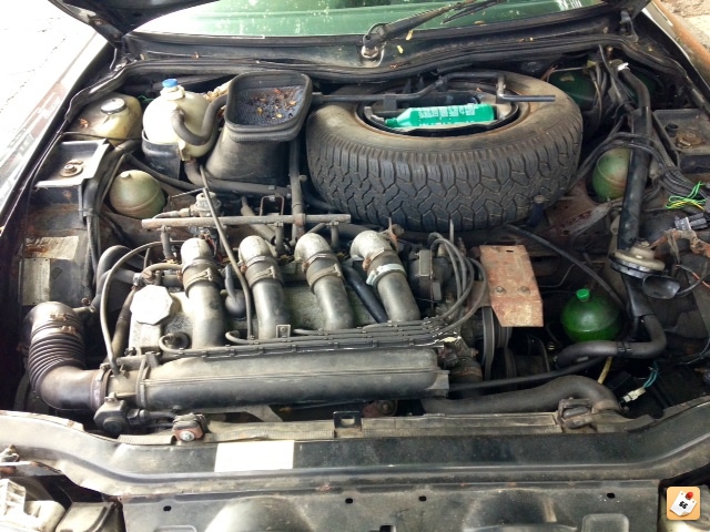

As you can see, plenum is fine. Other air hoses seem ok but I haven't removed them to check.

Indeed that plenum looks a-ok. More pics of the rest of the car are welcome...
