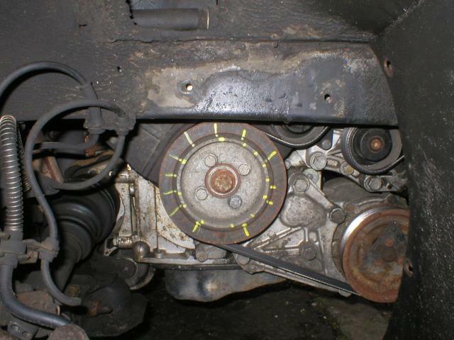

A good way to check the crank pulley is to pait some lines on it and observe if they move relative to each other...
Like this:
If the clicking stays then you will need to suspect there's something going on with the cambelt tensioner or jockey wheels and an inspection therein would be valuable...
