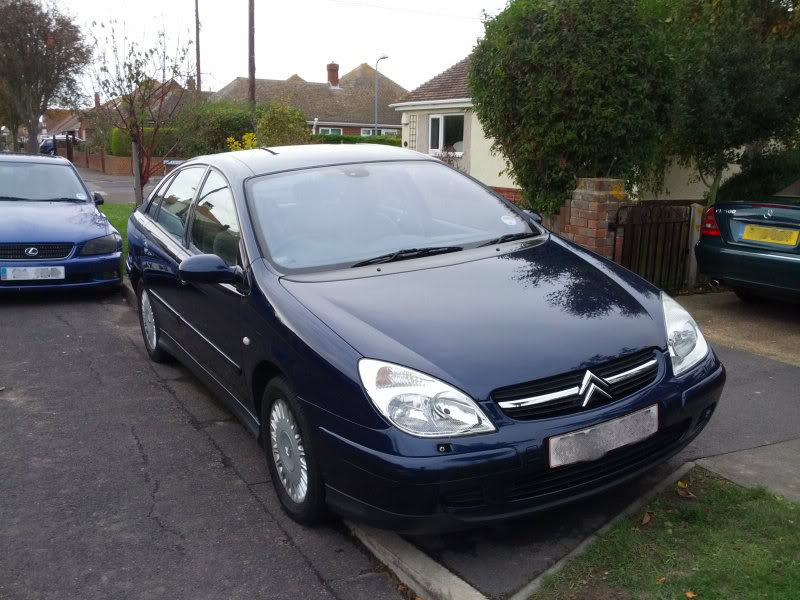

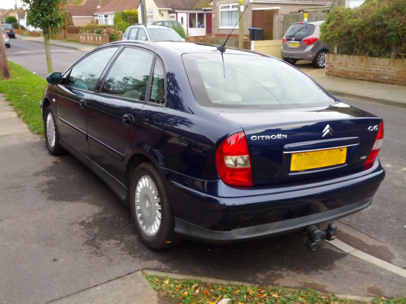

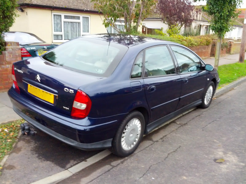

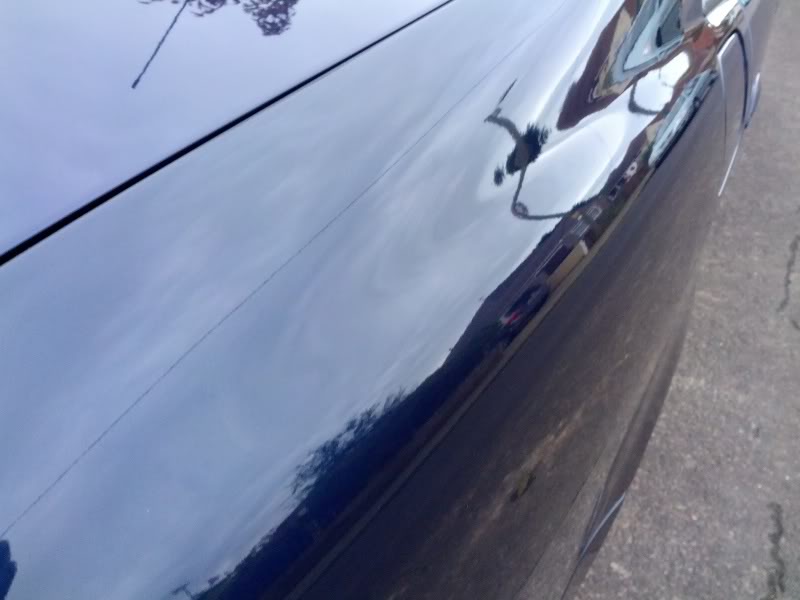

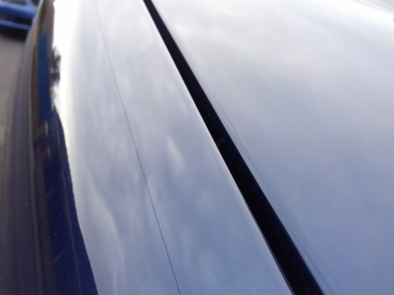

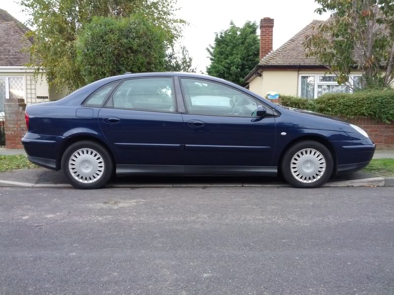

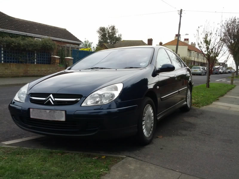

Well what a day... an ideal for polishing as it is not warm nor cold ... eehhmm 7C it is cold enough but not freezing lol and most of all not rained! :D :D
So started at 11:00 new time and finished at 15:30 new time as well lol.
- Pressure Rinse to remove all loose dirt
- Snow foam ...sprayed on and removed more dirt
- Pressure Rinsed snow foam
- Shampoo-ed with nice Nanolex shampoo Pressure rinsed again.
- Clay bar all the car ... it was worth doing it ... loads of grime came out especially the sides.
- Rotary Machine polished... all the car from top to toe lol (The previous owner loved to go down narrow lanes and most of all loved the cheap £5 car wash and automatic car washes!!) The paintwork was dull!!! and full of swirls :(
- Another wash of the car and rinse to remove all the oils.
- And Finally applied a coat of Zaino Z2 ... and now I ran out of time lol as it started getting dump.
Here are some final results pics ... I have not touched the alloys or the plastics yet ... they have to be done another day :(

Excellent stuff 8-) I do like a C5 in Mauritius Blue :-D
Looks like you went a bit too mad on cleaning the number plates though :lol:

Lol I know I was not expecting to smudge up ... I did not think it mattered if I used acid.. well apparently it does lol LOL

superloopy wrote:Looks good .... should do after all that pressure washing! Can i ask did you iron-x at all before the claying?
Irox X for the wheels? I did not touch them.
I used Bilt Hamber as the foam prewash
Then as shampoo I used Nanolex Reactivating Shampoo (washed with a Mit)... although I was very tempted to use fairy liquid and do the clay bar easier job ... lol
And then as clay bar I used a bar from Meguiars
Used a 2000 grit wet/dry sand paper where needed to remove some surface scratches easier and some blemises ... it also had two white paint stains on the driver side panels ... it was from an impact of some sort but but it was light and no panel damage was there, all these were removed.
Machine polished with Scholl Concepts S17+ High Performance Compound and a Scholl medium pad.
And then used one coat only of Zaino Z2 Pro ... ideally I wanted to do 2-3 coats :( but no time
I did pressure wash the engine bay day before yesterday too lol ... I know it says in the manual DO NOT!!! But I could not resist!! lol
