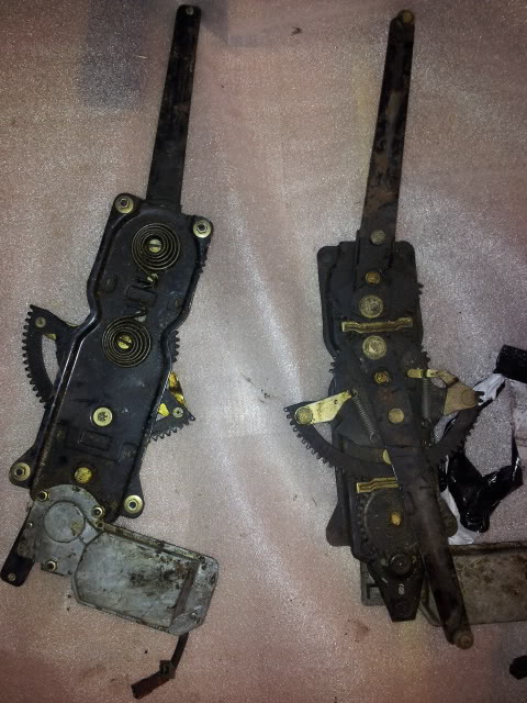

Could any of you knowledgeable Cx'ers identify wheather these are the window regulators I hope they are?
Im hoping that they are saloon rears but am not sure!

After extensive research I have a feeling that these are s1 fronts :(

I pretty sure s1, s2 are the same but going by pic can't say whether front or back.
Look to be in good knick.

Memory now it's come back :( front and rear same Saloon, Safari, Prestige :o

The metal motors are definitely s1 as later kit was nasty PSA corners-cut plastic crap.
The ones pictured look too substantial to be rears so fronts seems favourite. I'll see
if I can dig out some for a better reference.

David, when you say front and rear the same, do you mean that rears would be the same between saloon and estate?
My dad has a safari that I have just downgraded from electric mirrors to manual, perhaps I could do the same for the rear windows if they are the same!

I'm sure I put a front saloon in the rear of my Safari, I'm almost certain they are the same all round.
I down graded mirrors on Safari also, I prefer manual and I think the adjuster nob is cool, especially when passengers try to open door with it.
Also a tip for window that drops a little at the front, raise the the little runner in the middle of the door a tad.

Ill have to see if the mechanism fits then, I do like it when people think they can get out using the mirror adjuster but I downgraded my dads safari so I could upgrade mine!
The Gti leather interior I have going in it doesnt have the cut outs for manual mirrors and I dont fancy cutting them in after how much I paid for it!
