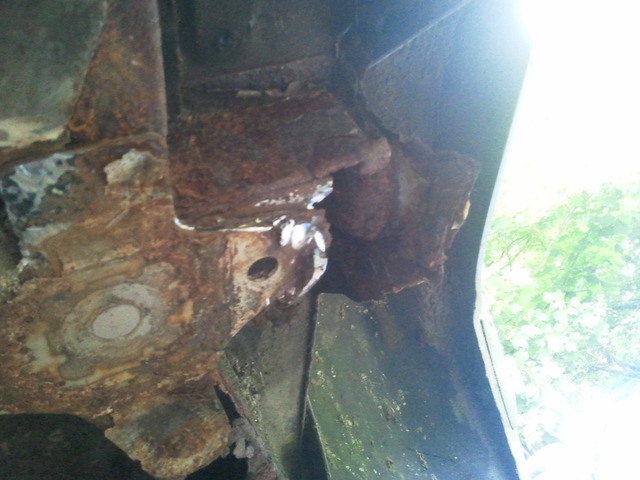

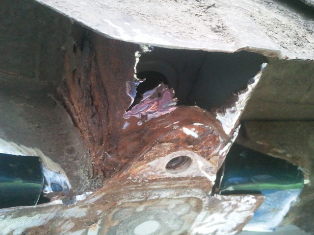

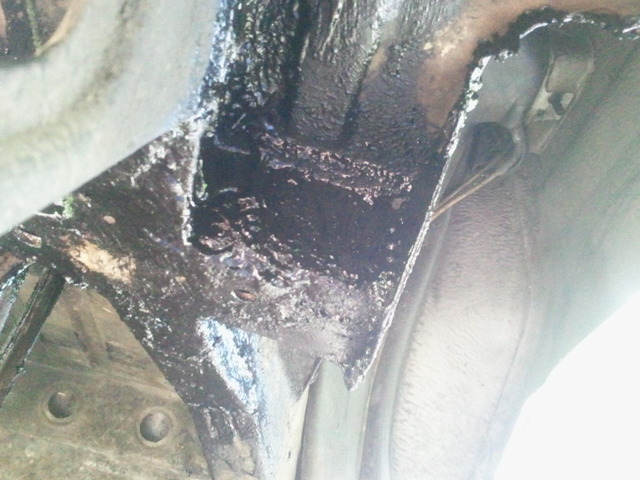

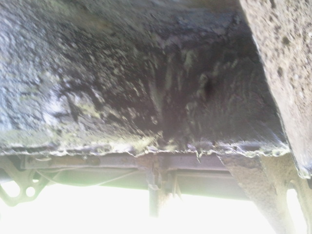

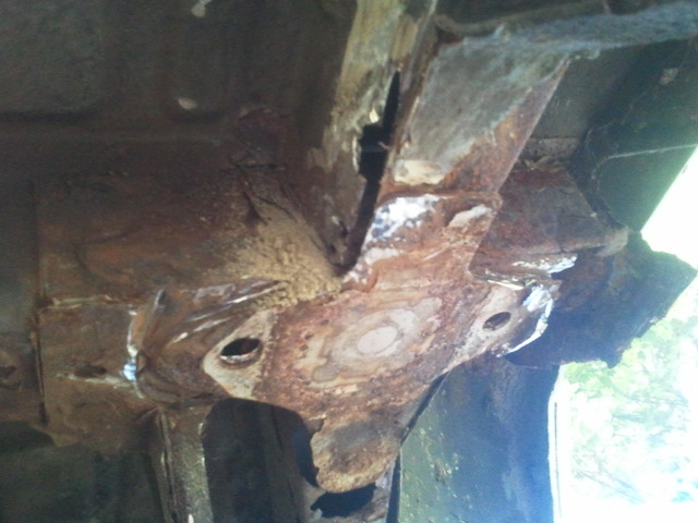

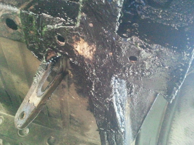

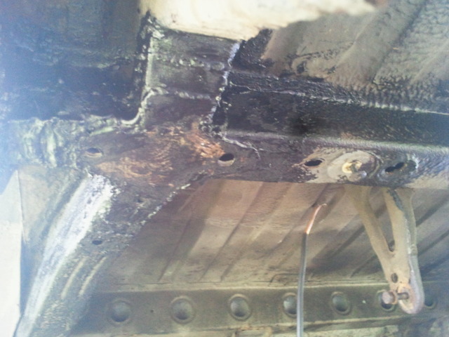

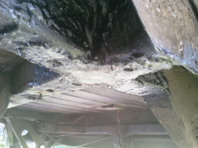

So the latest work entailed the following repairs:
Offside Rear mount area:
Nearside Rear Mount Area:

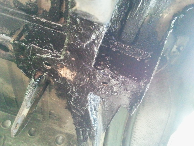

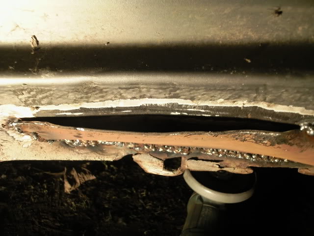

So, after a fair few days of cutting shaping, welding, cutting etc etc... the Near side ended up like this:

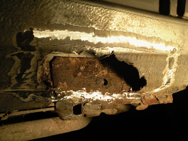

And the Off side, which I also had t rebuild the side panel part, ended up like this:

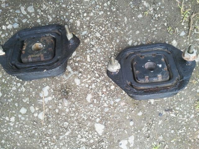

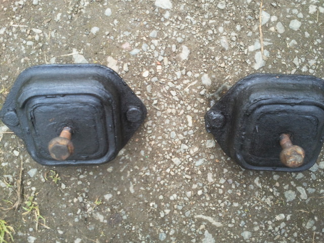

All sorted, in the mean time the subframe mounts them selfs also looked a bit iff, so while they did look like this:

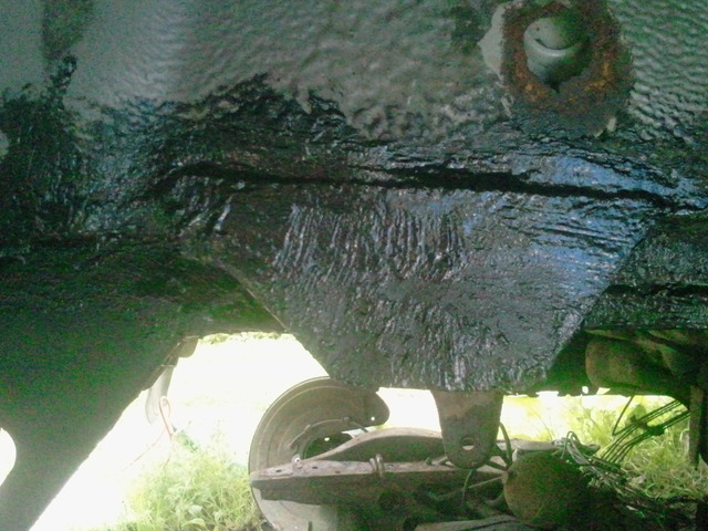

I got them cleaned up and also under sealed...
All looking very well solid and nice now its all back together and the exhaust fitted...
I now have one more hole to contend to in the floor just inside the inner sill... which is the next job.

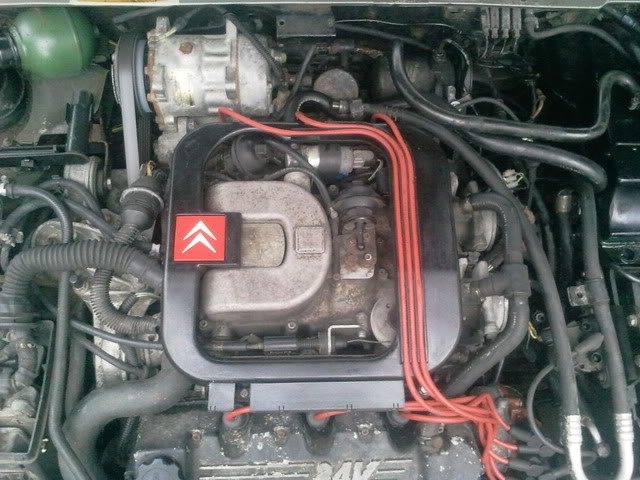

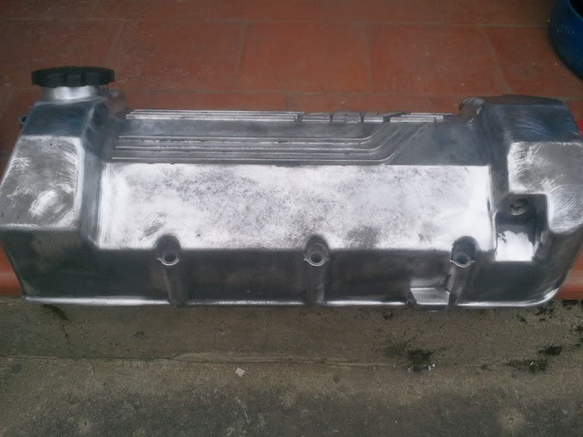

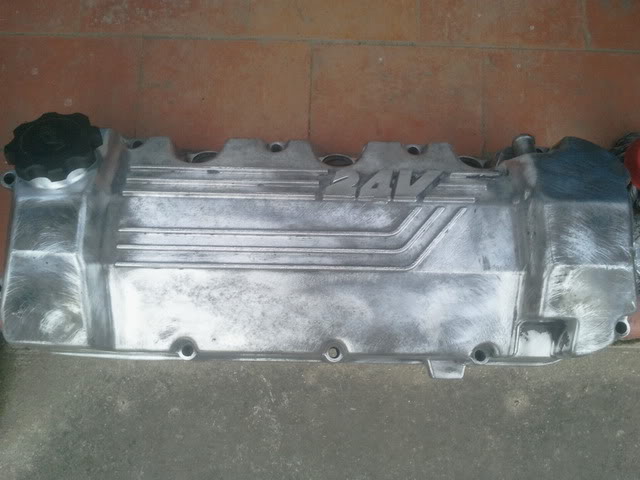

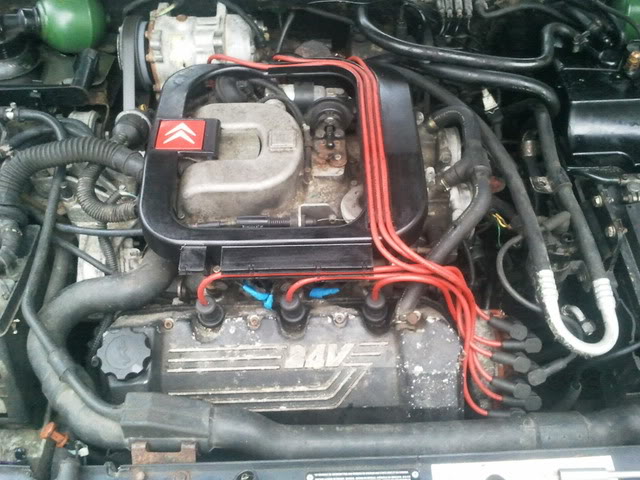

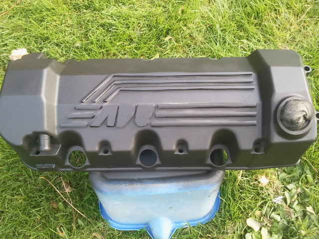

Other jobs Ive had done before the rear end welding...
Rocker cover all cleaned up ready to fit, Ive also had the engine "Cover" repaird and painted, and the red HT leads cleaned up and re fitted..
Yes, I know, Ive not fitted the rocker cover yet! I dont want it to suffer engine heat to much so to bilter before I come to CXM...
