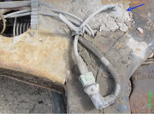

Lighty wrote:Sometimes easier to take the rear arm bolt out and drop the arm a little, not a nice job on your drive.
Exactly that's the correct way to do it but it's difficult as you have also said.
Try feeding the ABS cable from below to upwards with a metal wire guidance.
Difficult to explain but may be these pictures will help you to see what I mean :wink:
This one I have already sent earlier:
This pic shows the top of the rear subframe where the ABS sensor cable comes out and that location is
marked by the arrow. Normally you'll not be able to see this location and hope this pic will be helpful.
This shows the rear and right side (fuel filler cap side). Top of the pic pointing the front part of the car.

Re: ABS warning light/sensors/ECU/wiring problems
That's good to hear - but just for the benefit of member: PJS956 - a Lexia / Diagbox won't help him as he has a Renault and it's not compatible. He'll need something like Renault Clip for a decent diagnostic tool, but depends on what he wants to do. A generic code reader will have varying capabilities depending on each one and of course quality, compatibility and price.
