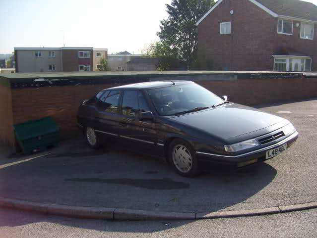

Hi' its a 2.0 turbo petrol, auto Prestige xm. from feb 1994, so it has the early dash and steering wheel, which i think looks cooler.

Citroenmad wrote:Welcome to the FCF :D
Is your Prestige a 2.0 TCT? Manual or auto? They are a rare car now.
Some pictures of your Prestige would be nice ... 8-)
Added some pictures above, :wink:
Posts: 52781
x 7241
Re: Bonjour' XM PRESTIGE
Very nice, very cool :P
I'd rather have the XM rather than the other car, whatever it is, in the second picture... It looks positively dowdy against the beauty of the XM...
