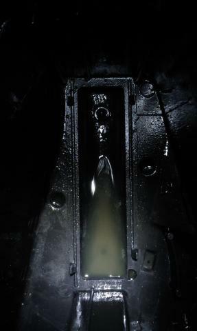

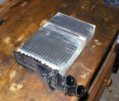

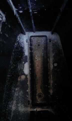

Here's some pictures of a leaky matrix and the state of some heater boxes that had been home to leaky matrixes...
The last one shows dried crystals of anti-feeeze in the bottom whilst the middle shows wet coolant.
