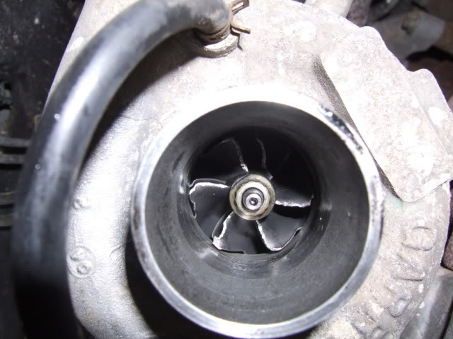

Anyone want to hazard a guess as to whats happened here?

Looks like the bearings or shaft have failed making the blades come into contact with the housing?....

looks like something made its way down the inlet to meet the compressor, it does also look like the comp wheel is off centre like the shaft is bent or its got a very very shot bearing.

May look off centre due to the angle of the picture. Its still on the van.... yes its my Transit, whose turbo decided to fail yesterday by making a police siren noise. Nothing else, no oil burning or power loss although this may have a been gradual.
£400 quid later i now have a turbo that looks like this -
(thumbnail!)
Its a brand new Garrett GT20, from Ford it would be nearly 800 squids...

Something definately got into your turbo though as i cant see a turbo just failing like that on its own :(

I got it from ebay, from a guy that bought a job lot of stuff turbos included he had 2 left... A recon will be as good and this could be done for about 250-300. If my Activa ever needs doing i'm having a bigger wheel put in.
The van is all sorted now, and its more responsive and torquey, and quieter!

Looks like its sucked something in :shock: Was there any play in the shaft...

Brigsygtt wrote:Looks like its sucked something in :shock: Was there any play in the shaft...
None at all! Just the compressor wheel is fubar.
