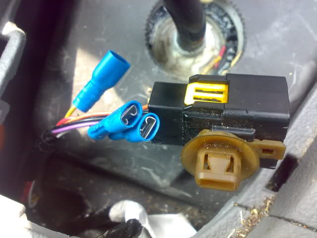

It looks like the phone kit itself was removed at sometime, the speaker is present (left of the steering column, same one used for the woman that nags on the privilage models)and there is a yellow plug under the gear stick gaitor, this has had three wires cut from the plug and female spades attached to them?

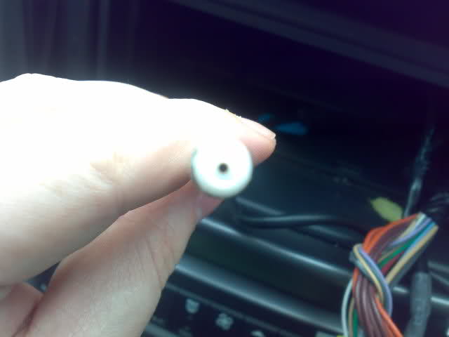

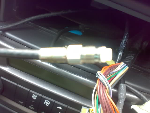

Found the end of the cable in the dash behind the radio, it has a screw type fit on it.

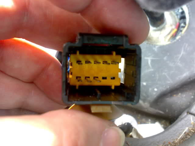

Also found this plug under the gear gaitor, any ideas? The femle spades are connected to wires cut from the plug.
The car was fitted with a Renault car kit so I'm trying to establish what is and isn't there, the speaker is the two pole and has a whilt plug attached to it.
