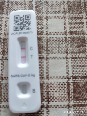

Just done a test explains the dose

How to you read those things? What does the 'T' and the 'C' signify.

The two lines mean you have it. The other ones on their own don't matter. My brother asked me the same thing Fortunately I don't have that trim level so I am safe on that front .

If the test is done correctly the C line will show. If the T line also shows (no matter how feint) as well as the C line it is a positive result for covid.
