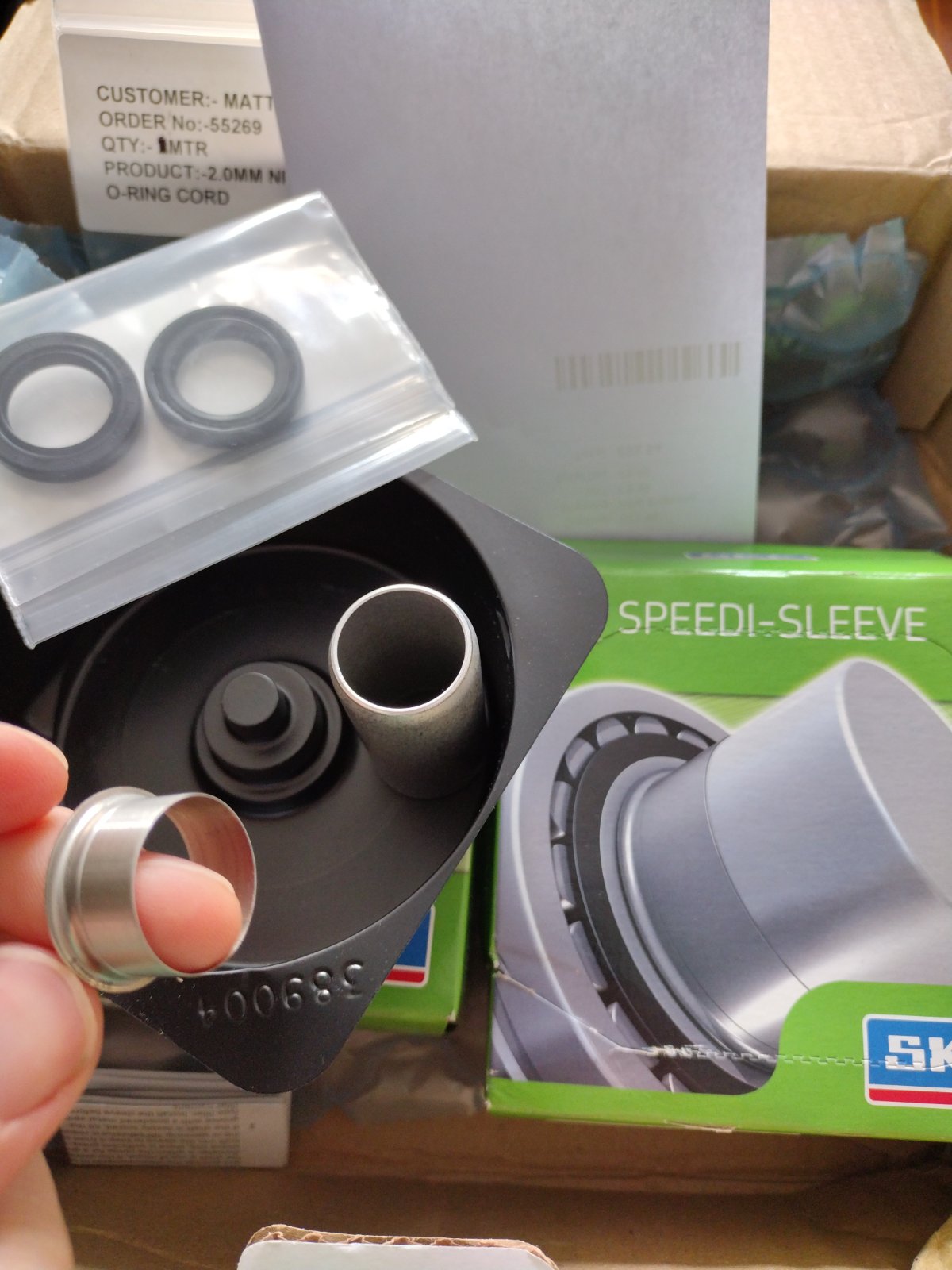

Oh, my box of goodies has arrived! :)

Darbuck is going to beat me at current rate, my rack is ok at present, I just worry enough about it to start accumulating bits "just in case"
Having said that, if I spot a rack cheap enough (and that free one went quick! But also a bit far away too) then I will likely attempt the project ahead of needing it.
I've bought a couple of the speedi sleeves (and four of the R23 type lip seals) mostly so I am not stuck if failed at first attempt at a fix.
Rest assured though, when I progress it, it'll be on here for all to enjoy (whether works or not!) :)
