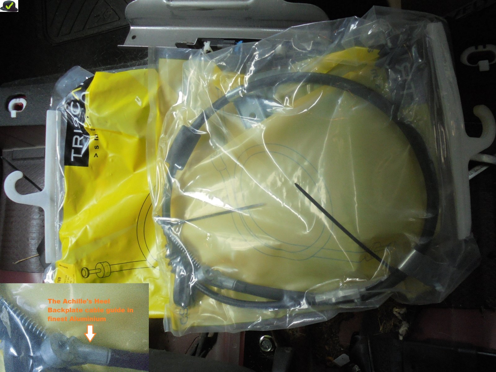

Cleevely have got the Falcon Business and while not having investigated whether the nearside parking brake cable is needed I have gone ahead and just ordered both nearside and offside cables. Even if the nearside is not strictly needed at the moment, it will be shortly!
The offside one is functional and not beyond the possibility of bodging a makeshift back-plate cable entry clamp, but far better to have a new cable altogether now that one has been sourced at not too outrageous a price.

Wise move by the Falcon there...the nearside is strictly needed right now. Exactly the same as the offside, perfectly serviceable cable seized rock solid to the backplate aluminium cable guide with with corrosion.NewcastleFalcon wrote: 08 Sep 2023, 10:32 Cleevely have got the Falcon Business and while not having investigated whether the nearside parking brake cable is needed I have gone ahead and just ordered both nearside and offside cables. Even if the nearside is not strictly needed at the moment, it will be shortly!

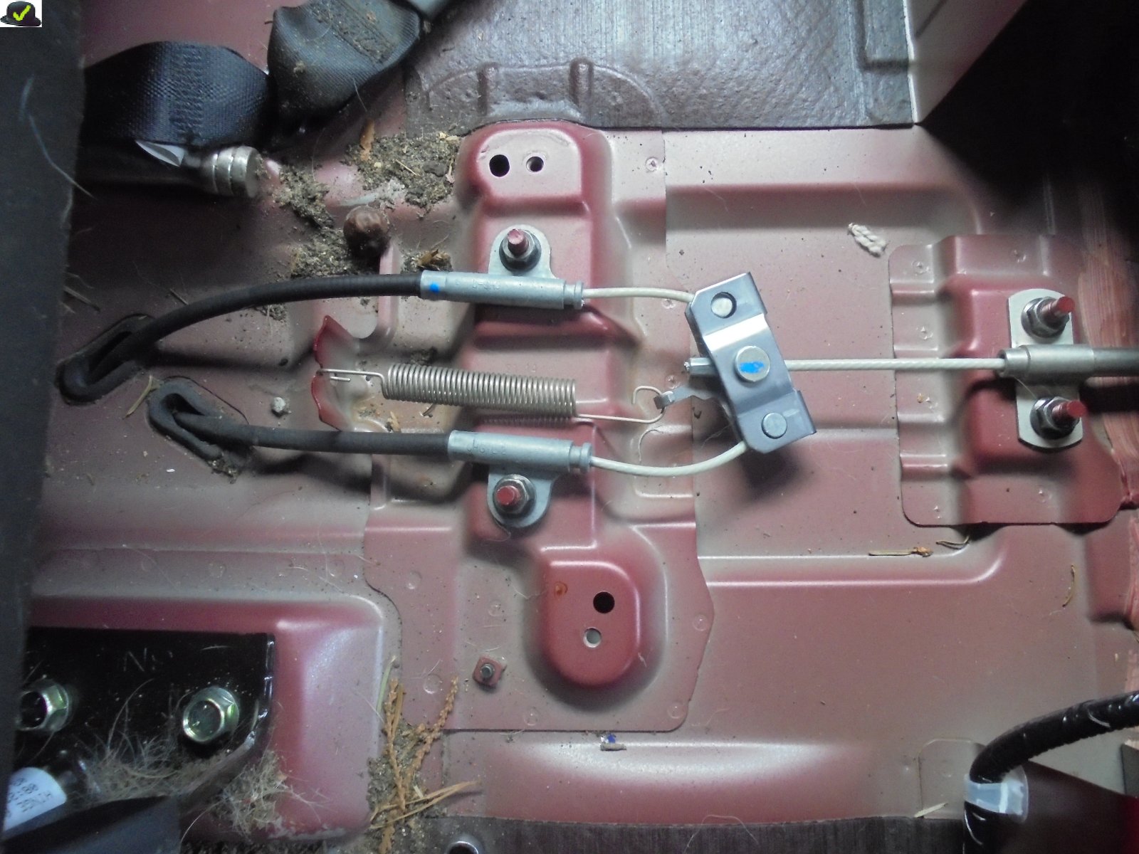

The "interior disassembly" amounts to pulling up on the rear seat squab. The rear seat squab just requires a decent forceful yank upwards, not attached by any screws front or back, and removal reveals this picture...
Undo four bolts to remove the cover plate under which is the handbrake cable joint between the single cable to the front and the two rears - one to each wheel.

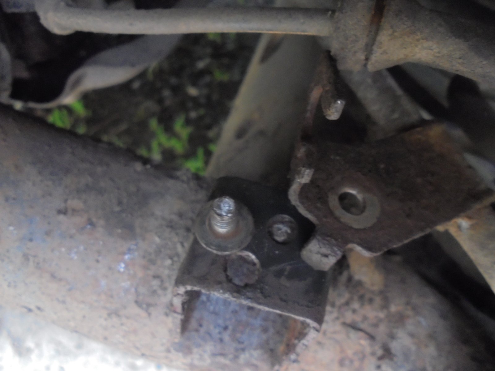

Under the car there are a couple of cable mounting points...here's the first and an associated rhetorical question. "What happens when a 10mm head, small diameter shank, threaded bolt, exposed to all sorts of corrosive salt muck and damp, which has never been undone for 8 years is attempted to be undone

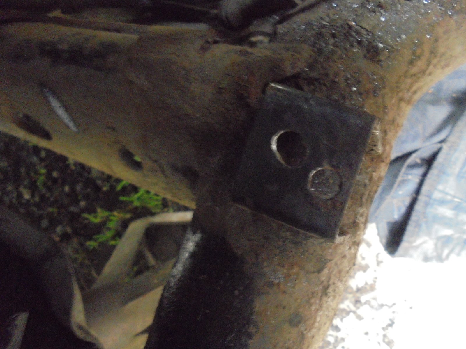

How many drill bits capable of drilling out that bolt were in the Falcon toolbox...none. Time to bother the agricultural engineering fraternity with my usual MOT time trivial requests and emerged with a single hacksaw blade, a single drill, two bolts and two self locking nuts to match, for under £5.
Job done The other mounting is in one of those awkward places not a comfortable arms reach towards the centre of the car and a lot of stuff conspiring to be in the way, and considerably rusted up but this time it was a 13mm nut on a stud and came undone OK.
Nearside Cable is out....exactly the same problem as the other side, seized in the corrosion of the aluminium cable entry bracket.
