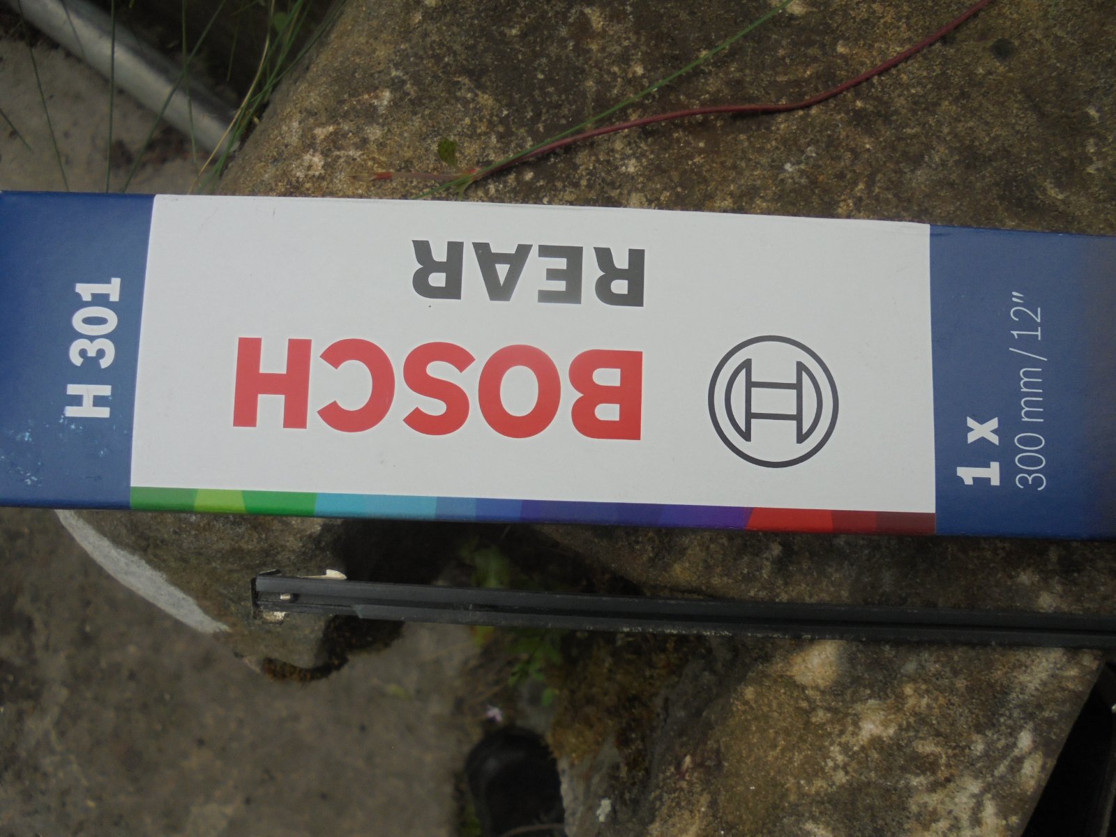

Gave the Bargain Basement Micra a bit of a treat today...new wipers back and front. This 2-pack front, and the rear one were surprising good value at about £20 from Halfords.
Falcon Original<br />Bosch via Halfords

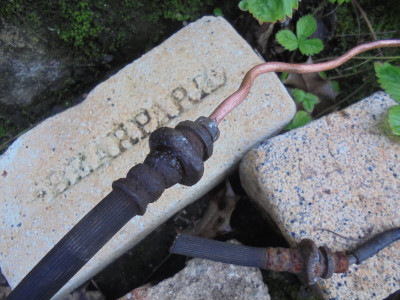

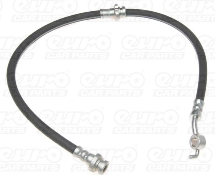

Last MOT I did the flexible brake hose at the RH front, its a double length thing with a silly little hook thing and a banjo fitting at the caliper end. To pre-empt a possible failure and it does no harm to present a bit of newnesss, I intend to replace the LH one. Went to my usual source of unbeatable prices the much maligned Eurocarparts and even cheaper for the same stuff sidekick Carparts4less, only to find things have changed. Overpriced at Eurocarparts at £32 ish and the same price with none of the usual additional discount through Carparts4less. GSF have it too but same sort of price £32.51 (after discount so they aren't any better)
I may have to take my bargain basement pound somewhere else. :-D Quick look at the net and without trying many options for the right hose at £20 and less inc new Quinton Hazell branded, and free postage. Just looked back, and the RH one as below was £30 last year :-D. I must have grown more bargain basement than last year being shocked into looking for something cheaper :-D
Last years part
NewcastleFalcon wrote: 01 Aug 2022, 20:25 Doing some more shopping at carparts4less. Flexible brake hose to sort the rusted ferrules. Micra's is like this at the front
£30 after discount at ECP, check every time but there is an Extra £6 discount if you order through Carparts4less
and you can collect it from ECP, which I have chosen to do this time to save wasting a day or 2 hanging around for delivery which would be free and which I would normally use. So far I have had none of the woes of others sometimes expressed on here quite the opposite. I find they are unbeatable on price and well suited to this BB motorist :-D They obviously both have a sale on all the time and both have discount codes to use to get the cheapest price. (things appear to have changed! 2023)

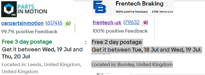

Partsinmotion on e-bay have had a few mentions on here in the past, generally positive, and they have a Bosch branded LH front Brake Hose for the 2005 Micra K12 1.0 at £19.82 with free postage. Referenced up nicely with the Nissan Original Part no 462109U01A.
Partsinmotion
https://www.ebay.co.uk/itm/235006608455 ... %3A2047675

Thanks for the additionals Matt, looks like the bargain basement route to go for that single hose is e-bay with partsinmotion looking as good as any.
Posts: 26252
x 7084
Re: Bargain Basement Motoring
Looks like its Leeds, and Burnley who have won the Falcon pound for the hose, and the clips respectively.

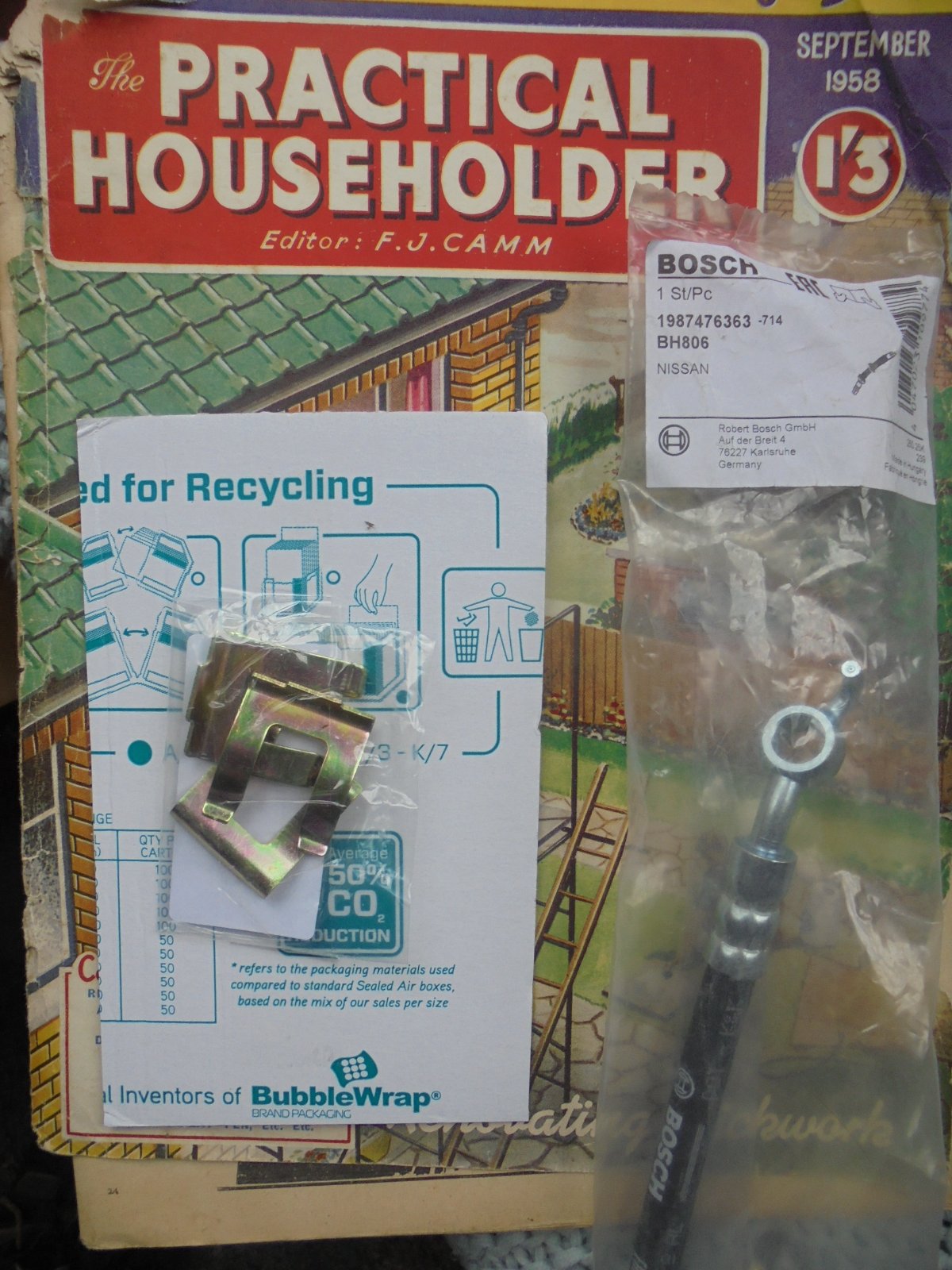

NewcastleFalcon wrote: 16 Jul 2023, 12:43 Looks like its Leeds, and Burnley who have won the Falcon pound for the hose, and the clips respectively.
..and Leeds and Burnley have come up with the goods today
Falcon Original
Falcon Original

Thought I had better make a start and fit my new parts. Simple job...undo a metal brake pipe to flexible hose union, and a banjo bolt at the calliper end. Remove old hose, fit new one.
I have the appropriate hex brake spanner and unlike last years struggles...there was a cunifer pipe and decent hex on the union nut. Promising. Fascinating trivia the cunifer name comes from ( copper, nickel and Iron (yes the fer bit)).
Same story as last year as it turned out. The join between the metal pipe and the flexible hose would just not undo. Sorted it by making a new pipe with new ends going from the ABS block to the flexible hose.
You know what I should have ordered...new banjo bolts and copper washers. Never come with the flex hose and where do you get them from...the internet only I am guessing. Had to nip it up tighter than I felt was right to dry up the drip. That's enough prose...like to keep things visual...
Falcon Original<br />The Undoable Nuts 2023 and 2022
Falcon Original

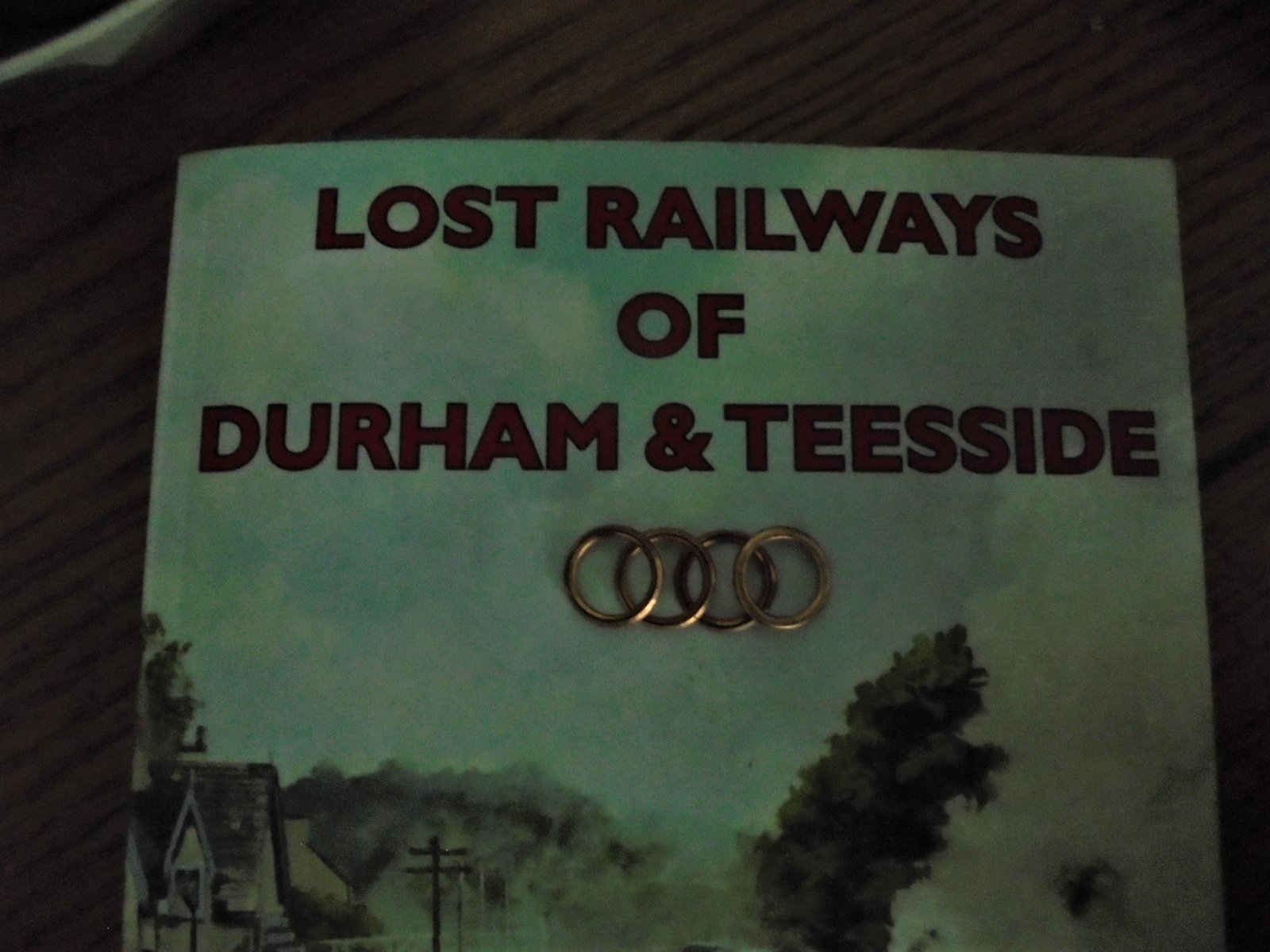

Another 40p spent on the BB Micra's MOT. What are agricultural engineers workshops renowned for :?: A treasure trove of of useful little bits and pieces in many nooks and crannies for bargain basement fixing purposes. Bet everyone knows this, but I just found out, a crush copper washer is different from an ordinary copper washer. :-D Yes the torque for that banjo bolt is only 18 Nm, and with the new crush washers installed the drip stopped pretty much straight away, no overtightening required.
Falcon Original<br />Audi Badge recreated in Crush Washers
Falcon Original
