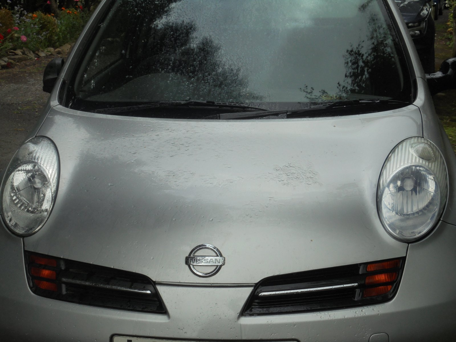

With the absence of windolene in chez nous, and me reluctant to turn into a windolene buyer I think thats it for the wet and drying of the headlights from 240/400/800/1200/1500/2000/2500. They look considerably better than most Micra's of that vintage on the road, and a quick application of WD40 just before the test should have them looking clear enough fingers crossed :-D
after the 2500 grit
after the 2500 grit

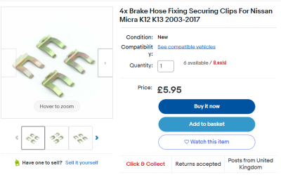

The next thing I need to look into getting is a few of those flexible brake hose retaining metal clips. Get rid of the unsightly cable ties currently used for the purpose, because a few went walkabout.

Glad that's worked out ok for you Neil, A pass without a doubt!! :-D

If it does gets a pass, it would be thanks to the abridged Mick Method (-the 3000 grit and - the Windolene)!

You do realise that if it doesn't pass I'll claim it's because you skipped the most important bit don't you? :-D

Surprising how expensive, for those with a bargain basement mentality, little bits of tat are.

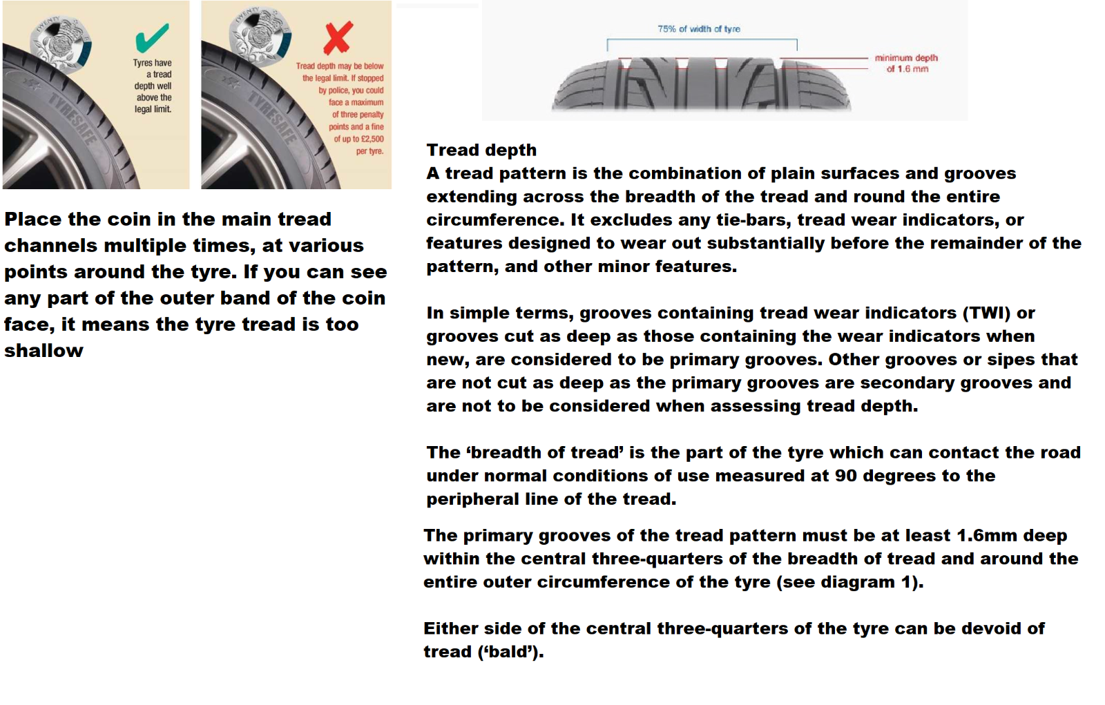

I have been out with my 20p and to my eyes, I'll call them the main circumferential grooves, are all legal according to what I have assessed from this info. The bit on the right is from the MOT Testers Manual and I see it specifically says
"Either side of the central three-quarters of the tyre can be devoid of tread (‘bald’)." Obviously not that desirable, but worn looking tread patterns on the edge not a fail point.
