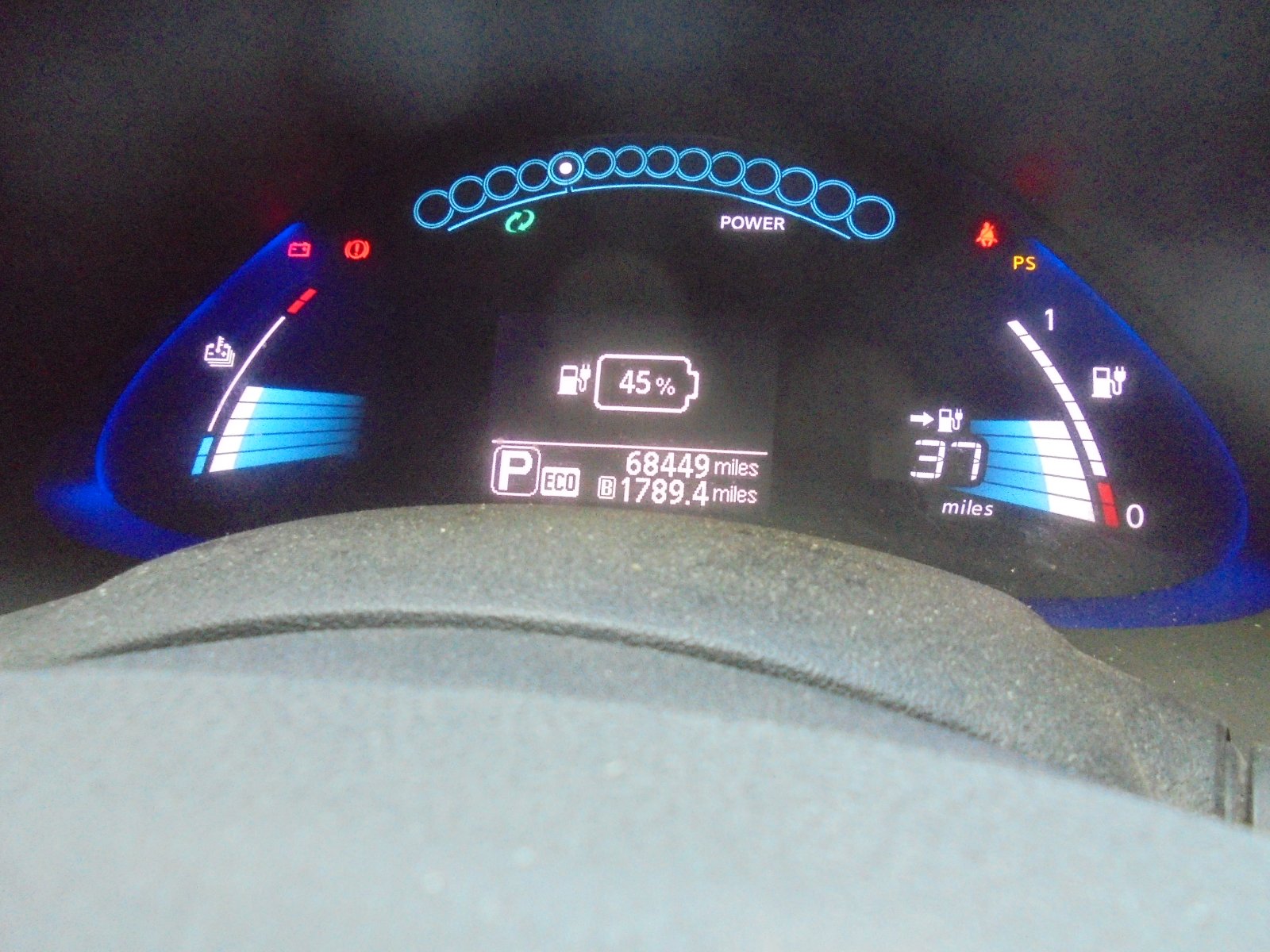

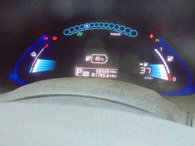

Take yesterday for example, the day when the mile-o-meter ticked over to 68,449 miles, 40,000 miles and 3¾ Years since buying the Leaf. Lovely tour of the Scottish Borders with a couple of charge ups, the second one being unnecessary but why not...15p/kWh at Woodmarket in Kelso right in the town square, and Fish and Chips to consume anyway. The first one, a nice wander down to the Tweed, camera in hand through a woodland path and job done on the charging front on our return half an hour later.
Currently the Leaf getting 5.1 miles/kWh, has 11 of 12 bars on the battery state of health, and more importantly gets us out and about around our usual stomping ground of Northumberland and Durham and the Scottish Borders, on many lovely trips out as well as the normal day to day duties.

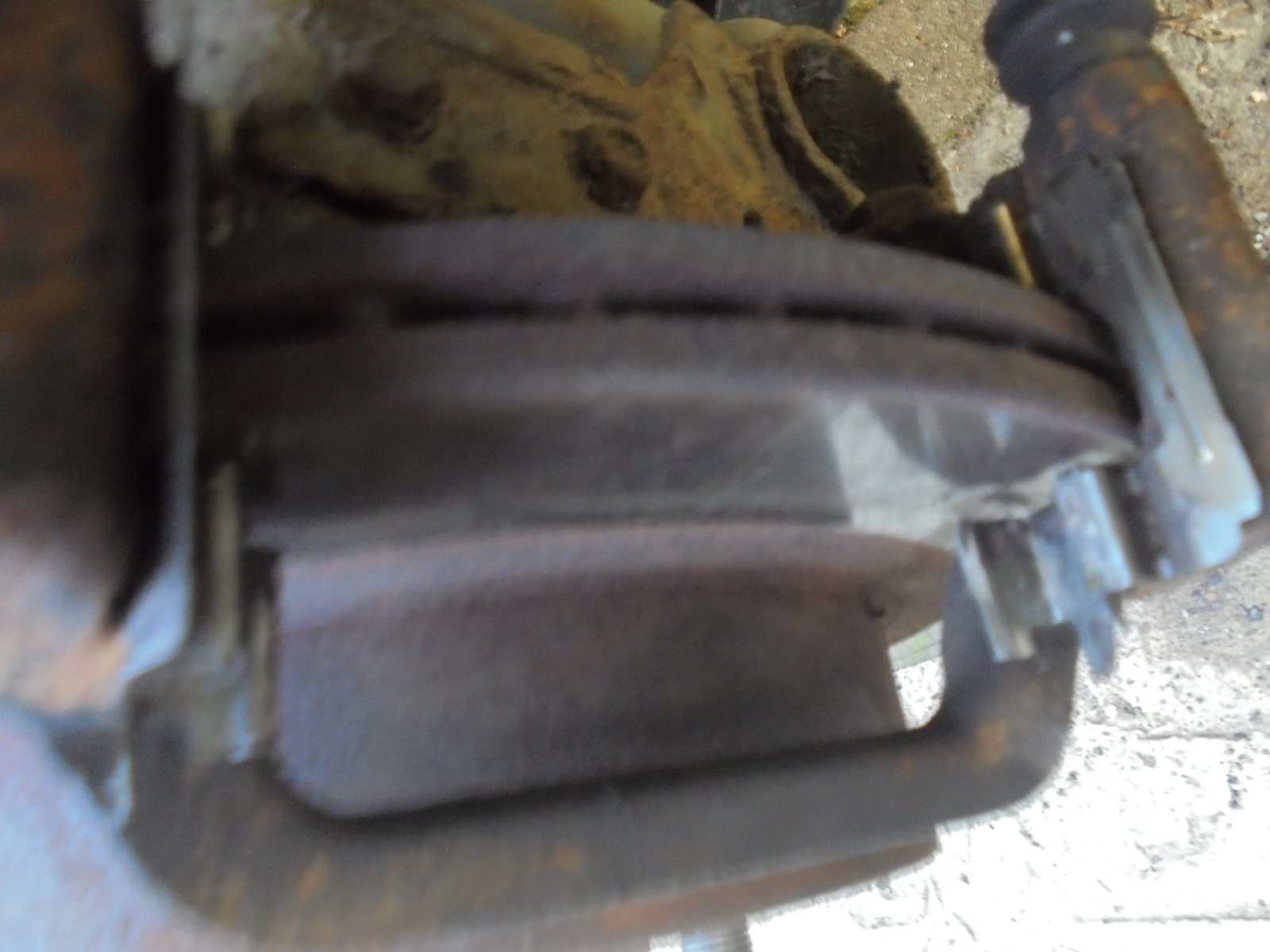

Looks like i will have to get my hands dirty, the rear parking brake (foot operated) with the shoes inside the middle bit of the disc needs a bit of attention to get a MOT pass. Not unexpected.
What was unexpected was getting the car back with another item to sort...rear service brake binding on excessively. Cant argue with that it was/is but only after the testing process as a brand new item. You do not get 5 miles/kWh with a service brake which is excessively binding on or have very noticeably hot wheels and disk, and it certainly wasn't binding on before the testing process.
Hopefully it can be resolved without a new caliper, and I do have new "parking brake shoes" which I bought a couple of years ago but didn't use which may help sort out the parking brake fail point.

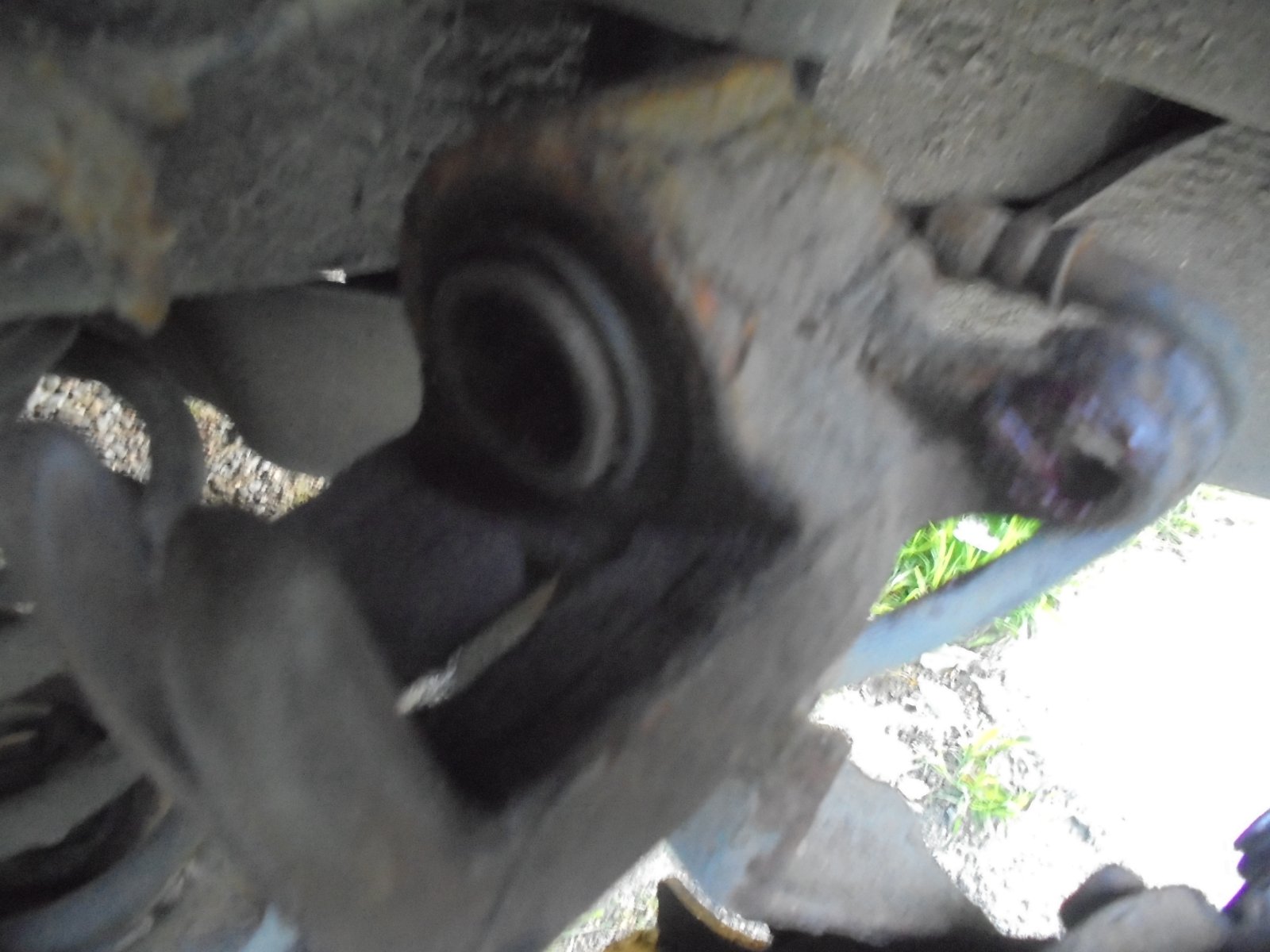

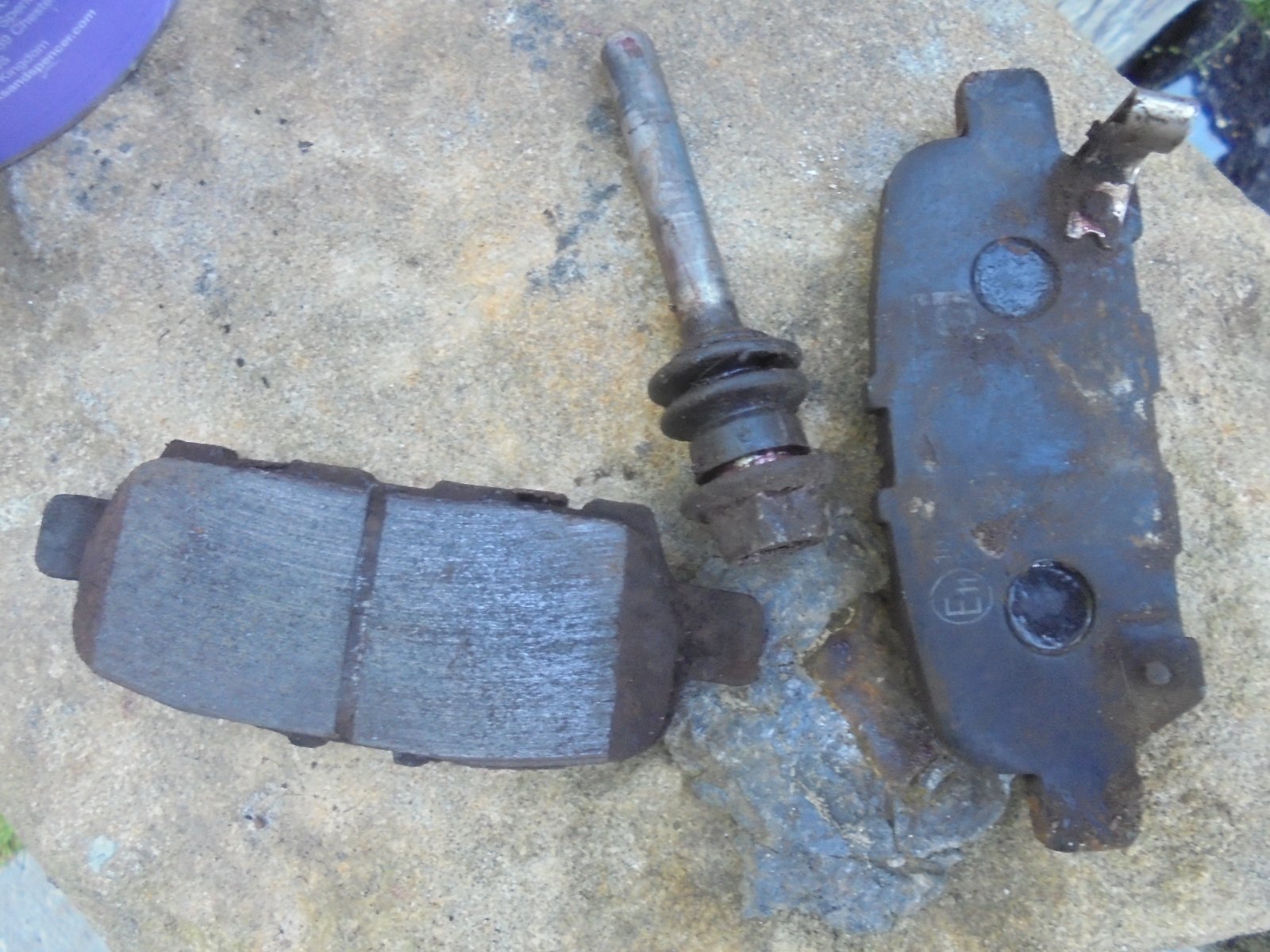

This looks simple enough, its the rear nearside which was temporarily in the process of the test and for a few miles after "binding on". Undo the slider pins, and grease them.

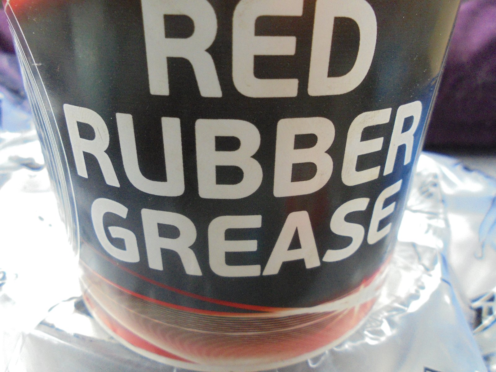

I did acquire the entire world supply of red rubber grease a couple of years agoi
NewcastleFalcon wrote: 31 Aug 2021, 12:18 Today I have taken the first steps to being a Red Rubber Grease tycoon.
With a quick cost benefit analysis, a big tin in the hand for just over £10 from the Agricultural engineers was a better deal than spending at least £6 in petrol consumed, and probably 1.5 hours, going to the nearest factor who would have something in stock and paying another £5 for a little tube, or a few sachets.
When I said thats a big tin, the guy at the agricultural engineers said..."What you really want is a bit from our tin".
Couldn't do it, far too cheeky :!: Always good to cultivate a decent relationship, and over the years their Aladdin's cave of stock has saved me a fortune.

I don't think I'd use rubber grease on the caliper pins Neil, a silicone grease or even copper grease would be my choice. I usually use copper grease on the pin and a dab of silicon grease inside the boot where you could use the red rubber. It will be interesting to hear others views on this one!! :-D

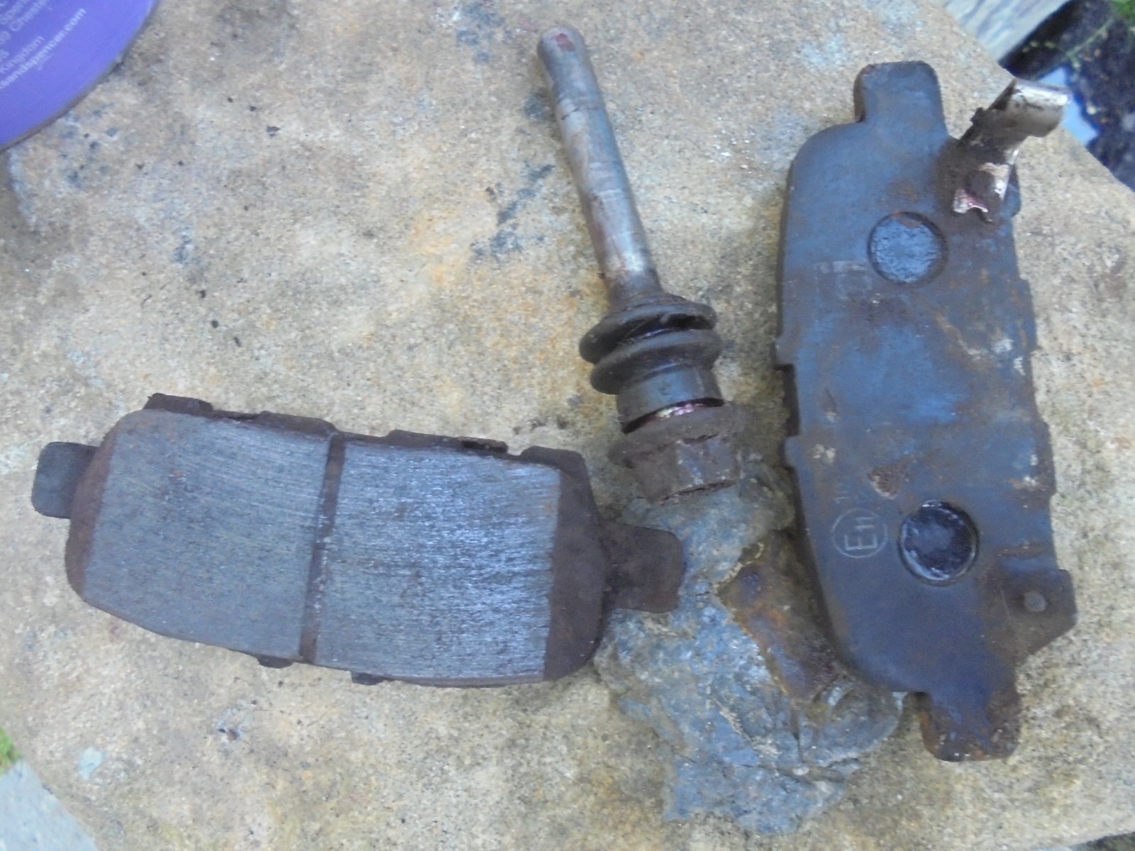

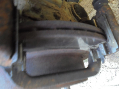

What needs sorting out to restore a non-binding rear service brake from its currently "binding on excessively" classification by the MOT tester :?:
Slider pins? Those pad clips, the pad "ears" which fit into those clips, the pad backs, the end of the calliper piston and the accumulated gunge and rust on and round it.
Clean up the piston end and see if it does its out and in job freely after a bit of a clean up.
In 43 years of many MOT's I have never had to replace a brake caliper or fit a DIY repair kit. The vectra maybe got one in 160,000 miles of motoring at some point, but fingers crossed the clean up will suffice.
The crux of the problem may well not be the calliper piston sticking but those pads were rock solid to remove from their little guide clips and a very tight fit with no freedom of movement.

I had a rear brake pipe rot though on a Xantia - on stripping down the outer pads were seized in the calipers - so much so that I had to saw them in half to get them out!! Despite this it had never warranted a mention on MOT, and it all freed up nicely and worked afterwards - I even managed to persuade the bleed nipples out (with plenty of heat and Plus Gas!). Hope yours works out equally as well, Neil!
