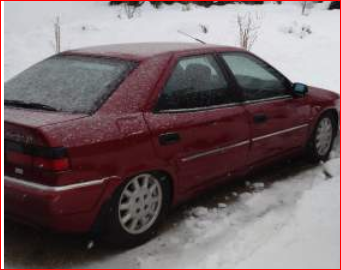

Do you have some pictures of the car so we can help you check it's what you want?

I would recommend that you get hold of the VIN number (which will be on the Carte Gris), and plug that into service.citroen to see what it really is. My strong suspicion is that it is not an Activa.
I also have a suspicion that LHD and RHD bodyshells are different, I don't think the RHD shell has holes for the LHD A/C pipes or brake valve, and the wipers are mirrored.

I have requested the Vin, but to be honest I do not suspect that this is NOT an Activa....edit: FYI, the car was originally Swiss
French V6 not the same shell ?...Agggg...but they sound like minor problems (are they ?) and I am not planning to have Air|Con fitted. on the car.
But thius shell information worries me.

Well I'm no expert but that's got the wrong wheels and no spoiler for a start..

s**t....he has just sent the Vin....his thinking on "activa" is Hydro3The_Hairdresser wrote:Well I'm no expert but that's got the wrong wheels and no spoiler for a start..
Vorsprung berk Technik
new plan needed, this guy is a mess
