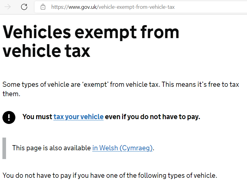

Couple of new tyres on the back, and DIY discs and pads at the rear in advance of today's test, and the Leaf is MOT'ed for another year.
Insurance time as well, sticking with the same mob as last year. Tax due 1st November, I've managed to put enough aside to cover that :-D
Although BB Leaf is Zero Rated you must still "Tax" the car.

myglaren wrote: 07 Sep 2021, 22:56 I hope your tax won't break the bank Neil.
Should manage it Steve :-D , I posted that up as a reminder to self...you are supposed to tap a few keys and "Tax" the Leaf even though its zero, and easily forgotten.

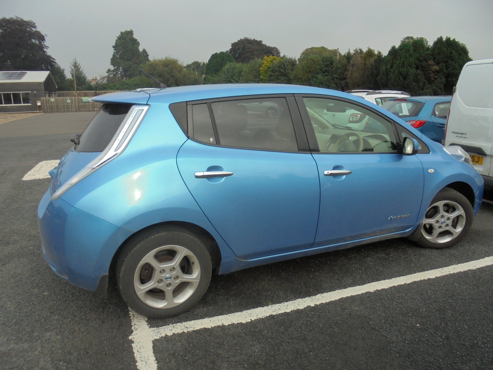

BB Leaf clicked digitally over to 44,444 miles on the mile-o-meter today. It was about 28,400 when we got it so that's
16,000 miles in our ownership since November 2019.
This rather gorgeous looking creature was in the car park, and I had a brief chat with the owner. It was one of the first Leaf's on an 11 plate, and made in Japan. She said it had 57,000 miles on, but because it is 10 years old, it had pretty much reached the end of its usable useful life, other than simple round the doors 10-20 mile shopping trips. The lady still loved her car, but for any sort of longer journeys like a 150 mile round trip to Newcastle or Edinburgh would be pretty much impossible.
So looking at that car, Still in great condition bodywork and running gear wise with plenty of life in that, but the battery, needs replacing or upgrading to restore functionality to that car. Is there an industry to help :?: , or will Nissan help with that :?: , or indeed would it be worth it :?: Is that the time when the battery replacement would be best facilitated by a leasing arrangement should you wish your car to have be set up for another 10 years with a replacement battery.

Thanks Gibbo Cleevely's seem to be getting plenty of work but when you look at those sort of prices unfortunately the "recycle", plus buy a whole replacement car option, is likely to be the most economical for the owner, and it's part-used batteries which they fit, as they become available.
With replacement cells in 2021 being considerably cheaper than the originals fitted in 2011, the aftermarket needs to develop to avoid the inevitable scrapping of 10 year old cars. Maybe this is where Herbert Deiss's old idea comes in.
If you arrive at the 10 year point in a car you like, but the battery has degraded to an unacceptable level of performance, instead of forking out say £7,500 (or hugely more if its a TESLA) or scrapping the car, the battery pack gets replaced with a new one and you pay for it by the month on a Battery lease. Manufacture gets the old battery pack back and recycles it properly as they choose.
At the end of the day you pay for the battery replacement regardless of course, but at that stage the choice of paying outright thousands, or scrapping the car, may be unpalatable. Continuing to use the car with a new battery with a guarantee, but with a new monthly battery leasing charge to pay, may well be a more attractive proposition and save some cars from too-early recycling.

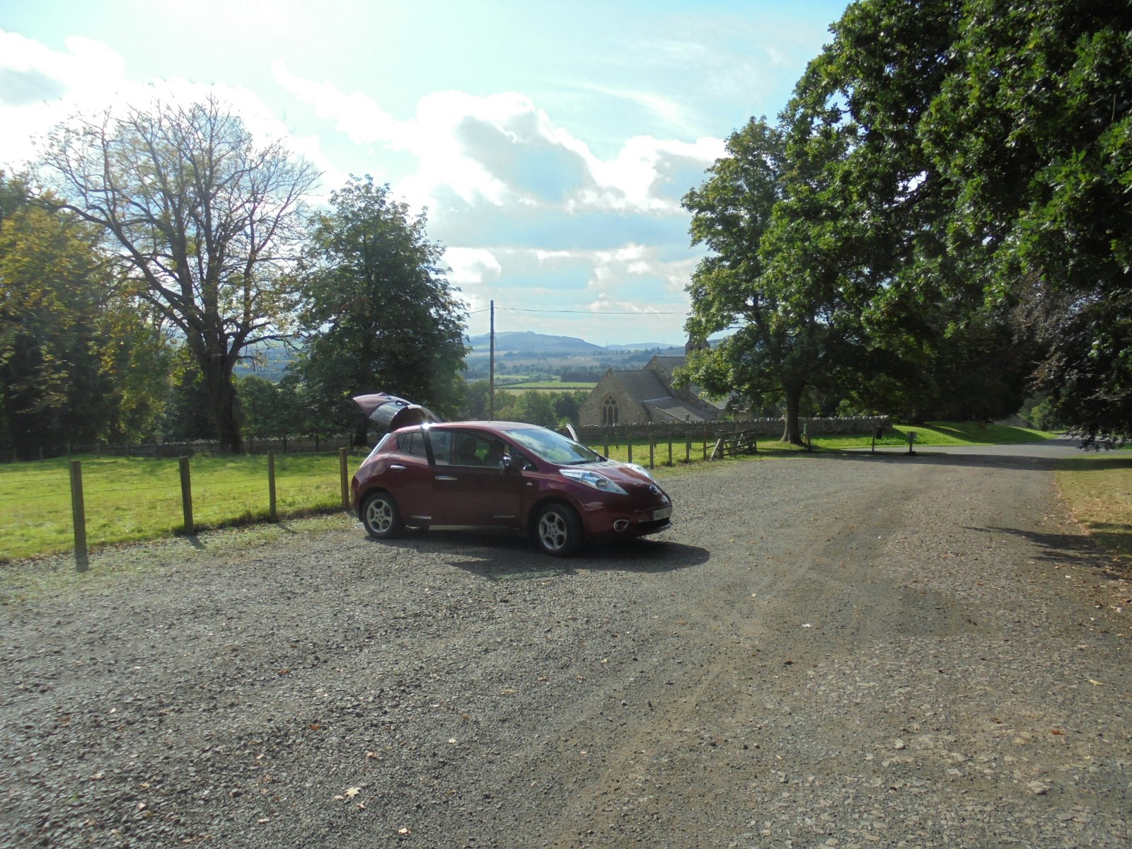

lovely day and a nice place to stop off at
and have a drink of juice behind the black bull
