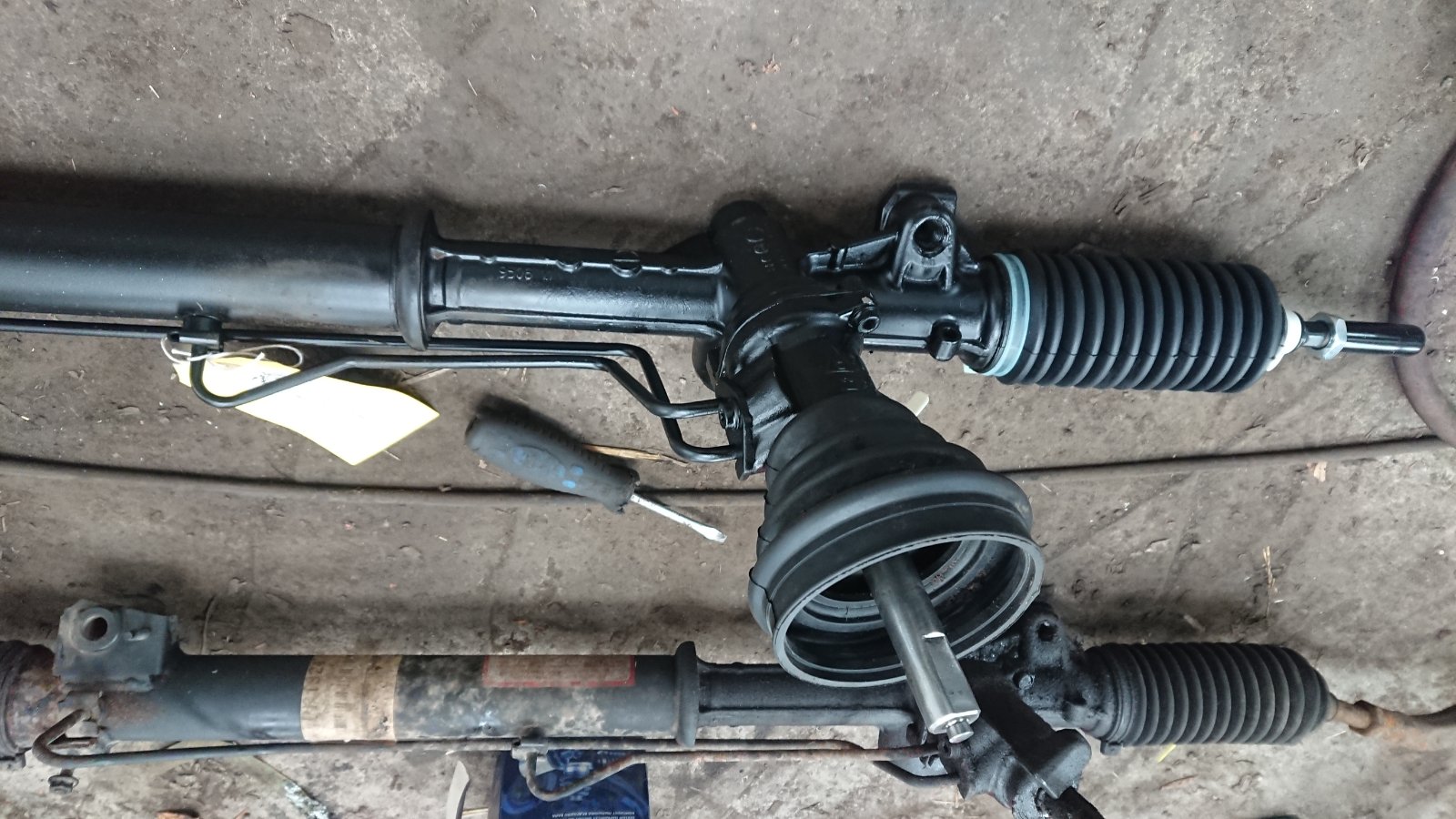

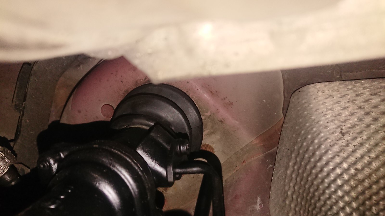

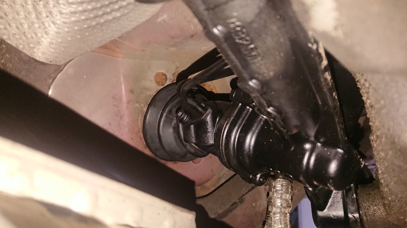

Re: C5 X7 Steering Rack - Again!
Just wanted to share my modification. I've used a cv boot to protect the pinion shaft. I'll let you know in 12 months if its worked but can't see why it won't.
I was thinking something along those lines, it has to be allowed to rotate one end of course. I am still topping mine up - vary rarely, used less that a litre since I got it in august. The other one doesn't leak but the steering is heavier. On the red one I assume the light steering is because of the slackness of the seal and super lubrication its receiving, I prefer it like that.
