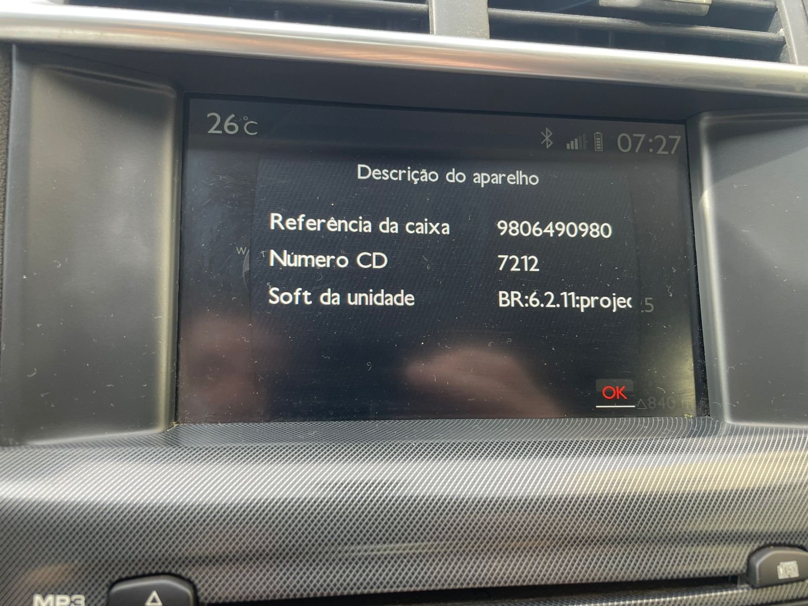

prco
Posts: 5
Joined: 12 Dec 2025, 21:01
Re: RT6 2.75.c.5 Firmware / Software Download
Unread post by prco »
"Soft da unidade - BR:6.2.11:project"
Looks like my version is 2.11, right? I've already tried to update it but RT6 just boot into the pen drive with the newer version and don't install it. Can you teach me the correct way to update the system?
Reason: Image attached
Posts: 9016
Joined: 07 May 2009, 16:24
x 1873
Unread post by Paul-R »
It actually says 6.2.11 which looks like a version number for SMEG+ IV2 systems. Can you post a photograph of the system in your car? Is it touchscreen?
prco
Posts: 5
Paul, finaly I got it updated to 2.86 version, thanks!
