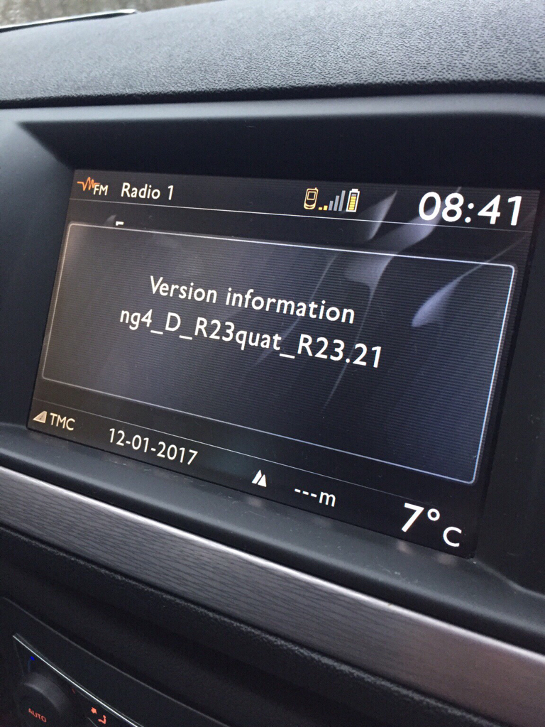

Done the update I think - took about 15min
It still says 2009/10 version is that right?

Ben - if that's the new screen shot, then no - it has not updated! (top picture). It is still showing the same firmware version as before. As Paul says, the maps are separately purchased (just google Citroen Navigation) and yes that is the early map - the latest is 2016 second edition that has just come out.
Just noticed you've posted the old screenshot - the time is the same as your earlier post!
Ensure the car is running first and on the navigation screen, then insert the USB and wait - if nothing happens then either the files are not on there or the format is wrong. Did you 'unzip' the files onto the USB key? You should just have the following on the USB - one folder and one file, nothing else.

Re: Navidrive 3D
Yeah my bad. Here is the updated version.GiveMeABreak wrote:Ben - if that's the new screen shot, then no - it has not updated! (top picture). It is still showing the same firmware version as before. As Paul says, the maps are separately purchased (just google Citroen Navigation) and yes that is the early map - the latest is 2016 second edition that has just come out.

Re: Navidrive 3D
Hoggers, looks to me like the SW has updated.
Looks like it's trace the aerial lead time!
