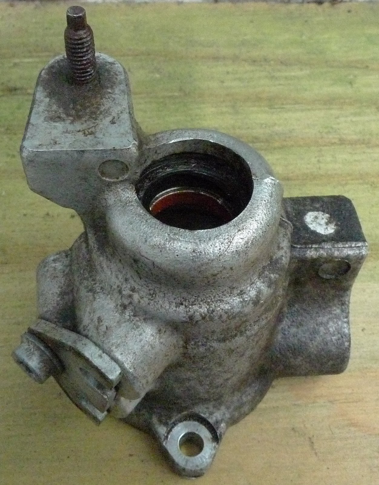

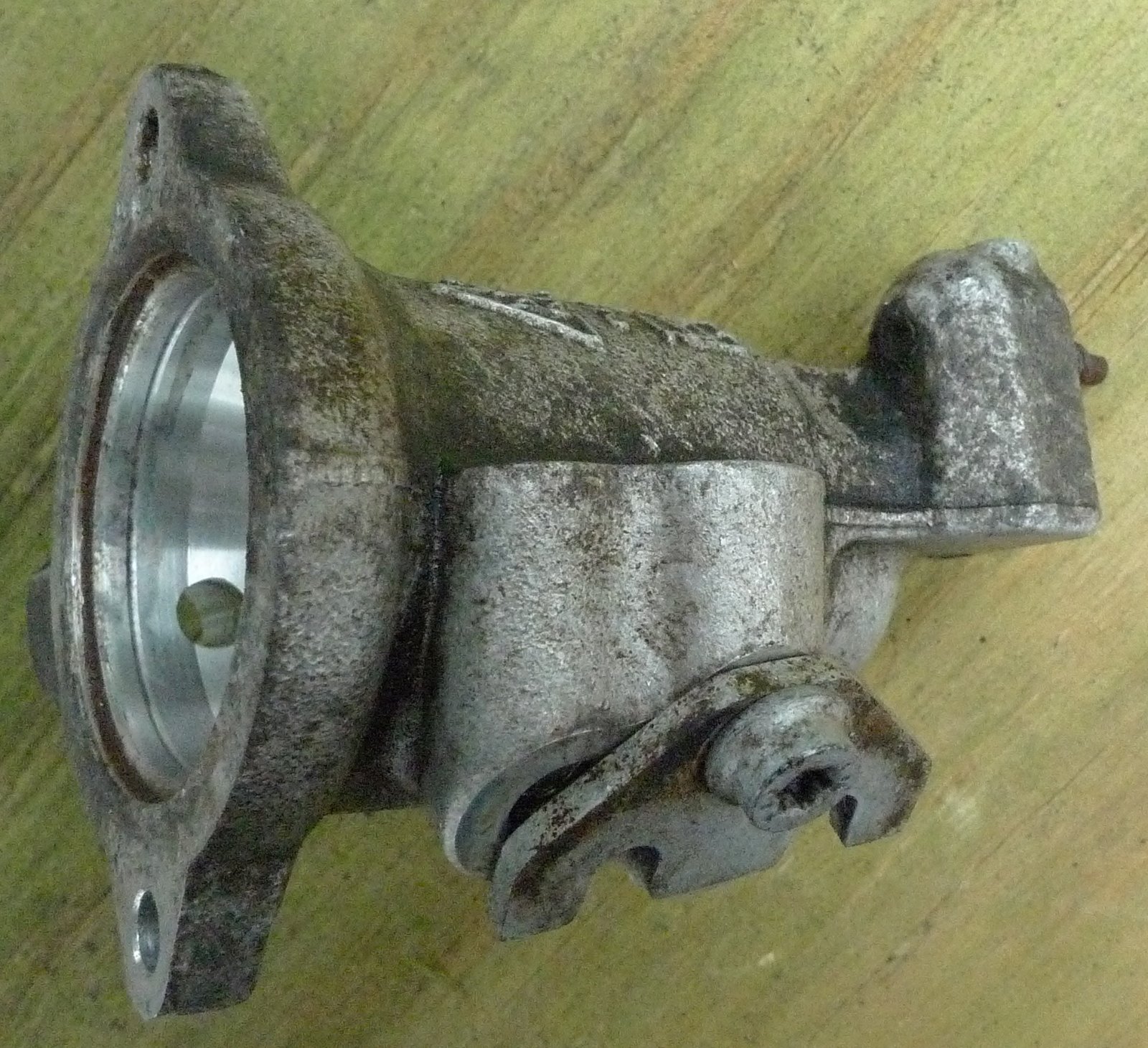

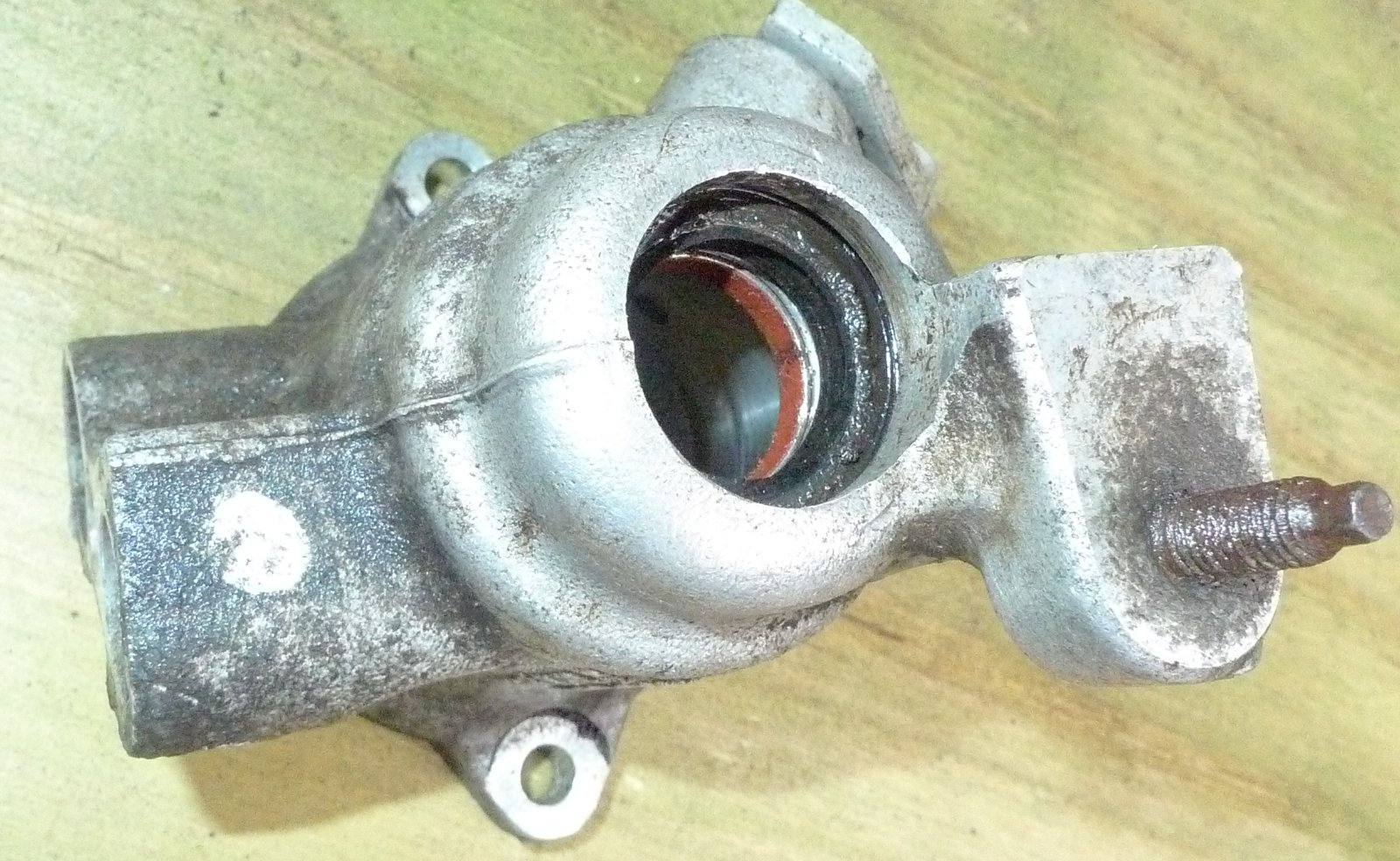

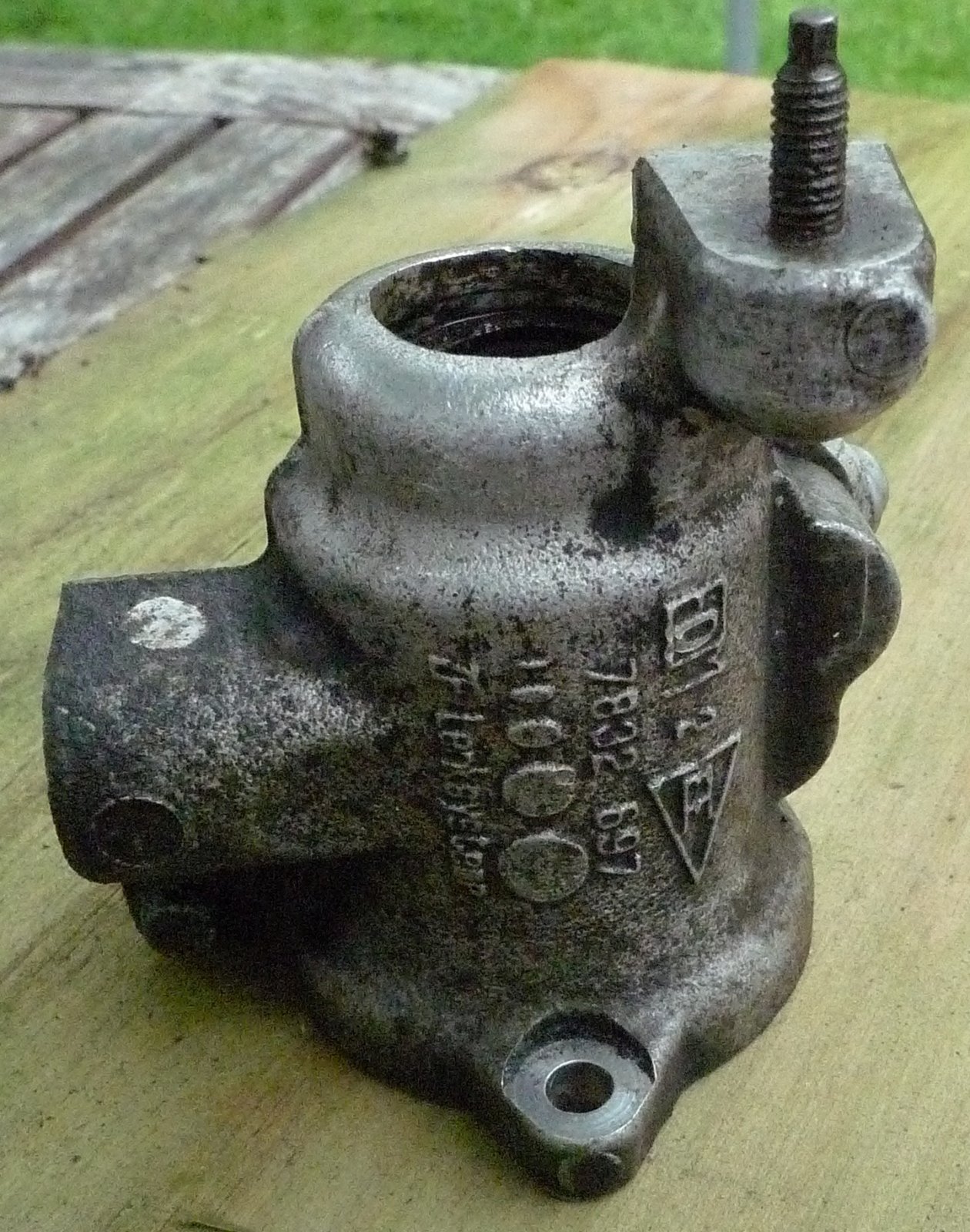

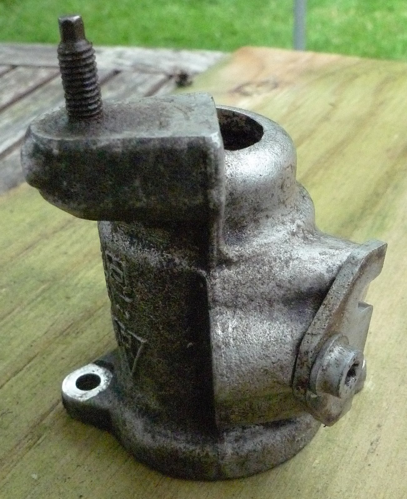

"And on the conveyor belt tonight we have...... some pictures of a dirty old pinion shaft housing taken earlier" :)
Pinion housing 5 - own work
Pinion housing 6 - own work
Pinion housing 10 - own work
Pinion housing 11 - own work
Pinion housing 14 - own work
Pinion housing 15 - own work

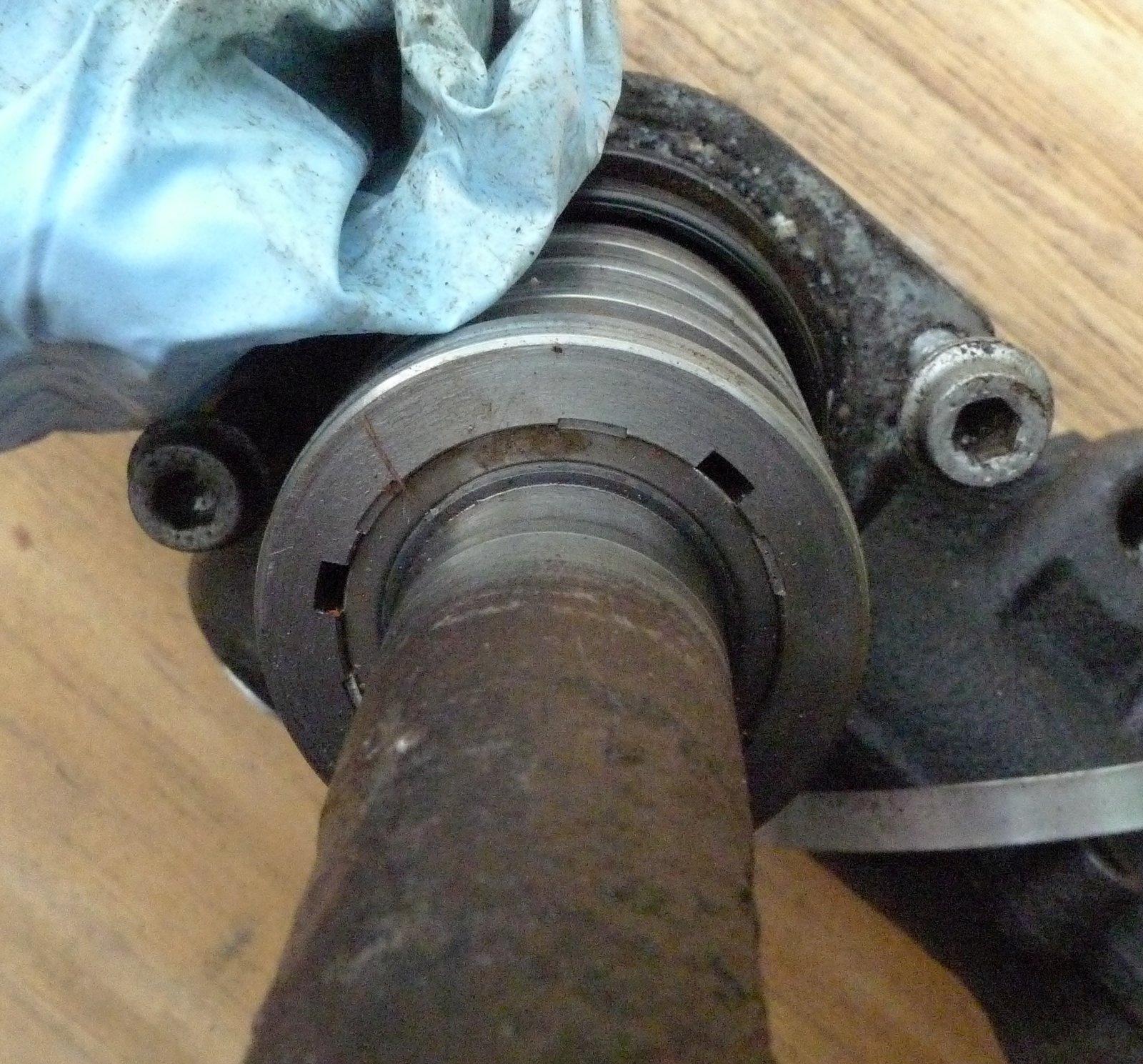

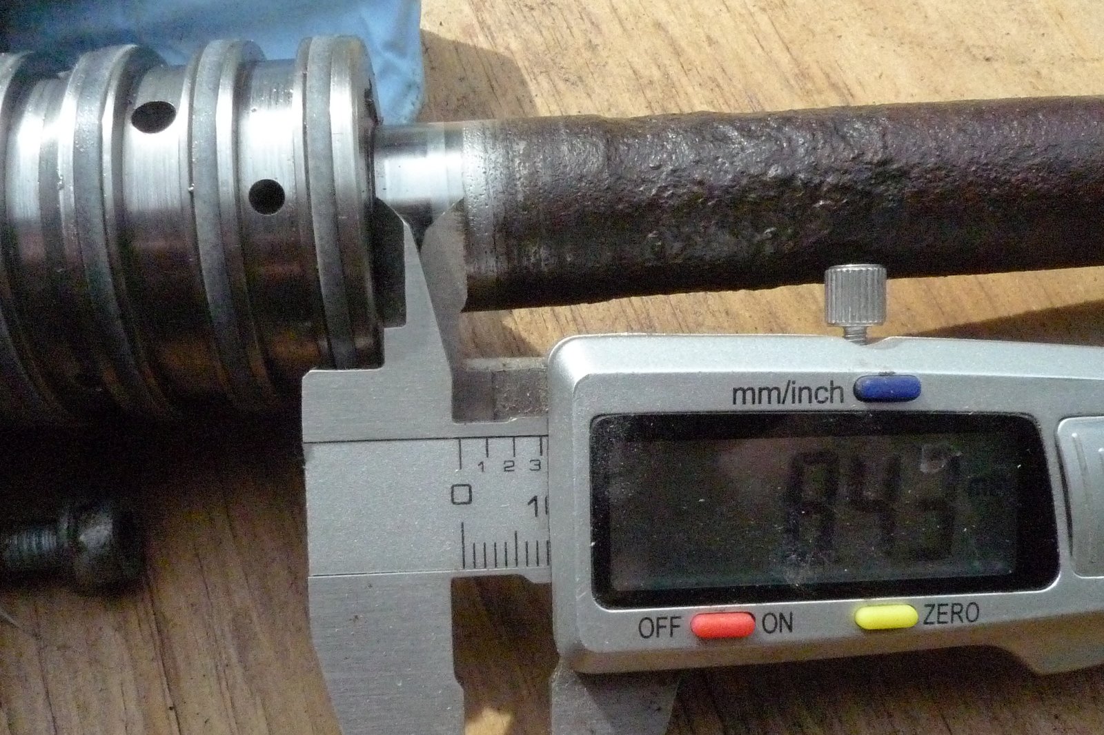

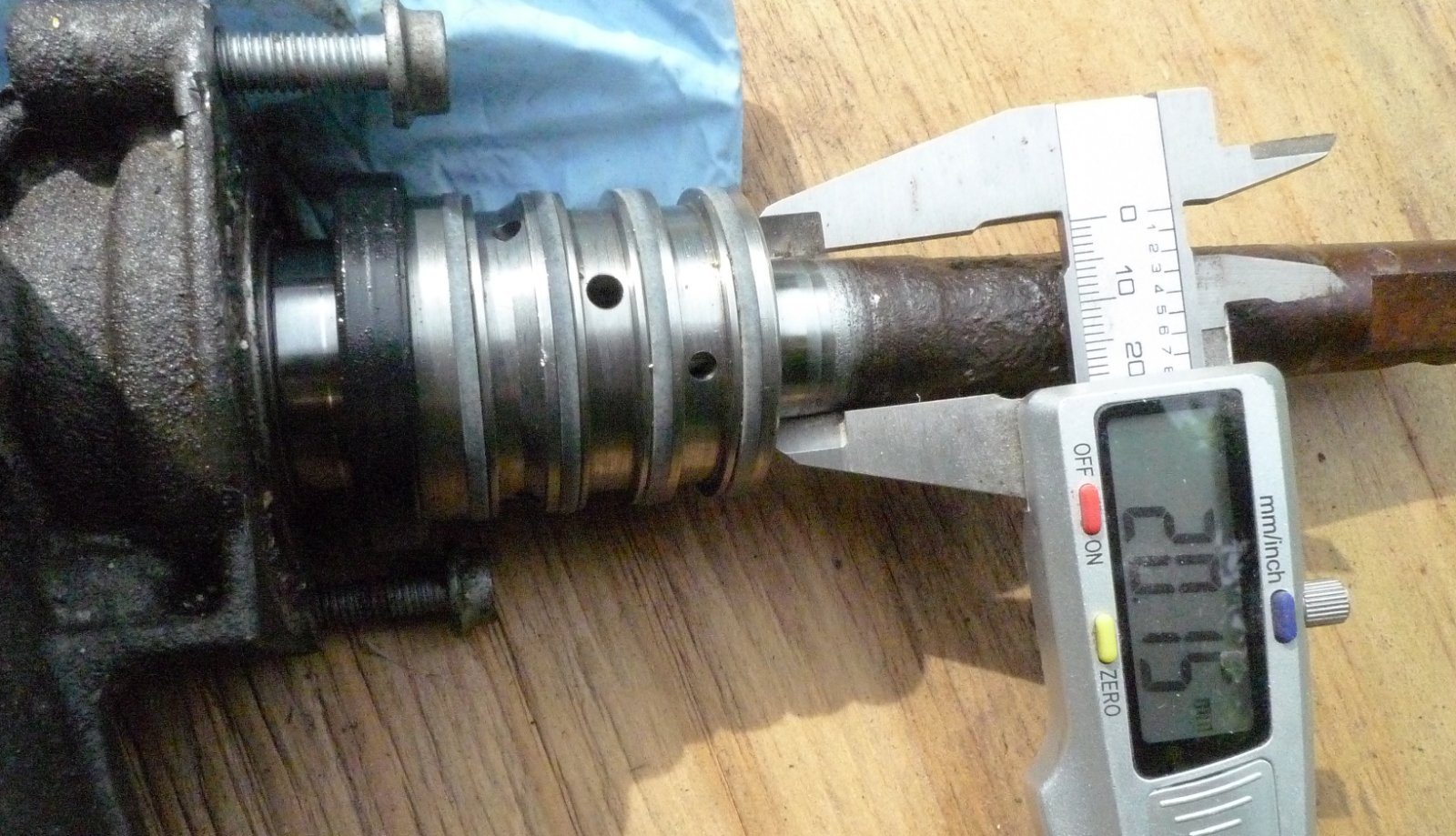

Hi Bobins, as you have the rack apart could please take a photo of the shaft side on?
Cheers
Where's the cuddly toy or did Anthea forget it!!

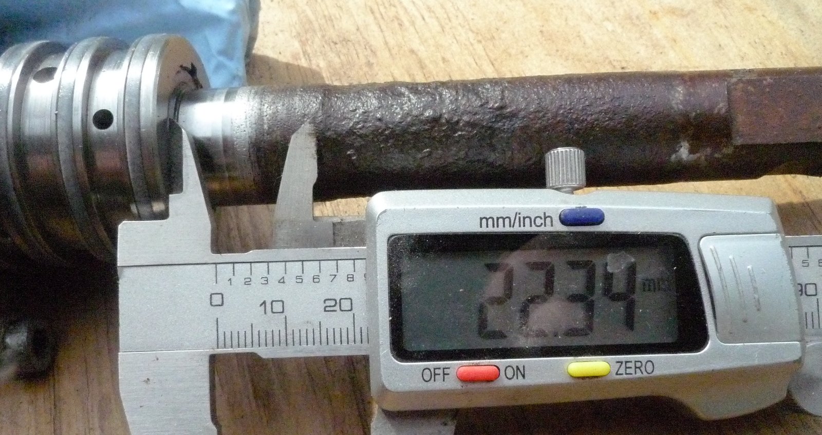

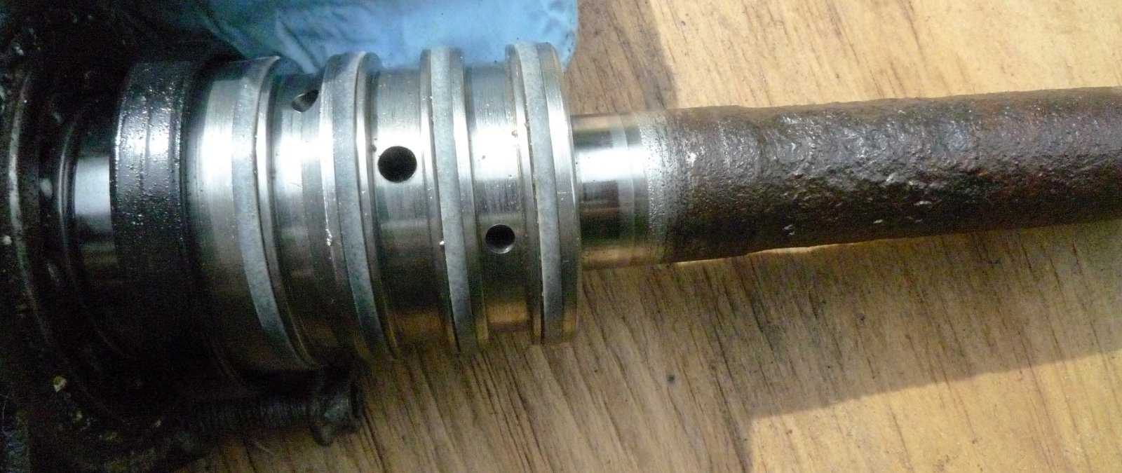

shaft 16 - own work
shaft 16 - own work
shaft 17 - own work
shaft 17 - own work
shaft 18 - own work
shaft 18 - own work
shaft 19 - own work
shaft 19 - own work
shaft 20 - own work
shaft 20 - own work
Anthea's cuddly toy - own work

I've just been cooking the pinion housing as per Xantia_v6's suggestion (lightly oiled housing served with a rich jus de la Fluide DA, in case anyone was wondering :-D ) and the metal ring and oil seal came out relatively easily once cooked at gas mark 3 for 5-10 minutes. The OD of the metal ring and oil seal is 30mm, with the ID being 20mm. The oil seal is a single lip 5mm deep one. I think there'd easily be enough room for a two-lip (R23) seal in there.

Good Cuddly toy :rofl2:
Thanks, you can actually see where the seal rubbed during its life, it is also nice to see the shaft diameter is smaller than the seal diameter, which will prevent damage during reassembly. However, I think we have been looking at the wrong cause, the seal rubbing surface is free from corrosion on the picture, if corrosion was at fault then surely the rubbing surface would be marked, I am thinking it is not corrosion but the seals perish due to them holding water in the recess on top of the housing. This also means, for future failures that just replacing the seal would be sufficient. Bobbins, are there any numbers on the seal?

If you look on picture "shaft 19" the clean part of the shaft 'within' the 8.43mm measurement is where the metal bush (the thing with the 3 holes in it in one of the previous pictures) sits, I think the oil seal sits on the rusty part to the right. I'll try and do some proper measurements later and see where everything sits.

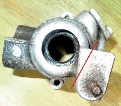

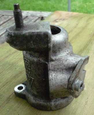

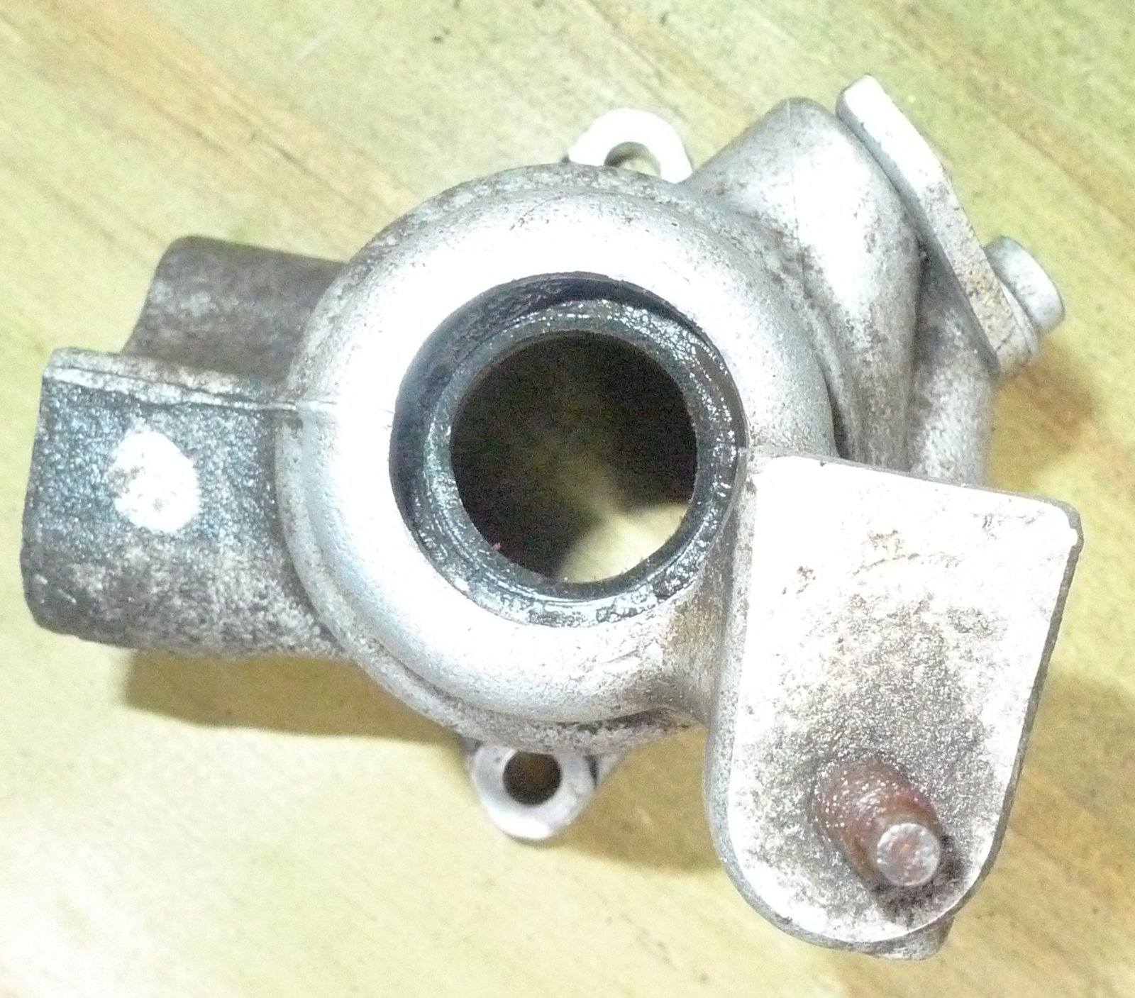

Can I ask, what is the diameter of the housing/casting around where a boot would sit ?
Taken at the same level as the red arrow.
Posts: 6836
x 3556
Re: C5 X7 Steering Rack - Again!
The diameter at the red arrow is 40mm. The internal diameter where the dust seal sits (blue arrow) is a good old fashioned inch.
Housing diameters - own work
