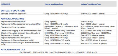

Posts: 42019
x 6917
DV6C 115 (Euro 5) Engine.
On top of routine servicing for 64k miles, 15 year old vehicle:
  • Passenger compartment Filter
  • Check of the PH of the Coolant
  • Check of Particle Filter Additive Level
  • Replacement of Air Filter
  • Replacement of Diesel Fuel Filter.
Specific Operations / Mileage / Time
Click Image to Zoom

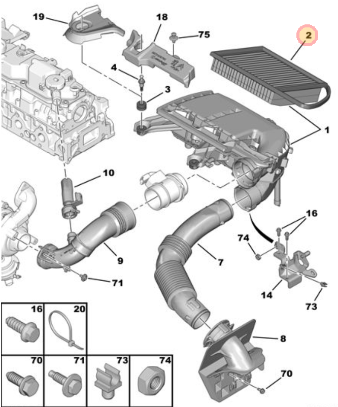

Air Filter
(2) Air Filter:
Genuine PSA, part: 1444TV, £35.74
PSA Alternative, part: 16 1891580, £14.14

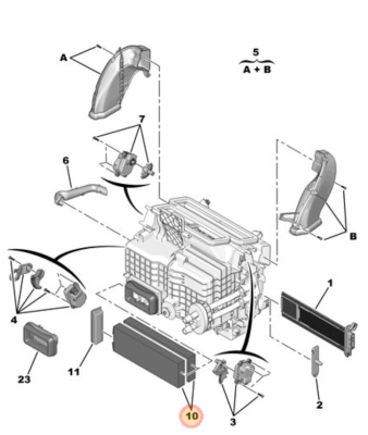

Pollen Filters:
(10) PSA Carbon (Particle & Gas), part: 6447XG, £50.96
PSA Alternative Carbon (Particle & Gas), part: 1609998880, £27.79
PSA High Performance Anti Allergenic Carbon, part: 9821501880, £63.62

Many thanks, Marc. It is on 62500 miles and is coming up to its 11th anniversary. I should have done the timing belt when she got it in Feb but times has run away with me.
Interesting how the servicing schedule mentions diesel particulate additive as, as far as I am aware, it doesn't have any such system. It's not got AdBlue but that may be different to a diesel particulate additive?
Will do cooling system drain and refill as part of the timing belt + pump. She wants to keep on top of it.

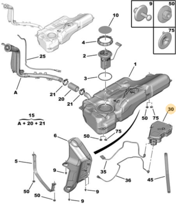

Can you post image of where the EOLYS tank is please so I know for future reference?
Posts: 42019
x 6917
Here:- shown at (30), usually hidden behind a heat shield on the left of the fuel tank.
Here:

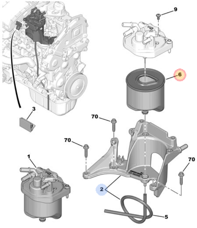

Fuel Filter

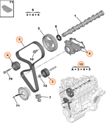

Timing Belt Kit (Belt, Tensioners and Coolant Pump)

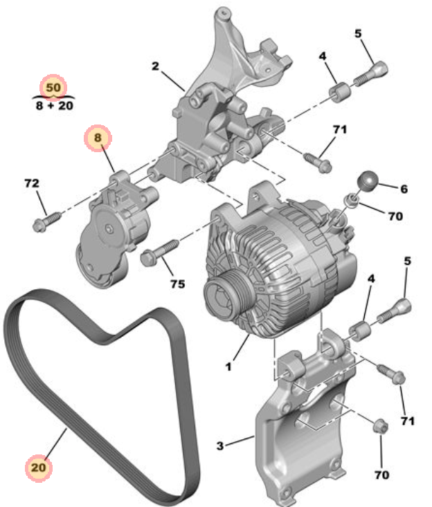

Auxiliary Belt Kit (Belt and each tensioner - I've not looked yet but assume there on two pulleys on the DV6C)

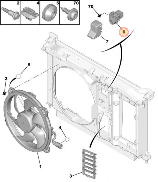

Fan resistor module (as have P0493 code - not yet checked the resistance but it's likely to be that).
(15) PSA Timing Kit & Coolant Pump, part: 1684448280, £252.07
Cheaper PSA Kit, part: 1684891780, £158.71
Contitech Kit, part: 1689586380, £173.82
(6) PSA Fuel Filter Cartridge, part: 9809721080, £60.97
Cheaper Option, part: 1611659480, £36.05
(50) PSA Ancillary Belt Roller Kit, part: 1611277880, £130.54
Cheaper Alternative Kit, part: 1613444880, £39.05
(6) Cooling Fan Electronic Control, part: 9830143880, £104.87

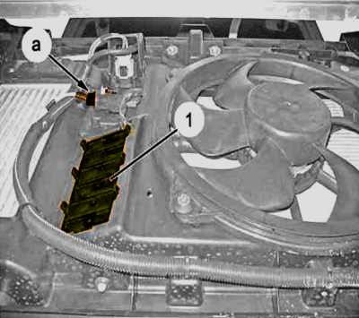

So sorry, Marc. Thought I had finished. Where do I request work sheets for changing cam belt and fan resistor module please? Is it here or just on a separate specific post? You'd think I'd know the answer to this having been on the forum for so long... SORRY!
I've stood and looked under the bonnet for the fan module for 5-10 minutes and couldn't find it. It's probably tucked behind what I think is the intercooler.
Posts: 42019
x 6917
For the Fuel Filter, follow the same guide for the X7 with this engine Here
3008 DV6C Timing Belt Removal & Replacement
The Fan control is best accessed from below the vehicle on a hoist, by removing the under-engine protection to get to it - above 'a' below:
