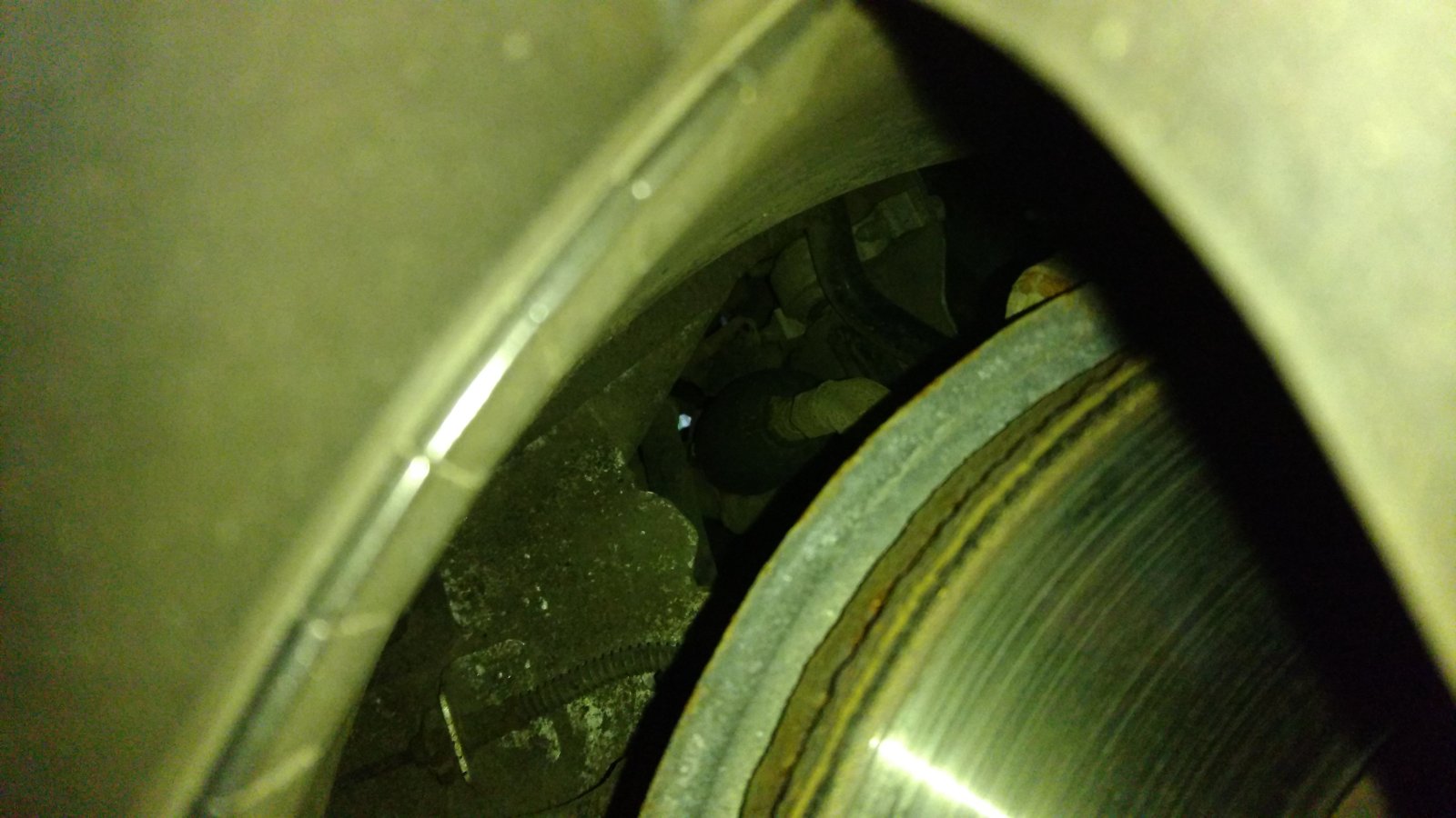

bobins wrote: 10 Jun 2018, 20:08 Apologies if you've covered this before, but do you know what condition your steering rack is in ? I ask purely to see if there was a production year that they were modified with better components and so don't fail. It is possible to just about see the condition of the pinion shaft by shining a torch through the wheel on driver's side wheel arch and hunting around to find it, but you get a much clearer view by inspecting it via the driver's footwell - about a half hour job (including cup of tea) and needing only a 10mm socket and a 13mm socket or ratchet spanner.

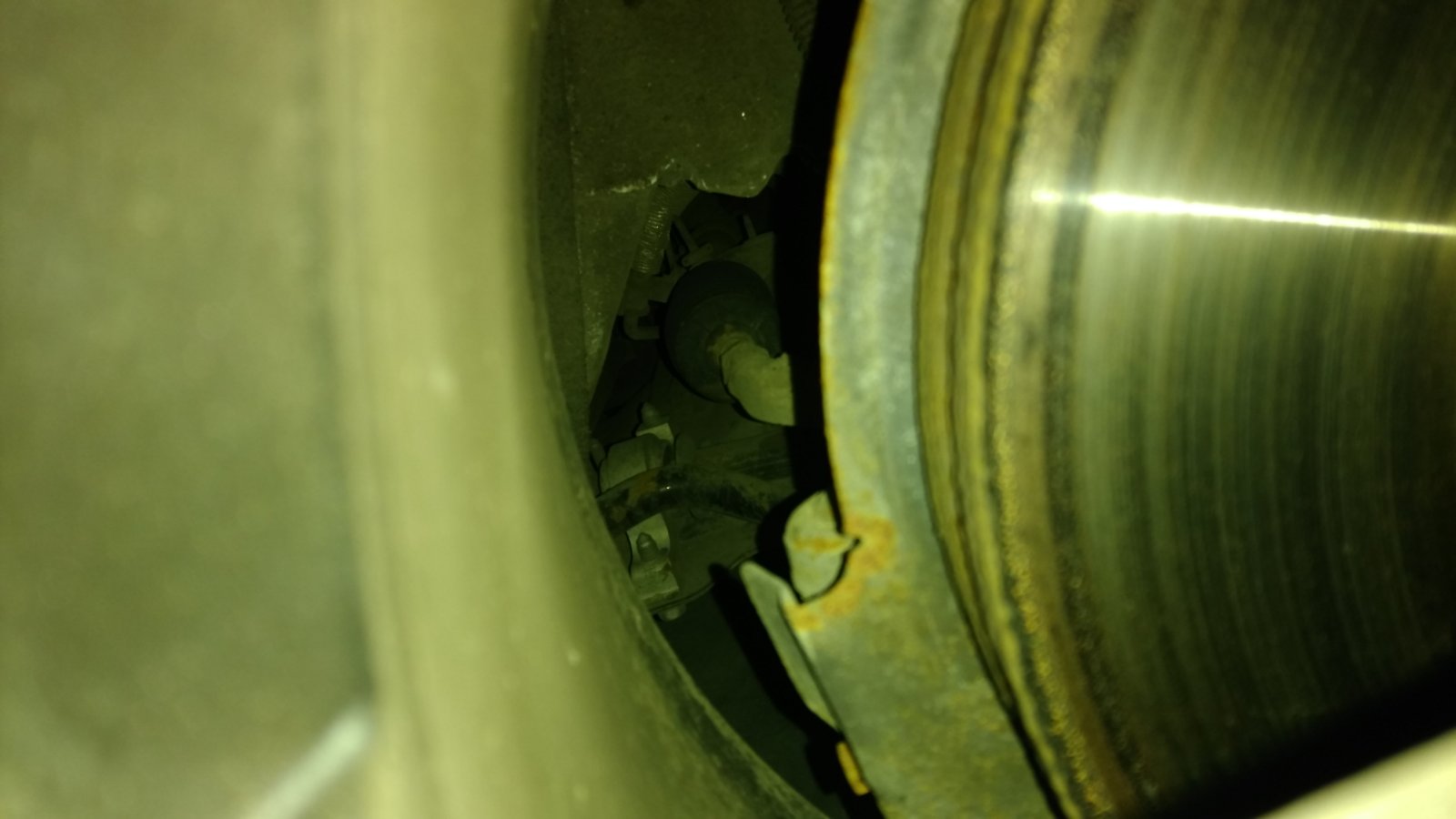

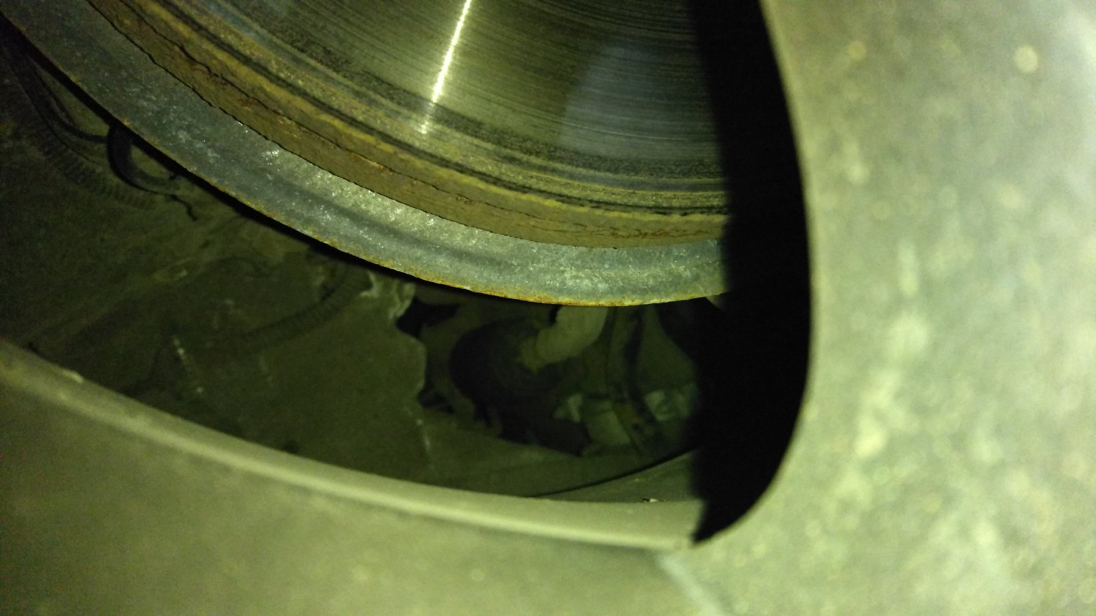

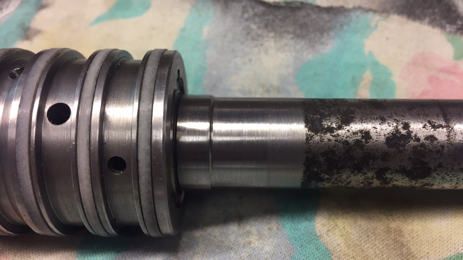

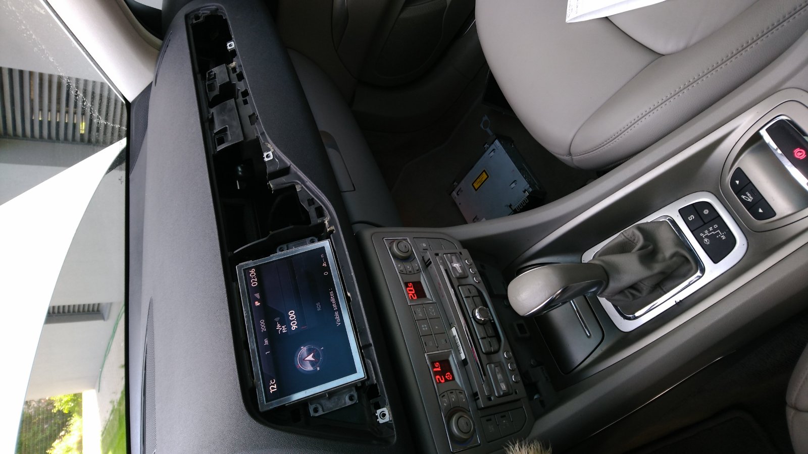

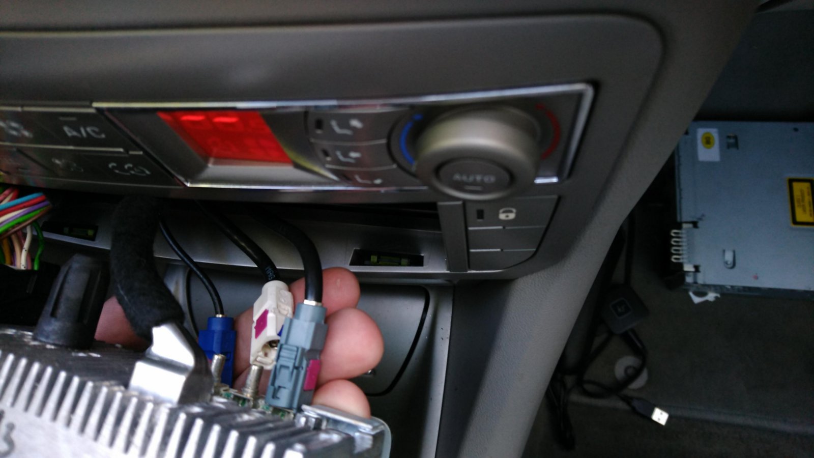

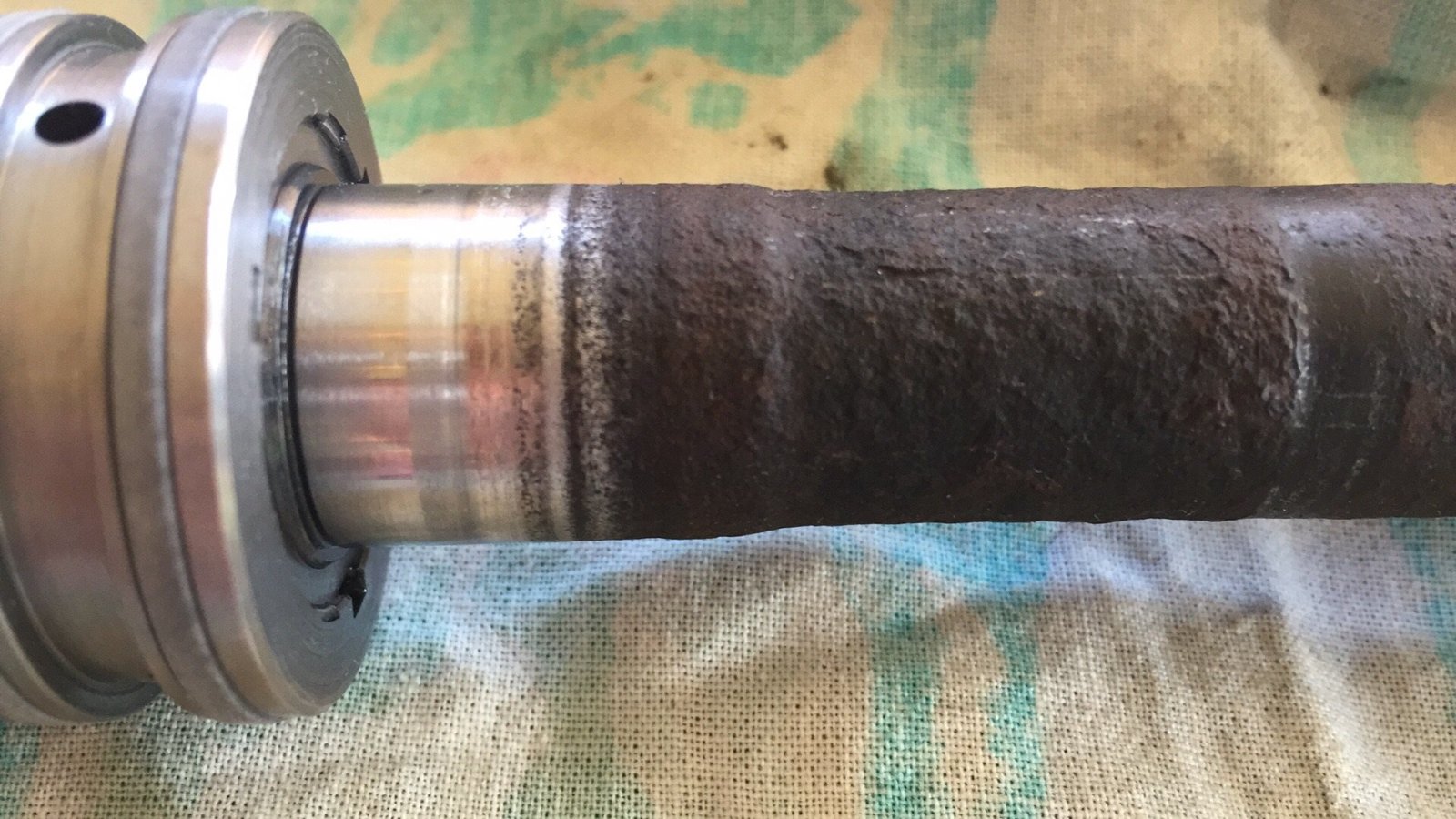

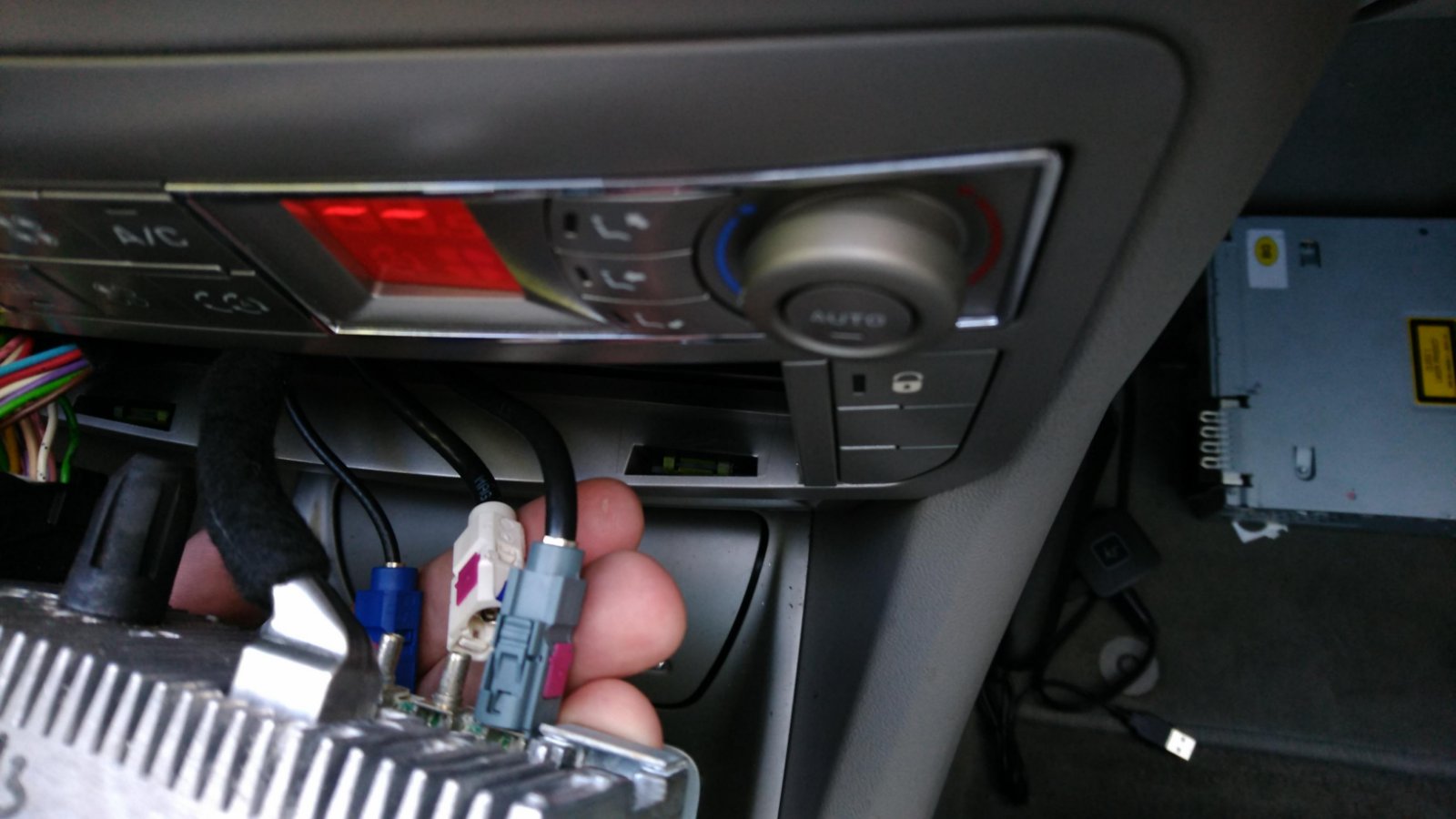

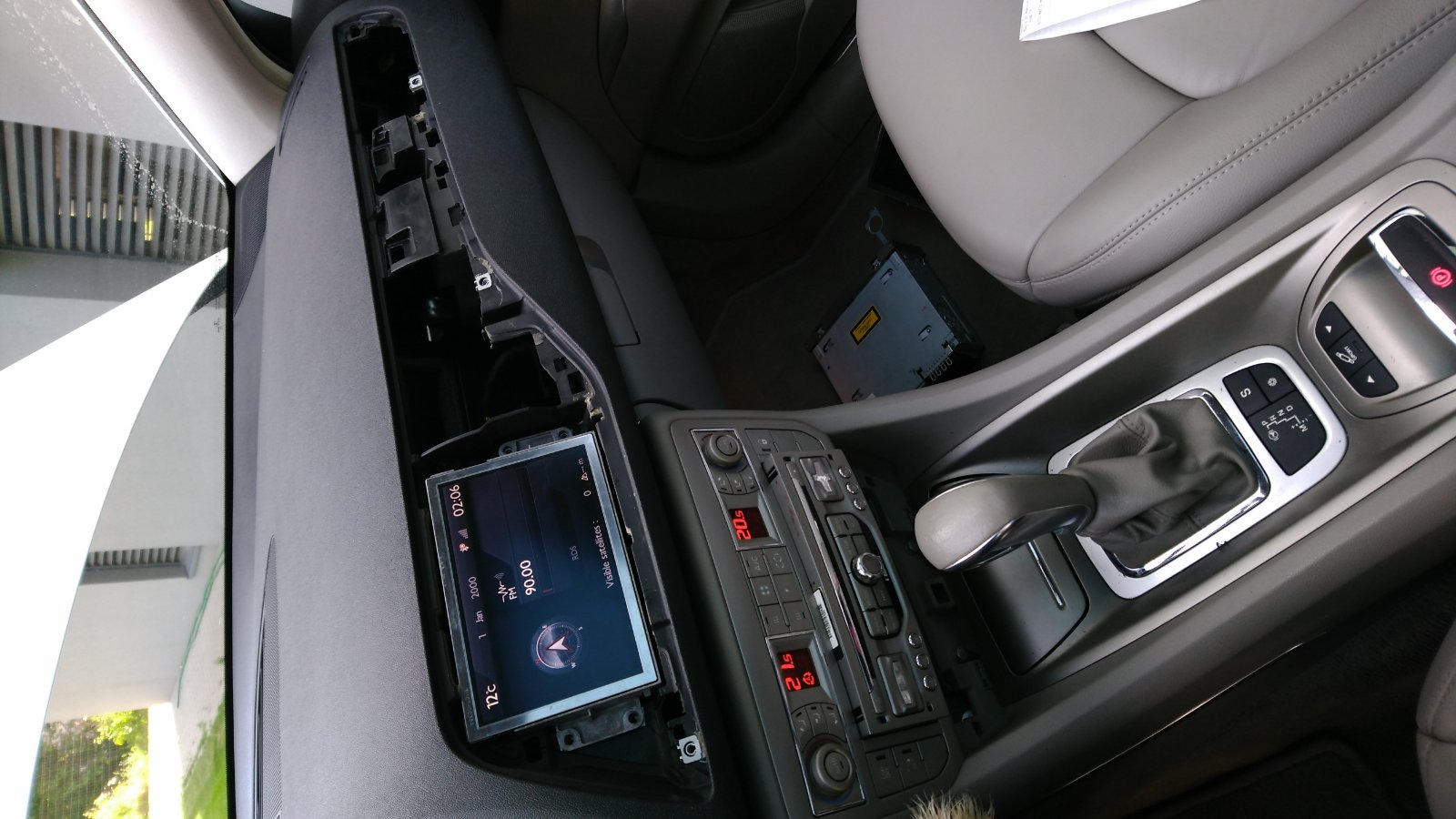

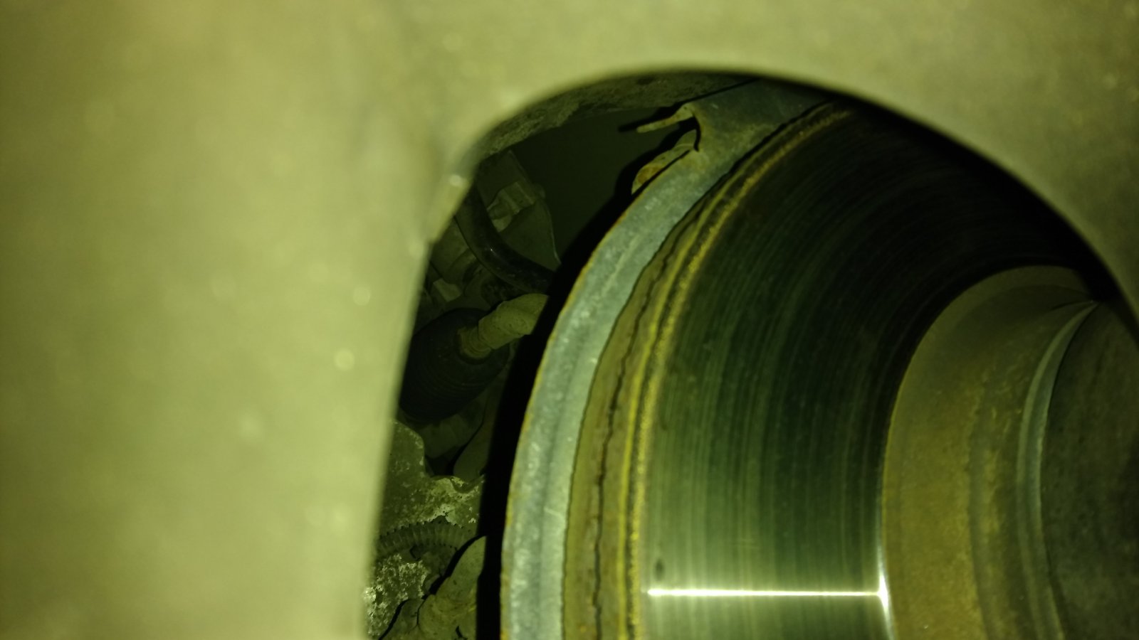

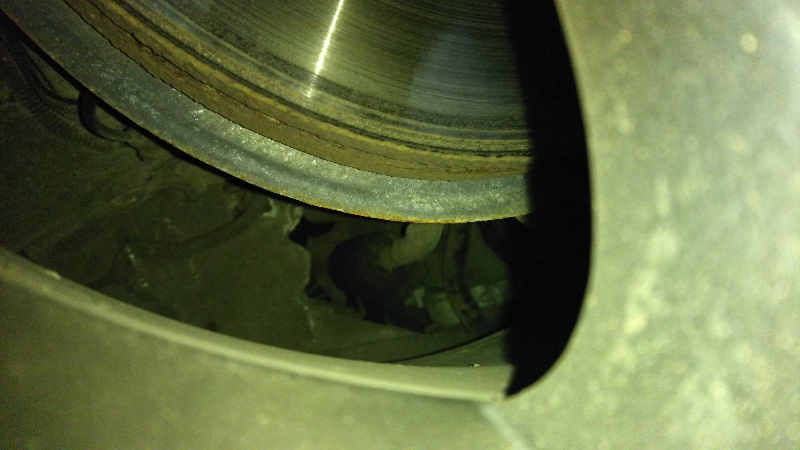

I'm not equipped to self-inspect for time being, but did get a set of photos taken through the wheel, and got a dealership time for first thing tomorrow morning. Topics to cover:
1) calibration of my RT6 RNEG2 retrofit (zero gps, bluetooth echo)
RT6 RNEG2 1/2
RT6 RNEG2 1/2
RT6 RNEG2 2/2
RT6 RNEG2 2/2

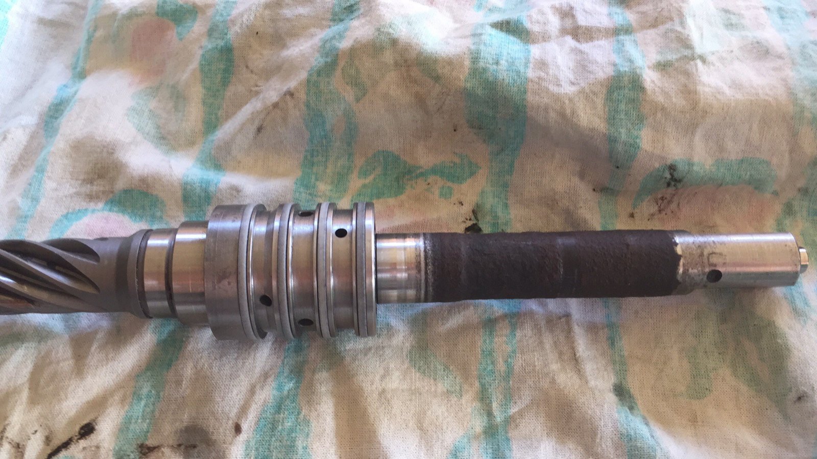

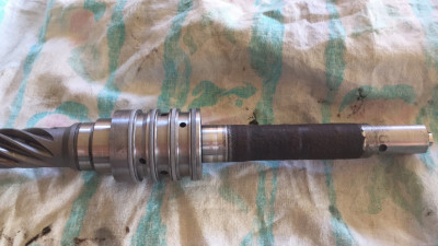

2) steering rack inspection
Steering rack 1/4
Steering rack 1/4
Steering rack 2/4
Steering rack 2/4
Steering rack 3/4
Steering rack 3/4
Steering rack 4/4
Steering rack 4/4
3) general thp engine care strategy, looks like really gotta baby this one..
Stay tuned on this bat channel for further updates tomorrow.

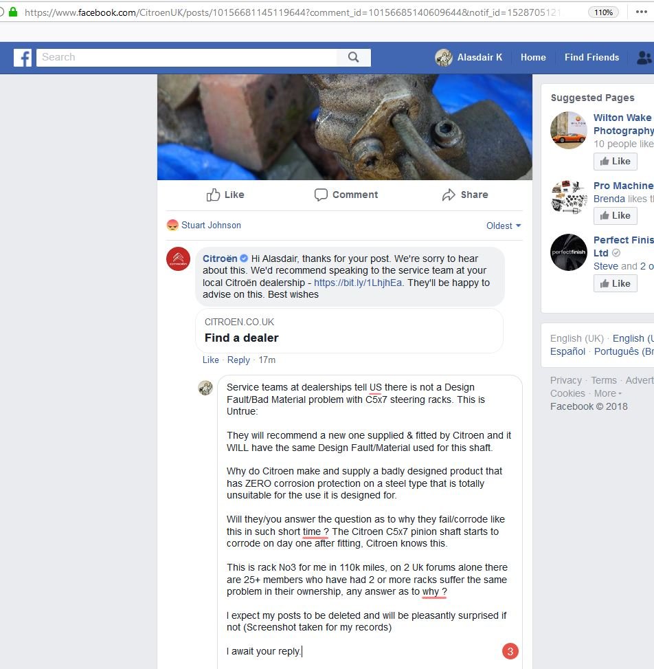

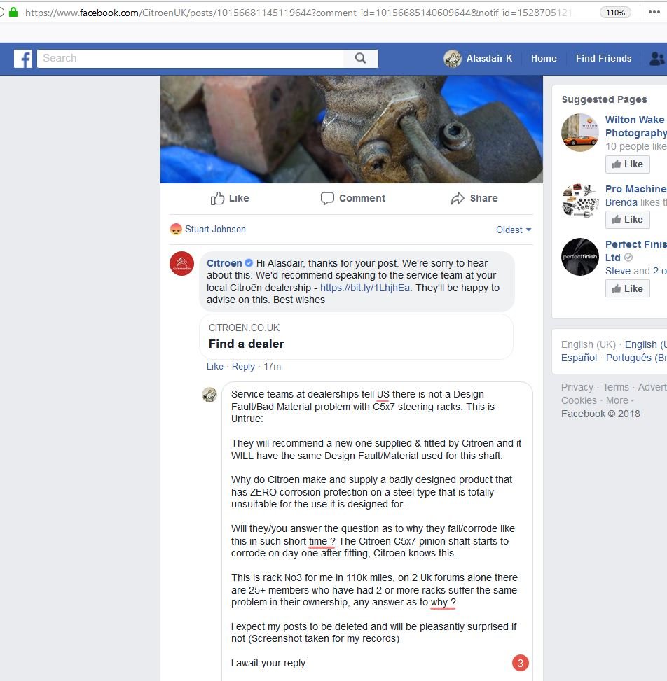

Bets taken on when they will delete it.
https://www.facebook.com/CitroenUK/post ... ed_comment
Feel free to wade in...BUT : PLEASE Keep it to if you have had a rack failure..No Rants please, keep it tidy chaps !

Surprised at Citroen's response................NOT
Citroën Hi Alasdair, thanks for coming back to us. It's difficult for us to predict the life of each part. But we'd expect any manufacturing defect to come to light within the first three years / 60,000 miles - whichever comes first. Outside of warranty we look to help with repairs - this is based on age, mileage, service & purchase history. For any technical advice, we'd recommend speaking with a trained technician at your local Citroën dealership.

Stickyfinger wrote: 11 Jun 2018, 11:04 Surprised at Citroen's response................NOT
Well, it's also clear that any social media manager will not have the authorization to admit to anything at all.
Esp. something that can potentially cost PSA tens of millions £/€ if not more.
Which is why oversight agencies need to get involved to force recall / safety compliance. This is bound to be a project. Crowdfunding, anyone...? Maybe cheaper than keep re-fitting broken racks :)

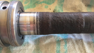

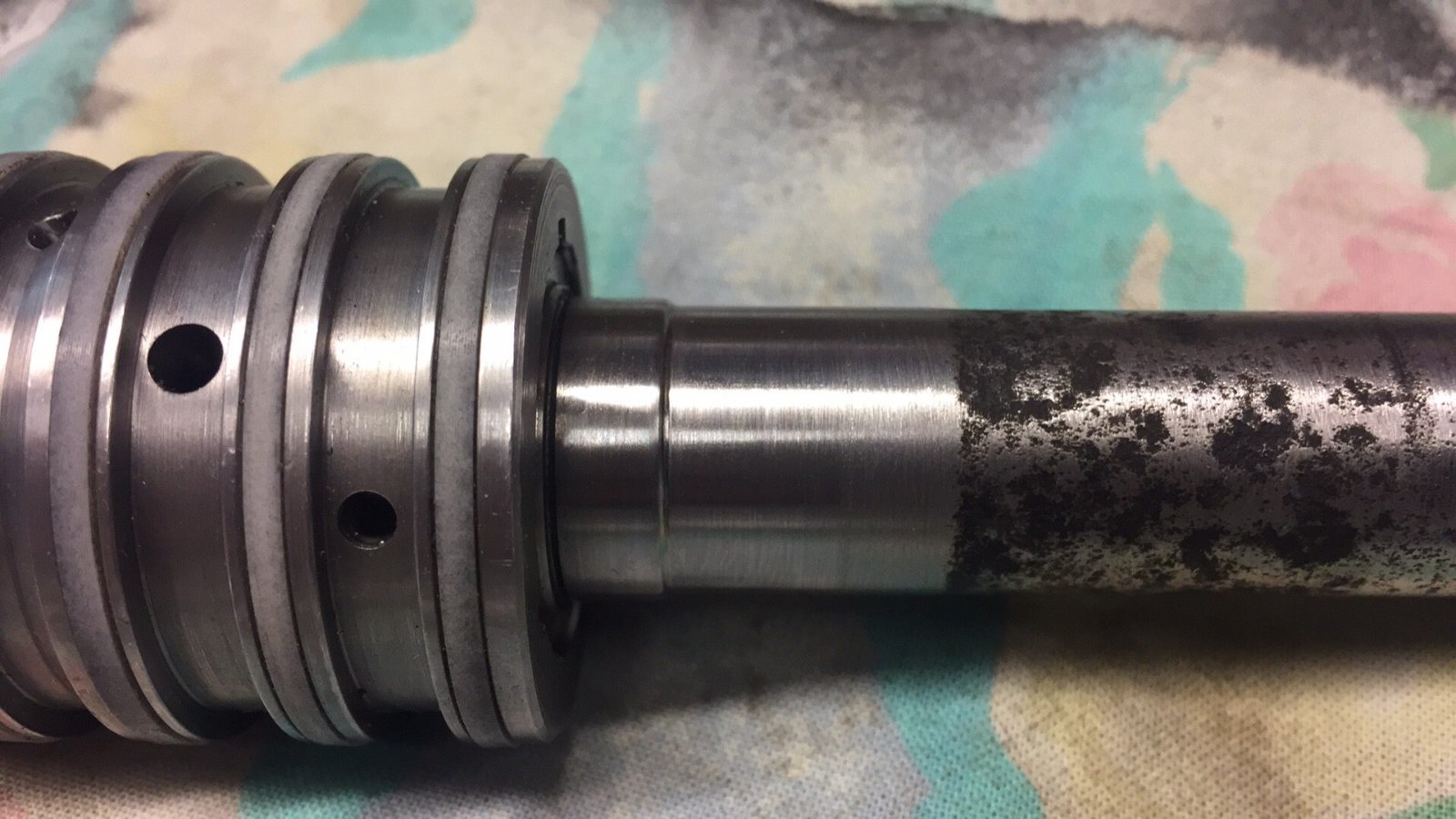

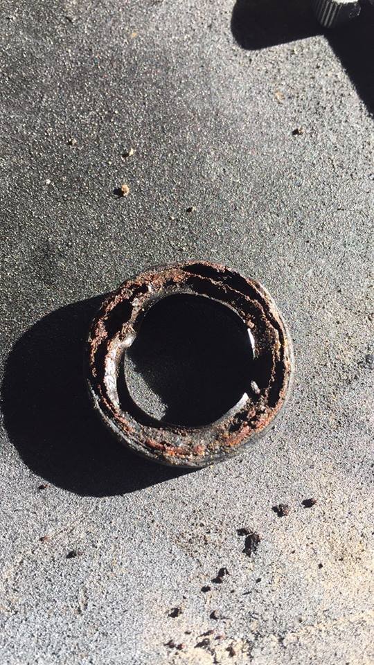

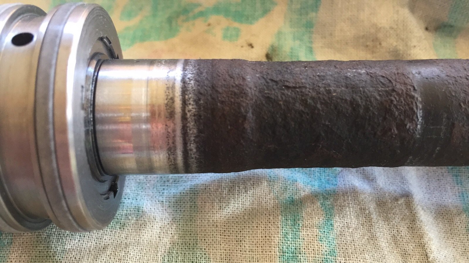

Another example posted on Facebook

Stickyfinger wrote: 11 Jun 2018, 15:18 35102774_10155404998042050_6990154631103905792_o.jpg35079474_10155405009367050_7769097244300541952_o.jpg
It would be helpful to provide a source for these images, to avoid possible confusion later.
