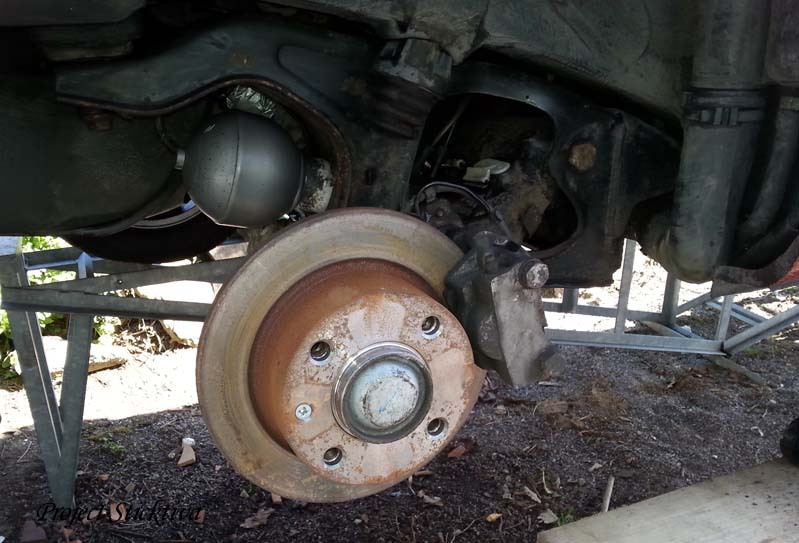

Updated Blog again
......did the rears today....more really amateur problems encountered but new discs and pads had been fitted recently.
BEFORE
AFTER
Can you spot what is missing ?..........so good to have a donor car within 20 steps, it has saved two trips/delays so far.
the original under-seal appears as slightly green, the darker areas are new stone-chip and a covering of wax-oil
GOD I LOVE THESE RAMPS !
BEFORE
AFTER

Stickyfinger Can you spot what is missing ?.
Bleed nipple & Dust Cap
and a wheel and tyre
