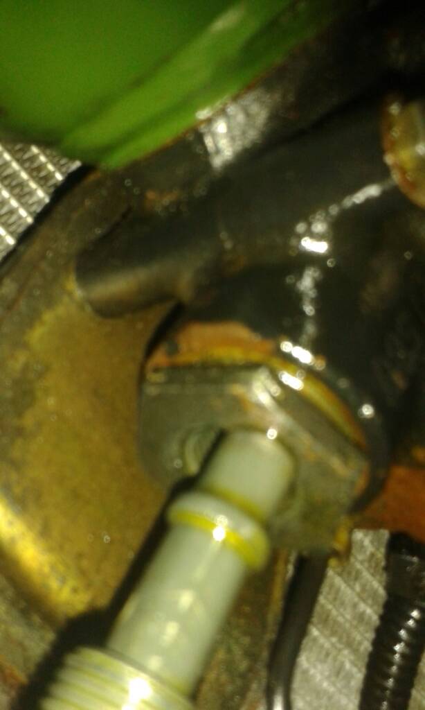

Yes everything was removed out of the way before we moved engine out. There was nothing left in there. As we did not want to damage anything. It seemed to leak from the middle where the pipe goes in through the 16mm nut, like it wasn't sealed properly.

That really does sound to me like a hairline crack in the pipe or else a crack in the union nut...
I've known them take a bit of shifting. Was it really tight? The very act of undoing the union could have caused the crack if it really took a bit of brute force to undo it...

Right then have made a possible break through with this leaking issue. Have spoken to a citroen specialist up the road, and yes Jim you are right there is no seal on the pipe as such. However he is 97% sure that there is a seal that seats inside the female part of the union. And this could of either fallen out or possibly perished. So will have a look up inside when i get a moment. He believes this would more than likely be the cause as the fluid poured out rather than just weeping, which he would expect from a hairline crack. So fingers, toes and everything else crossed.

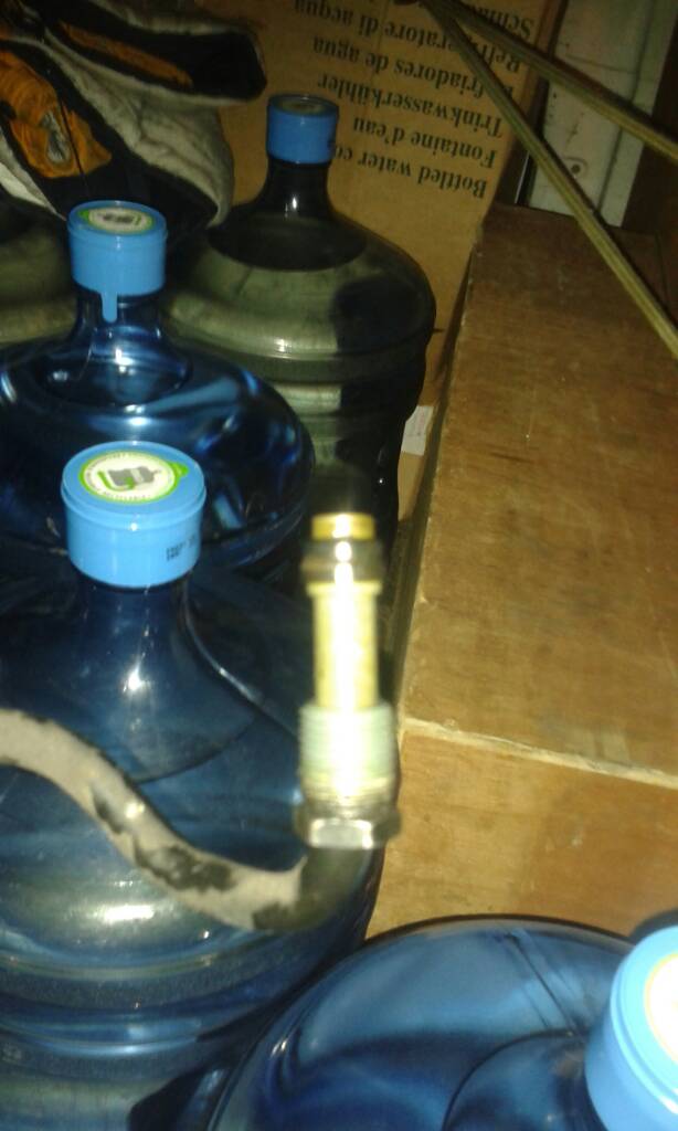

Okay so can anyone notice a difference here.
Old pipe.
New pipe.
Spot the difference.
Sent from my GT-I8200N using Tapatalk
Old pipe.
New pipe.

Yep, it has a metal seal on it...
