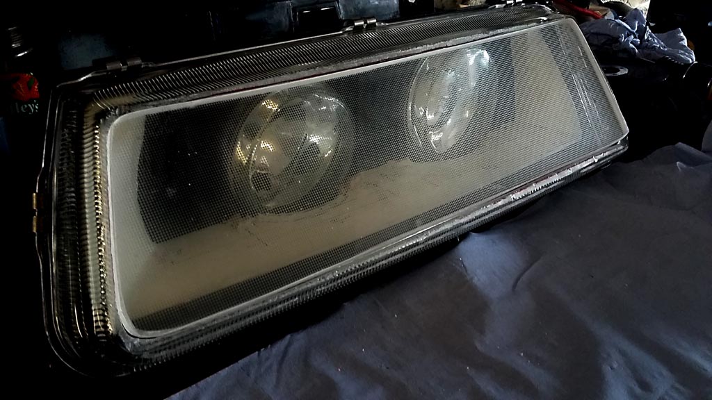

Got to find some decent clear plastic to experiment with nor, I have some 1cm thick....maybe overkill

Pop over, I've got sheets of the perfect stuff. I think I have 3mm and 6mm. Probably you can get it cheaper locally than you can drive here though. Shame, it'd be nice to see you.

Cheers mate.....cost wise I think you may be correct....as is I just need some to experiment on. I would thank you if you could stash a little bits to one side however.

I'll keep you what we have, it's offcuts from big sheets and I expect you'd get 2-3 lenses from them.
I'll measure tomorrow if I remember, maybe postage is cheaper than fuel and buying it yourself.
You've got my number haven't you? The new one? I'll text you now, if you text me something along the lines of headlight plastic at about 13:00 I won't forget. Otherwise, tomorrow, to me this conversation never took place.

Test fitting a replacement plexi-glass insert into the "glass frame"
This is a test using a scrap piece of plexi-glass that is way to thick and has a pattern on it.......the edges are rough atm as well. I am looking for a suitable sealant now that will be both strong and flexible, but will not yellow under intense UV light.
