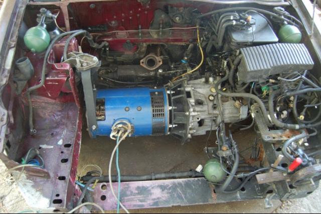

This is one from the scrapheap challenge phase of electric conversions lead acid batteries and fork lift truck motors etc which never quite get finished.c.morewood wrote: 20 Nov 2020, 20:51 Thanks Jim, I just have to find the £20-30 and drive it down to WalesI wonder if they'd fit cruise control?
- Posts: 54716
- x 8161
Re: Electric cars-Conversions
NewcastleFalcon wrote: 20 Nov 2020, 20:59This is one from the scrapheap challenge phase of electric conversions lead acid batteries and fork lift truck motors etc which never quite get finished.c.morewood wrote: 20 Nov 2020, 20:51 Thanks Jim, I just have to find the £20-30 and drive it down to WalesI wonder if they'd fit cruise control?
Shame it never got finished... They must have worked hard to make the adaptor to enable the original gearbox to be retained...
And how they've retained one original engine mount!
That exhaust is going to rattle badly unless they remove it

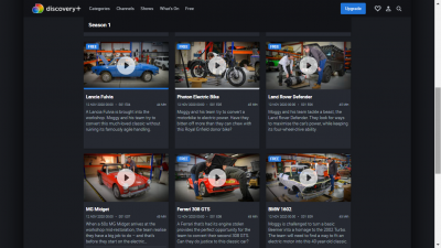

More from Vintage Voltage conversions currently available on Discovery plus.
https://www.discoveryplus.co.uk/show/vi ... seCode=212
Seeing as it was Lancia Fulvia day for me, just watched the episode on the Blue one. Not cheap of course, budget of £40,000 for the work.
