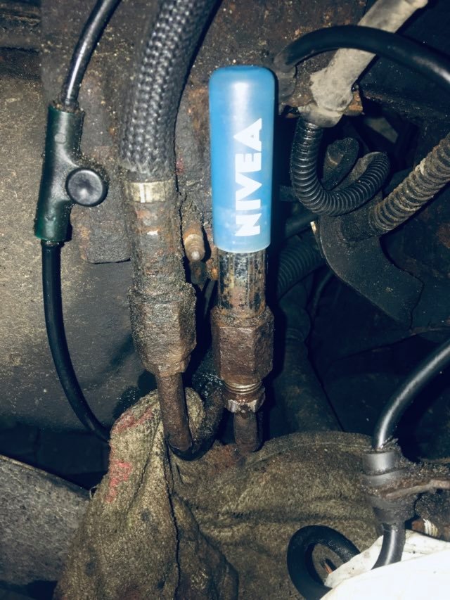

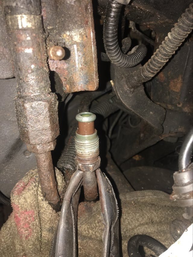

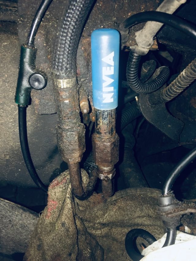

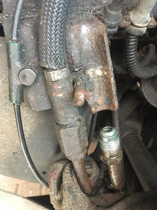

Some progress :roll: Fair to say that wasn't going to undo with the Ram hose connected :evil:
Skull's Ram pipe sawn off
Removed hose which allowed access to the formed pipe flare, which allowed penetrating fluid in from that end and also allowed a deep socket or ring spanner to fit a bit more securely than a pipe flare spanner
Skull's Ram Pipe removed
Finally loosened off
Skull's Ram Union loose
The more observant amongst you may have noticed that I had to hold the pipe that hard that it has flattened the pipe slightly :oops: (even though I protected the pipe with an old rubber inner tube) so I will try to remove that with a g-clamp to allow the union to slide further down and the pipe to be cleaned up properly .....

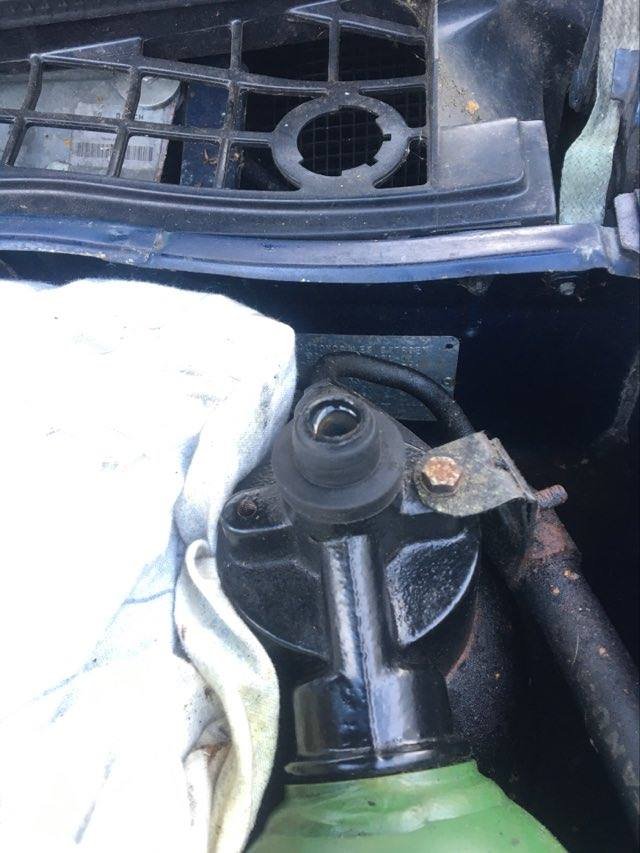

Skull wrote: 21 Dec 2020, 11:36 (SUSPENSION LEG GAITER also perishing)
Removed the lower strut leg from the hub, trying to disconnect as little as possible in the process. I'm now at the stage where the upper suspension strut should undo from the sphere unit but at the moment it's solid. I can't even rotate the upper strut with a long allen key, so I've made a 'bath' out of a rubber bung, around the seat to soak the head in plus gas overnight .....>>>
Skull's strut soaking &gt;&gt;&gt;
Skull's strut soaking >>>
Gary
Posts: 54668
x 8143
Re: My first Activa
It's certainly putting up a fight Skull :twisted:
Did the big (24mm IIRC) nut undo OK?
If so, the trick is to put the nut back on most of the way and then strike it hard with a soft-faced heavy hammer to 'break' the taper holding the strut pushrod in the strut top... Don't strike the top of the pushrod directly or you'll deform the threads and you'll then never get the nut back on again - reason for putting the nut back on most of the way...
Sorry if I'm teaching you to suck eggs here...
