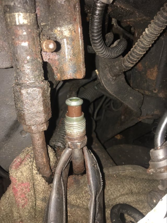

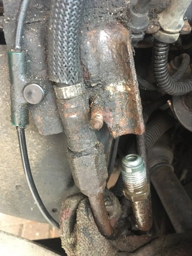

Some progress :roll: Fair to say that wasn't going to undo with the Ram hose connected :evil:
Skull's Ram pipe sawn off
Removed hose which allowed access to the formed pipe flare, which allowed penetrating fluid in from that end and also allowed a deep socket or ring spanner to fit a bit more securely than a pipe flare spanner
Skull's Ram Pipe removed
Finally loosened off
Skull's Ram Union loose
The more observant amongst you may have noticed that I had to hold the pipe that hard that it has flattened the pipe slightly :oops: (even though I protected the pipe with an old rubber inner tube) so I will try to remove that with a g-clamp to allow the union to slide further down and the pipe to be cleaned up properly .....
