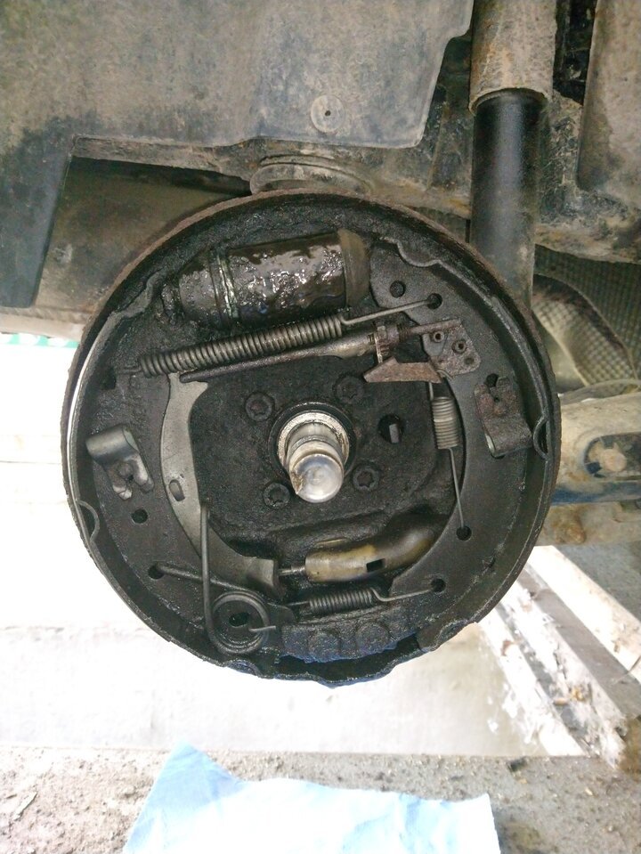

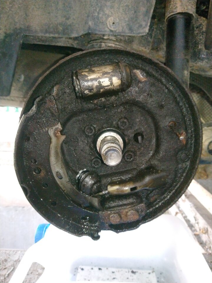

replaced the busted cylinder and tried to change the other one, but I swear the last person to change the brakes used the car's weight to torque the left nut, it's even got a broken.. lip? ring? the part that you have to hammer into the nook on the shaft. there's a section just gone. again, I forgot to take pictures, but I do have the before photos:
very rusted, the e-brake was almost seized.
the piston just *plopped* out...
my theory is that due to the severe rust, especially in the moving parts, the front half was seized so much, that the rear piston moved twice the distance it normally does, and pic related hapened.
now, the replacement part, while every retailer said it was a matching replacement weren't lying, they did omit that the mounting hole was in the wrong place and the brake line fitting recepticle OD was larger. so I ended up having to bore out the latter a couple mm and drill a hole in the former, a washer and some rtv should fix that in the meantime as it's basically a bean shaped hole now. I did consider rebuilding the old cylinder, but looking at the back of it, it was so corroded I deemed it a safety risk.

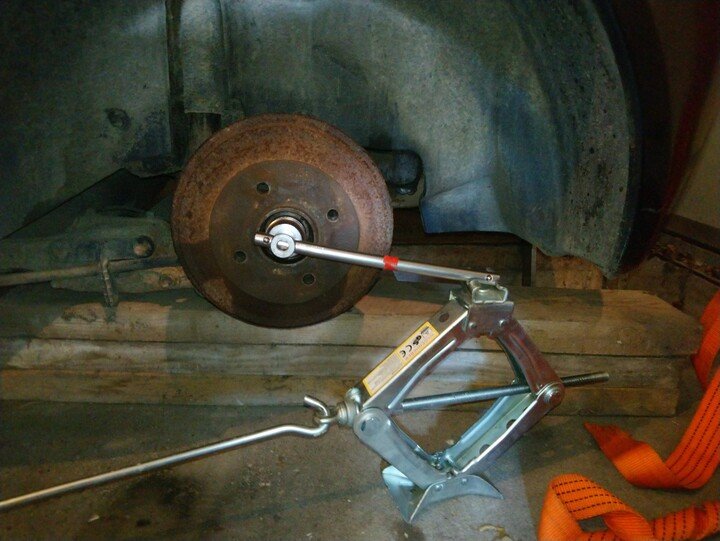

The hub nuts are replaced with new ones each time they are removed, a bit expensive though, so it does not matter about the bit that breaks off the lip. Before undoing the nut I have always tapped out the nut lip from the shaft cut out to make it easier to undo. They are done up tight, depending on drum size it was 300 Nm on our last C3 with 9 inch drums and 245 Nm on our Cactus with 8 inch drums. To undo has needed a long bar on the socket wrench.

Should be replaced! Most...er...people, swap the left and the right nuts giving them a new spot to deform. OR, just tighten it further to get a new spot.
Then the hub nut manufactures make the wall of the retainer so thick that you need a sledge hammer to deform it into the recess!!
Then some gorilla smashes the wall all the way down into the recess and you can not get anything between the recess and the wall of the nut!!
And then 8 pound for each nut!!! Give me a break!
At least they have a one piece bearing. The old 3 piece conical bearings needed to be preloaded using the hub nut before they were staked.

well, yeah I know you're supposed to change 'em every time you remove them, I just don't have them on hand atm and the brakes will soon need changing so a temporary measure it is.
also the left nut is just torqued way beyond the german guten-tight torque spec, I bent my wrench way outa whack, comically so! how bad of an idea would it be to strategically drill 2mm holes in the nut weaken it? the country's largest tool supplier (depo) only has torque wrenches rated for 210Nm, and I doubt a regulat 1/2" 90deg wrench won't get bent too.
I already tried heat and penetrating oil.

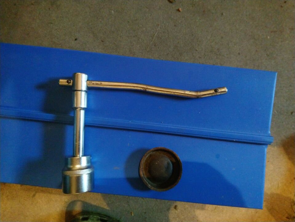

You don't need, or want, a torque wrench to undo the nut. You need what's called a breaker bar. 1/2" drive is probably the most useful although 3/8"(why?), 3/4" and even 1" drives are also available. You obviously then need suitable sockets or adapters.
I have two breaker bars in my tool armoury. One is 37 cm long and the other 60 cm long. And if the 60 cm bar won't shift the nut (I'm looking at you front drive shaft nuts!) then I have a 3-1/2 ft length of gas pipe to slip over the 60 cm bar to give some extra heft. It hasn't failed me yet although my son-in-law managed to bend the pipe once somehow.

I'm not condoning this practice by the way.ozvtr wrote: 05 Jun 2026, 23:54 Most...er...people, swap the left and the right nuts giving them a new spot to deform. OR, just tighten it further to get a new spot.
If you cut a hole in the end of a hydraulic jack handle, the jack handle will fit over the braker bar handle, giving you an extension.
Only buy tools stamped "Chrome Vanadium". There are a lot of tools made of cheese!

R8 my setup: the tool suplier didn't have a breakerbar so I got whatever that in the picture is called. needed a good bashing with a hammer on the short side, but finaly got it off! too bad the bearing's stuck to the shaft and the drum to the bearing!! nothin' I did got it moving any better - hamer, penetrating lube, fire! eh, whatever, if the other cylinder fails I'll deal with it then...

My C2 has the 1.6i engine, so it has disc brakes on the rear. But my C3s have 1.4i engines and have drum brakes on the rear. The bearings must be @#$% because the rear hub nuts on all the C3s have been disturbed. The C3s are second hand but I have owned the C2 from brand new.

even when she was pulling to the right after I rebuilt the brake, and the occasional squeal of the brakes (I'm guessing here, I think the self adjuster is too loose now) I panic over and stop for, ony to be a-ok as I start driving again.

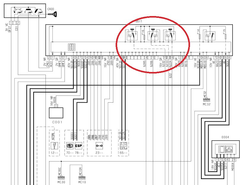

so going back to the locking issue, I can lock but not unlock the car via remote, (neither by key, but who's counting)
I did as much debugging as my expertiese permits and came to the conclusion that it's further up the wires, everything's fine in the BSI, and the only connection I found that controlled the relay was pin 15 of IIRC the black connector, or the gray one.
so since I'm done debugging that part, and I can unlock the doors by just powering the relay, I ordered a learning code 2 channel relay board and two remotes to mod into the BSI (I'm the car's last owner 'till death do us part), that way I have two remotes to lock and unlock the car, and it sould only cost me ~10 eurobucks

Re: Don'tShine's Citroen C2 project car thread

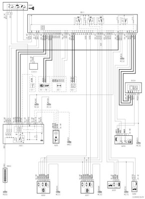

Here is the over all circuit of the central locking.
Here is a close up of the connections at the BSI.
The connector is the 16pin grey connector (16V GR)
The modes are; lock, dead lock and unlock. BUT it's a multiplexing of the the three relays to get those three modes, NOT individual relays!!!!
Unfortunately I can't tell you what's what.
I believe the left most solenoid determines lock or unlock. The two on the right determine if it's just lock or dead lock. But I'm not sure.
yeah I noticed the relays are interlinked (multiplexed) I was just going to tap them with an RF relay, since I can lock and unlock the doors by sending voltage into the right relay, I see no reason I couldn't do it over the air.
I'll try to mock up a readable schematic later today, the OEM ones are just bizzare, why are the relay coils connected on the same rail? and why is COM connected to the signal pins? on the board itself COM is connected to the 12V power rail and the coil is connected to the signal pin.
I now realise it denotes "this stuff is here, but you shouldn't care about it" as in the coils are controlled by the circuits inside the box, it's just weirdly marked (to my sensibilities anyway) why are all the schematics so blurry and compressed?
on an as-close-as-I-can-manage look, sending power to pin 15 unlocks the door and sending power to pin 13,16 locks them (via actuating the relay, of course), so thanks for the schematic, saved me ~hour reverse engineering the BSI
ozvtr
- Posts: 850
- Joined: 13 Oct 2020, 01:11
- x 234
Yes. Either 13 or 16 is the dead lock feature. This disconnects the inner AND outer door handles. The other pin just disconnects the outer handle.TheSunWhereDontShine wrote: 19 Jun 2026, 11:51 on an as-close-as-I-can-manage look, sending power to pin 15 unlocks the door and sending power to pin 13,16 locks them (via actuating the relay, of course)
