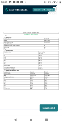

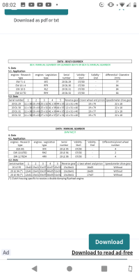

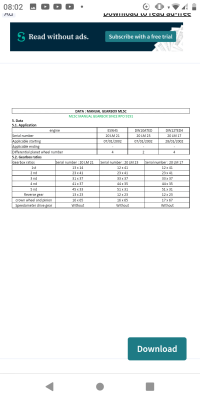

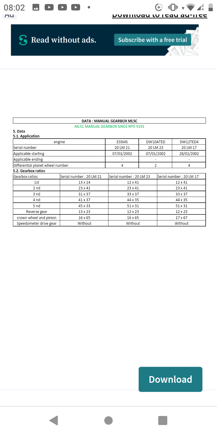

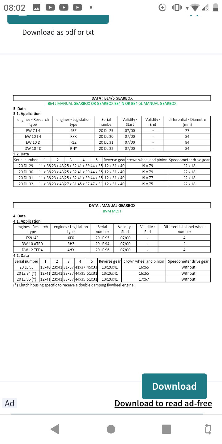

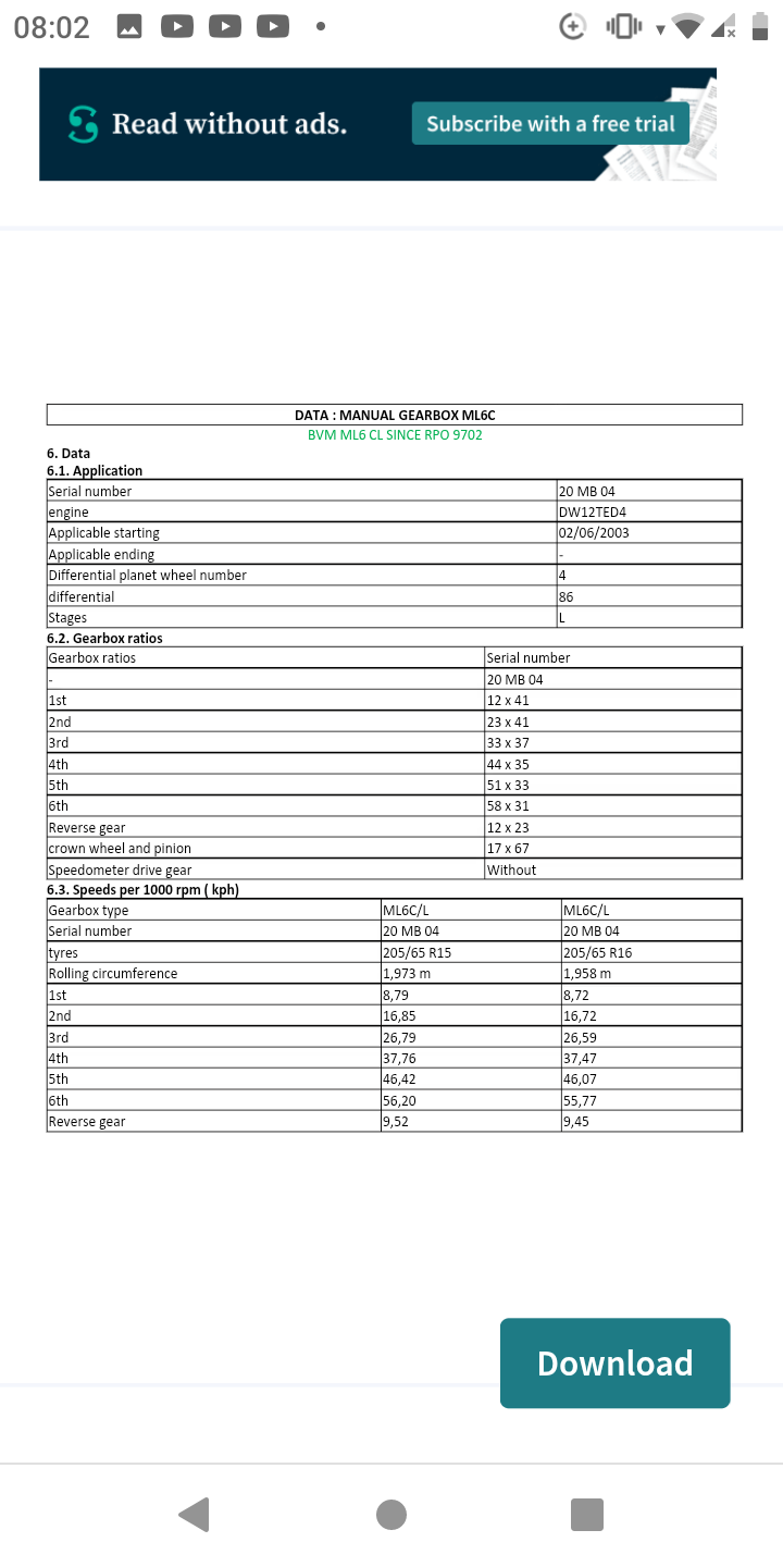

DW10TD RHY 2.0 90
Citroen C5 2003
could someone help me find a gearbox number and ratios please?
2003 C5 LX 2.0 hdi 90 RHY

for Citroen C5 :
