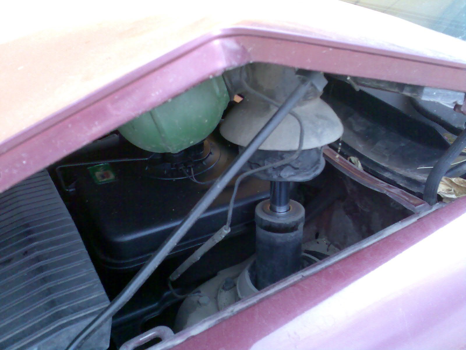

Drive REALLY gently (or trailer) if the front spheres are flat (= lumpy ride), and take any humps at half-walking-pace.
Flat spheres + a bump can tear out a front strut top, and spear it through the bonnet.
Hundreds of Xantias here have been 'written off' like this, when owners kept on driving them.

I drove it back from Gloucester like this (240 mile!) very gingerly
It has had that happen to it already looking at the bonnet and from what the garage told me so I think the strut tops are new.

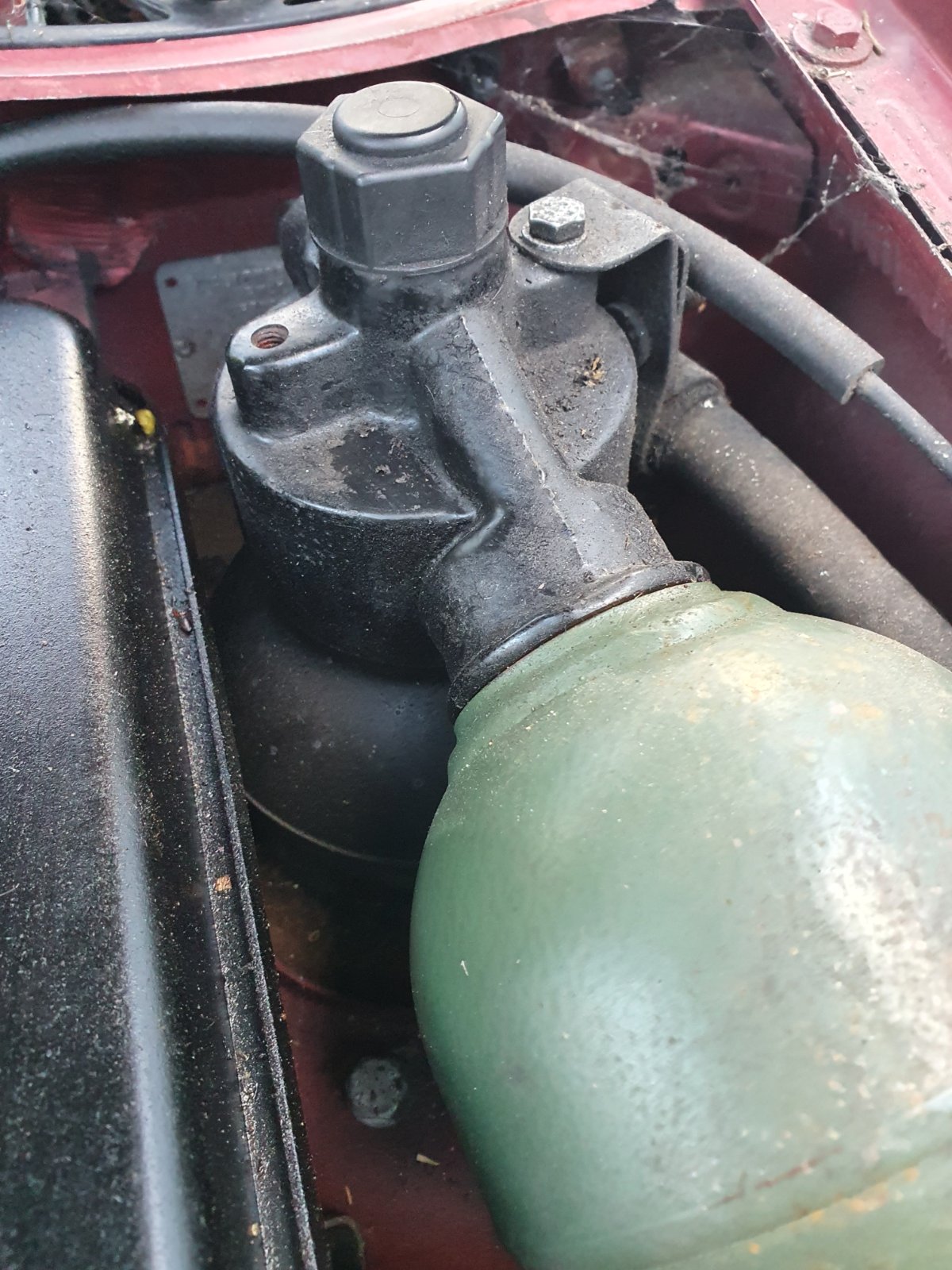

If you can post a photo of the strut tops (top-side) we should be able to tell whether they are new items, or Elastomer-rebuilt. Either should be good.

I may have a set of good strut tops in my stash should you need some

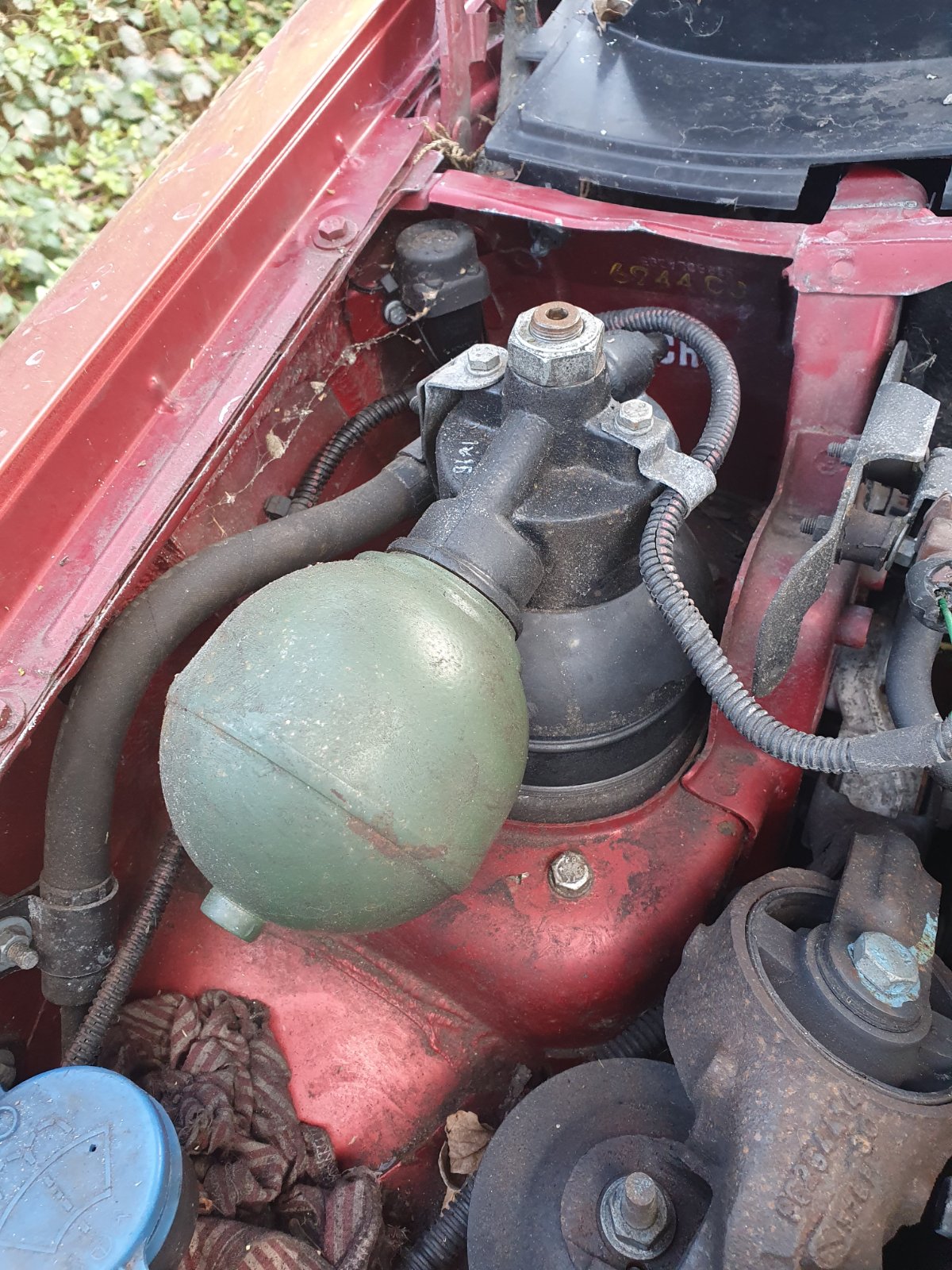

That's the strut tops, the passenger side sphere is dated 2016, do they go flat so quickly? It's hardly done any miles since then!

Re: Activa procured!
Those are original strut tops, not 're-rubbered' service-exchange ones from Elastomer.eu.
Look to be in good condition, but the real check on condition is the underside — in particular whether the rubber coating Citroen applied to the base-plates (they did this on Xantia, but not XM) has started to peel away, which allows the base-plate to rust, unseen.* (Apologies for that over-long sentence.)
The classic green/grey round spheres should be good for gas pressure for 3 years minimum from new, but beyond that gas pressure ought to be checked at the first signs of lumpy/knobbly ride, and certainly at 5 years.

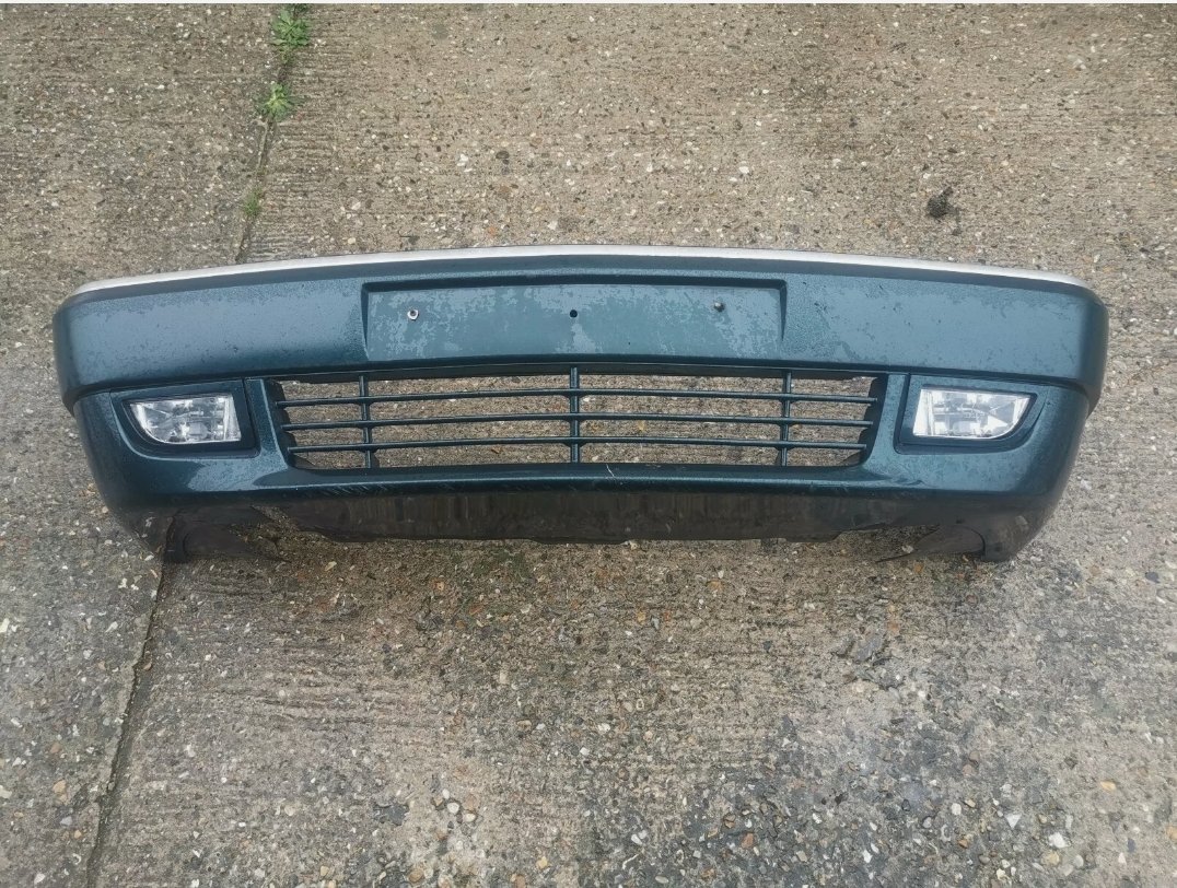

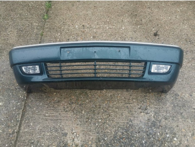

I have a proper Activa Bumper (in green
