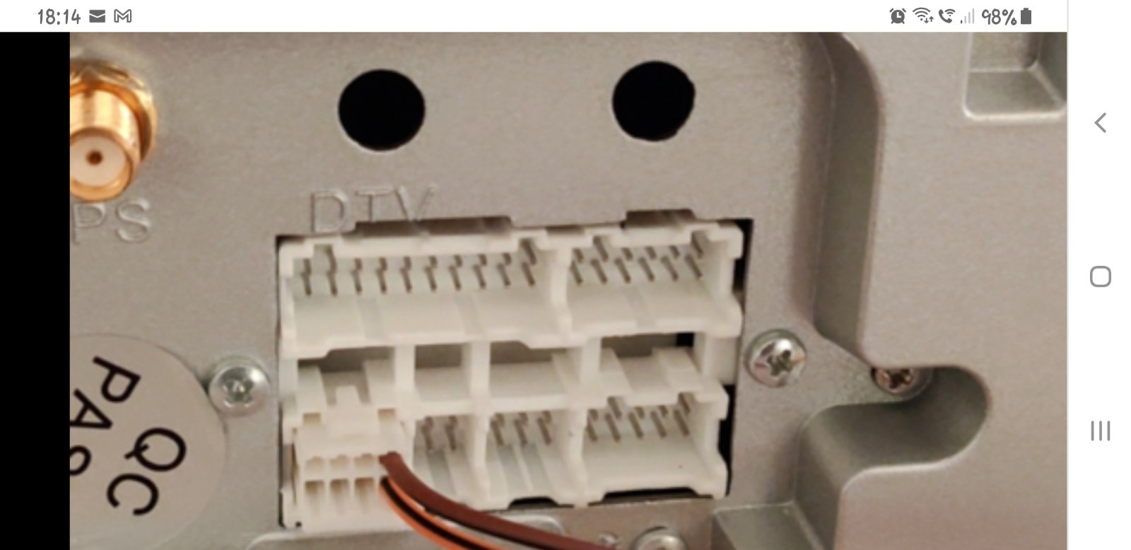

I'm trying to attach an image of the rear of the new unit, don't know how Marc

I have sent the image.

Congratulations on posting your image, however it is about as much use as a chocolate teapot!
It's no bigger than a postage stamp, so I don't know where you got the picture from, but I suspect it is a thumbnail image so is no good magnified up, hence I can't see anything. Try getting a proper sized image and then saving that and then uploading it.

Thanks Marc! Sorry mate, First image upload hence the thumbnail shot
. Hopefully Ibcan get it right next time. Cheers for all the info!

There's nothing I can help you with there as this is not a PSA unit and therefore I can't tell you what any of their connections are or what the wires they have shown in their unit are from or go to. There are no pinouts with descriptions of their wiring, so nothing I can do. I suggest you contact the sellers and ask them to provide you with a proper wiring diagram at the very least.
