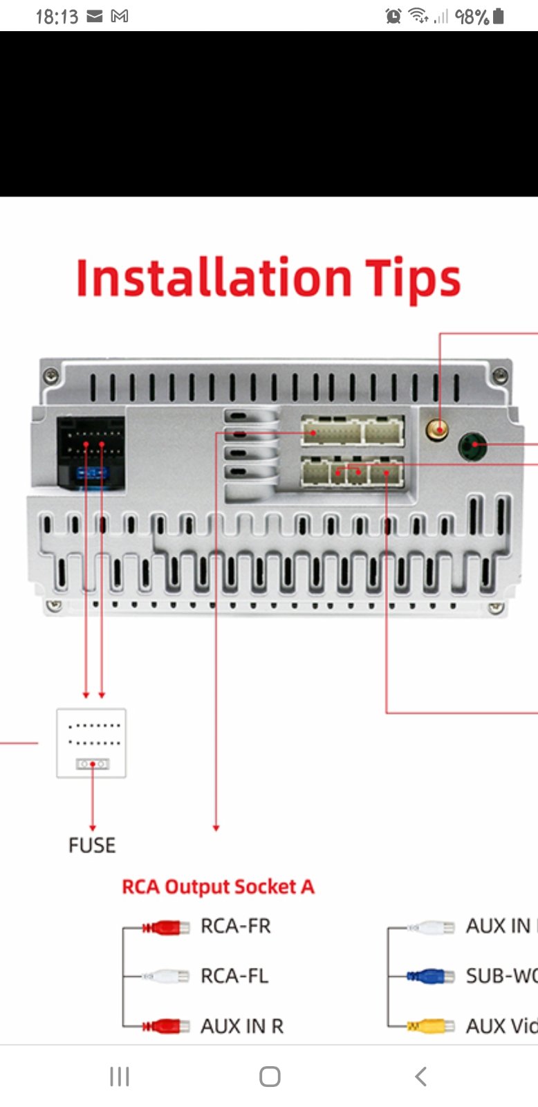

I'm trying to attach an image of the rear of the new unit, don't know how Marc :(

Do you happen to know where the built in Bluetooth hands free microphone might be located in the 2010 Peugeot 3008 1.6hdi Exclusive and where the mic lead ends up in the dash?
I have sent the image.
Thanks Mat
Posts: 37659
x 5789
Re: Peugeot 3008 2010 MyWay RNEG issues
Post by GiveMeABreak »
Congratulations on posting your image, however it is about as much use as a chocolate teapot! :-D It's no bigger than a postage stamp, so I don't know where you got the picture from, but I suspect it is a thumbnail image so is no good magnified up, hence I can't see anything. Try getting a proper sized image and then saving that and then uploading it.
As for the microphone, this is where you are likely to run into problems.
PSA microphones are integrated into the centre roof console. However, the wiring from the microphone often ends up going into a ribbon connection and disappearing into the loom and is very hard to find the routing. Many people have given up and simply wired their own microphone into the head unit for this reason.

Thanks Marc! Sorry mate, First image upload hence the thumbnail shot :lol: . Hopefully Ibcan get it right next time. Cheers for all the info!

Second try Marc, see how things pan out.

Hi Marc, need a littler help with radio issue, So having installed the unit, however in testing stage FM tuner working fine having no issues but AM tuner not tuning into anything whether manually or on auto search. Don't understand, maybe you can give some insight please.
Thank You
Posts: 37659
x 5789
Hi
There's nothing I can help you with there as this is not a PSA unit and therefore I can't tell you what any of their connections are or what the wires they have shown in their unit are from or go to. There are no pinouts with descriptions of their wiring, so nothing I can do. I suggest you contact the sellers and ask them to provide you with a proper wiring diagram at the very least.
