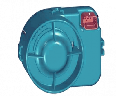

The alarm has a separate siren isolated from the other systems Mick.
The siren carries out diagnostics on its connection with the alarm unit and on its permanent supply.
If the siren detects a malfunction, the siren is triggered.
It depends on your options as to what you have fitted of course.
